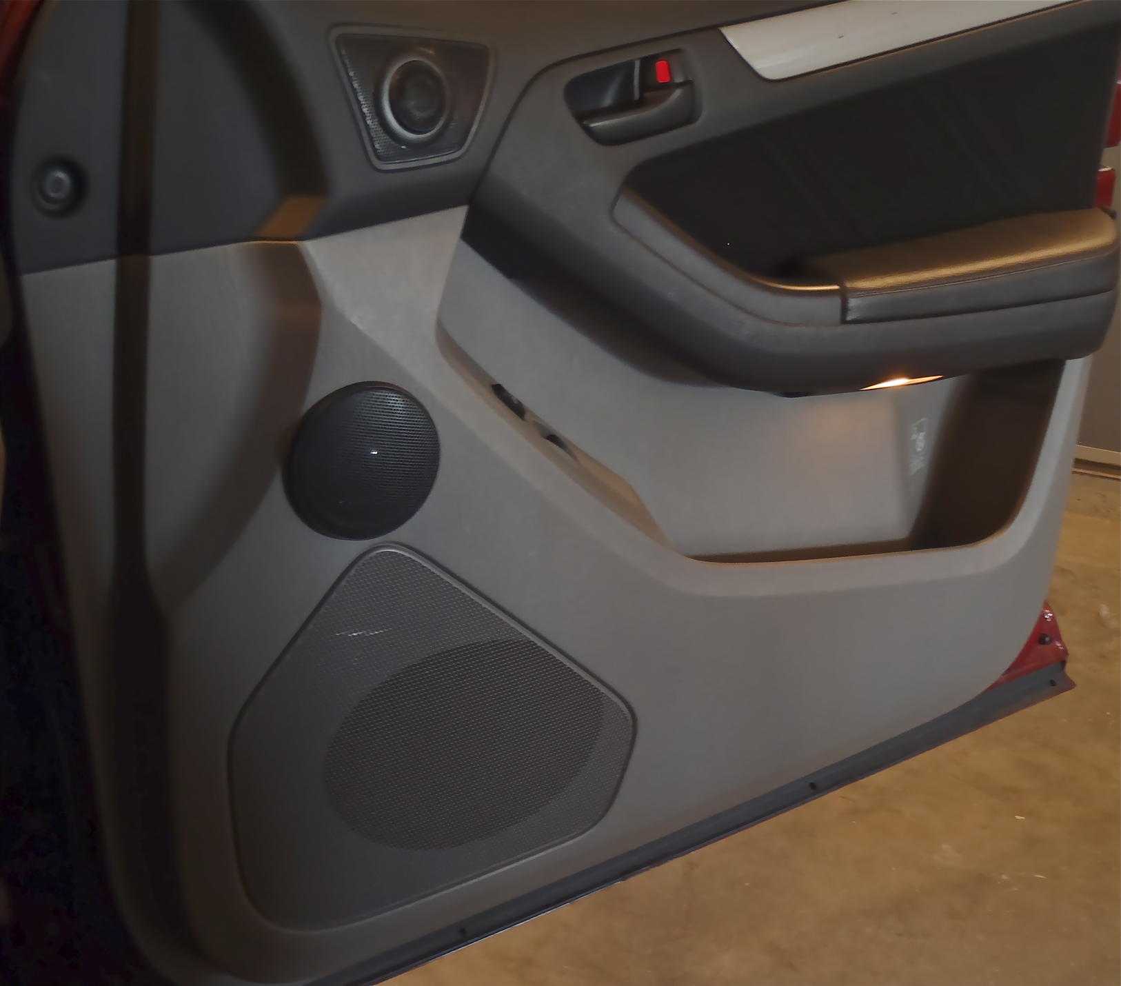

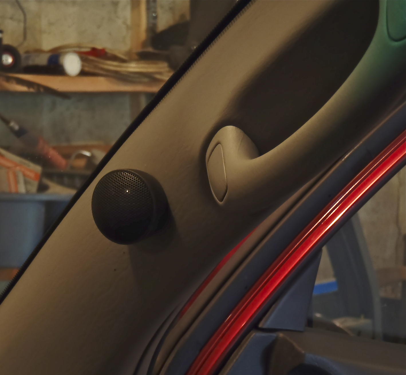

Here is how I positioned the components of the 3-way I just installed. (ignore the tweeter mounted in the OEM upper door grill) I positioned the midrange where you see it just above the grille for the main door speaker. There is a flat space here that allows mounting of a 3" speaker and there is room on the back side of the door panel to allow this. I backed the speaker with a ring of 3/4" MDF to solidify the mount. I mounted the tweeter in the front pillar which was a very easy install. It is farther than recommended from the woofer and mid but since my head unit has adjustable time correction, I can create a very nice sound stage.
Midrange door mount
Tweeter on passenger front pillar:

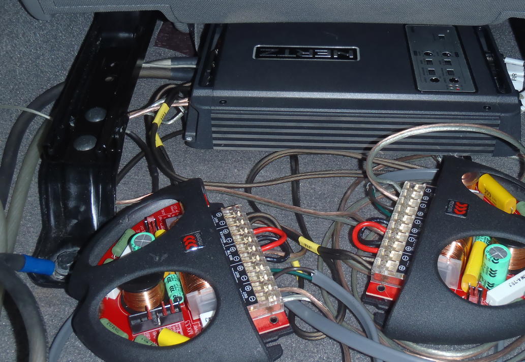

Amp and cross-overs beneath passenger seat: (I know, its an unholy mess but this is just set-up and test state before final clean-up) Note the ground using the rear seat bolt. (need to sand, clean and thoroughly expose bright metal on bolt, seat frame and chassis to assure excellent ground)

lift the seat off the carpet, and lift the carpet up, u will see a ground point, its where the wires from the seat is grounded at, use that instead. also that 3 way mount is a lil bad, i would fierglass the midrange on the a pillar, cant mount the mid on the door like that, on the driver side, that mid is being block by the steering. i think u need more power to the speakers, i have a rf 600-2 thats making 248w per channel, driving focal 165k2p.
