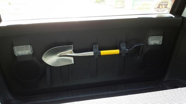

Hello everyone just purchased a mixed pack a quick fist mounts. I'm wondering where people mounted theirs. I am going to use the large for a fire extinguisher two mediums for a shovel and a mag light. The small should fit my camp ax/ hatchet. Also how are you getting the washer and nut behind the panel.

Rear panel. Pop as much of the panel as you need to access area, check behind to be sure there is clearance, drill hole, mount quick fist, done. I used #10 bolt and oversized washer.
deerunner-albums-deerunner+4r+photos-picture33000-used-quickfist-mounts-rear-hatch-hold-small-shovel.jpg
