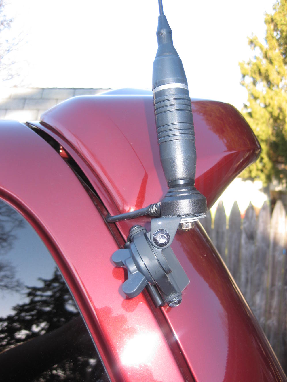

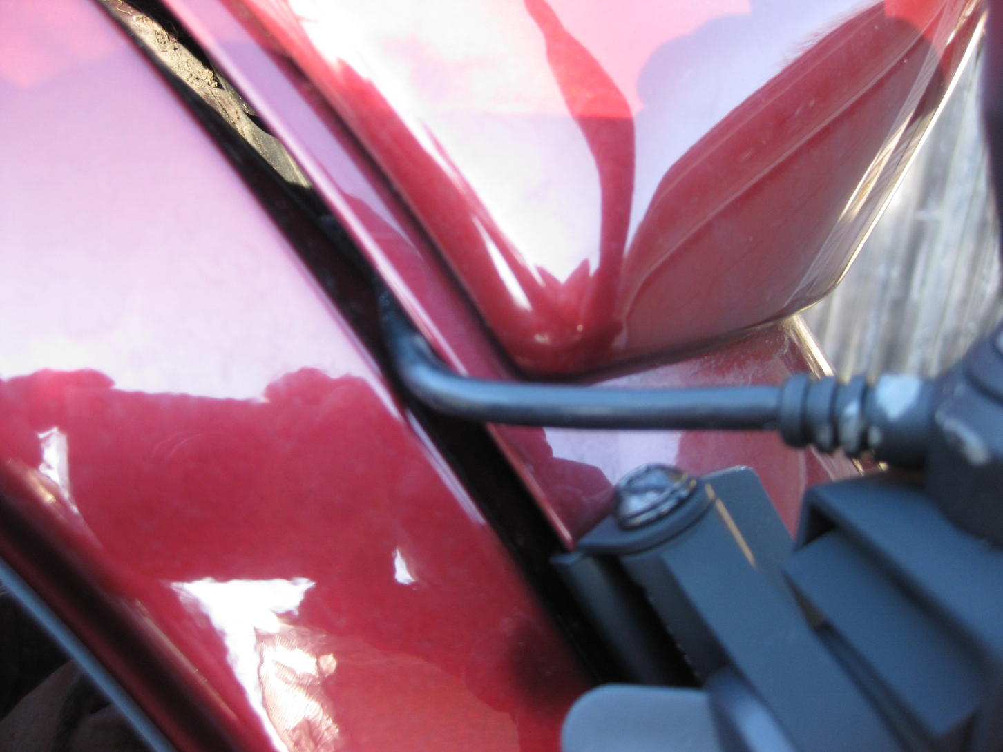

i wanted something temporary also,got the same ant but the magnet scratches the paint on roof after awhile, so i used a different mount. theres enough space so no crimped wire & only place it gets a very slight flat spot is at the rubber, but theres no wear & it still works well.
