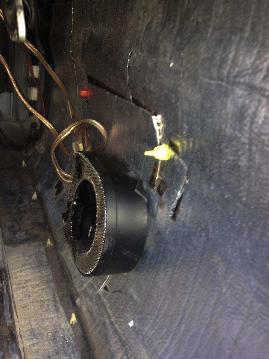

Where & how did you mount your front crossovers?
Like this ...

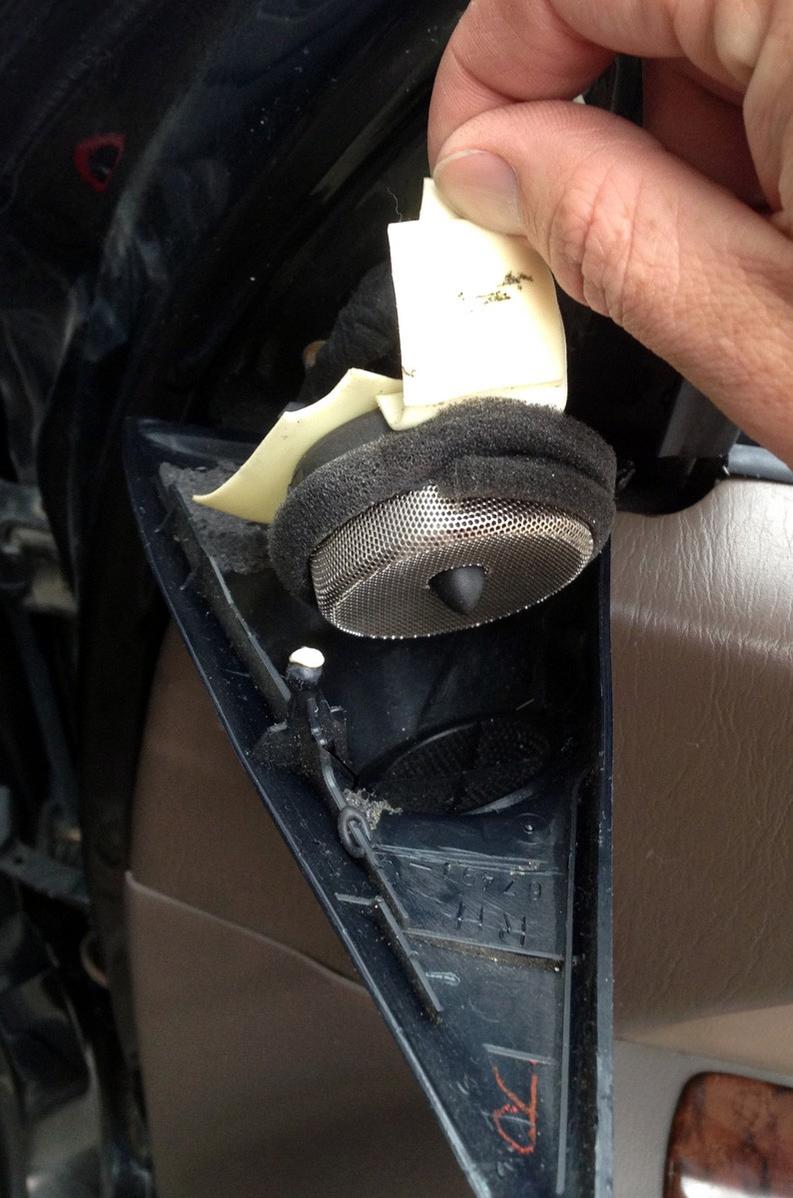

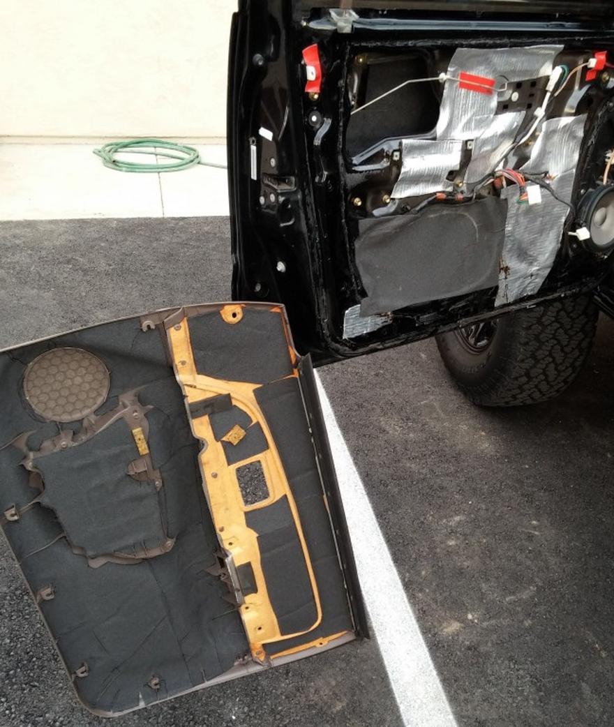

Sure. I get it. My setup is 100% stock looking. The 6.5" components are in the door with the factory door panel. The tweeters are in the door underneath the factory limited tweeter cover as pictured.
