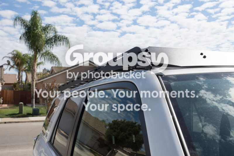

Since you are on the subject, dont forget about prinsu. I have compared mine to gobi and it seems to be maybe a little lower profile. I think it sits closer to the roof but I couldnt be sure. Not to mention it is 100% aluminum and weighs next to nothing.
does the rack require drill?
Officially, yes... but I didn't drill for mine. I used rubber cabinet feet like several others have used. They sit perfectly in the rain channel on top of the plastic gutter.
But if I was to do it all over again, I'd go with SSO's slimline rack. It does not require drilling, and they seem to have way better quality control. I can vouch for the fact that Prinsu is a crap-shoot in this regard. You never know what you'll get wrong from that bunch.
Prinsu and SSO make flat full rack options that cost a lot less than GOBI. I went with the Prinsu 7/8 option, which is no-drill. Lot's of folks running RTTs on them, especially on the Tacomas.
