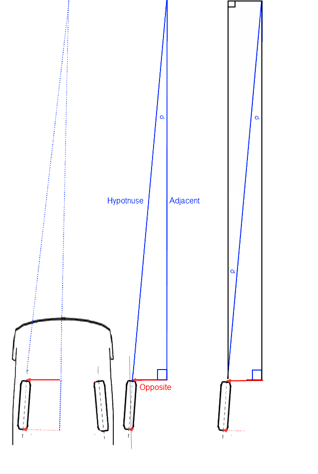

OK, you need to forget the Triangle
I think I will give up on the triangles but in my defense, I must say I wouldn't even think of measuring toe as triangles except that the damn spec is in degrees!
229984d1481377751-measuring-toe-home-what-triangle-does-toyota-angular-toe-specs-indicate-toyota_toe_trig_angle2.gif
Build a tire scribe and set the toe 1/16" shorter in the front than the back.
I watched a bunch of videos for how to measure toe which pretty much used a toe plate and tape measure so I'm going to try that method of measuring linear distance (and not angular degrees).
As you noted, toe is really just a smidge positive, so what you're saying is that I can set the toe to zero and then bring the front of the tire tread in about 1/16th inch with respect to the rear of the tire tread (measured as close to the centerline of the wheel as I can get).
1/16th inch on each side will give me a total toe in for the front axle of about 1/8th inch.
If that's the spec for this SUV, then I'm fine with that.

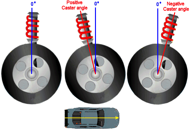

Caster is extremely hard to adjust without some sort of slip plate. Going to take a lot of trial and error to get it right. Will have to roll the truck back and forth after each adjustment to relax the suspension. Check the graph in the pdf which will show you how to set the gradients on the cams to get the appropriate angles. Just an FYI, on our trucks, caster and camber are set simultaneously.
Caster can be measured indirectly by measuring camber change as the wheels are steered a known amount (usually 20 degrees) left and right. So, assuming you're measuring the driver's side wheel, here's the process.
- turn wheels 20 degrees right
- measure camber - call that angle A
- turn wheels 20 degrees left
- measure camber again - call that angle B.
- caster = (B-A)*1.5
So, for example, if angle A = -.5 degree and angle B = +1 degree, then
caster = (1 - (-.5))*1.5=(1+.5)*1.5 = 2.25 degrees.
Keep in mind that, if your back wheels are higher or lower than the fronts, that will affect the apparent caster measurement by the amount of front-back slope in degrees. You just need to add or subtract that value from the computed value above.

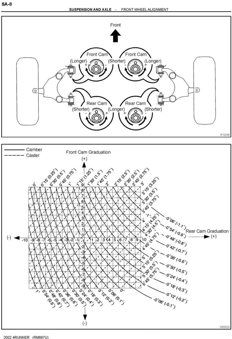

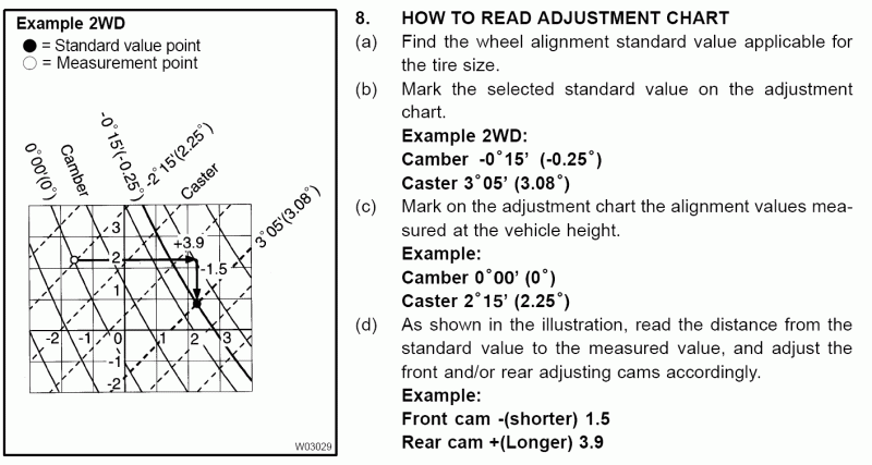

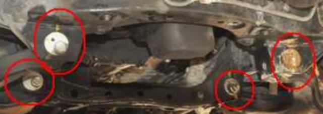

Thanks for that information that caster/camber are set at the same time and for that graph where you put the desired point and what you currently have and then adjust in the direction the graph tells you.
One question, born out of ignorance of the actual process, since there are four adjustment bolts, two for each side, is whether they're done simultaneously or one at a time? (The PDF says "adjust one and/or the other accordingly" so I'm just asking what that means, in practice.)

Thanks for that hint because, as you said, camber will be relatively easy to measure with a level that is accurate to 1/10th of a degree (six minutes).
Then with that chart above, we know which way to turn the eccentric bolt.
I'm just curious since nobody mentioned the markings on the bolts which seem to be in degrees of some sort.
Why do these plates have those markings on them (are the markings useful to us)?
The markings on the cam bolts refer to the divisions on the graphs in the FSM. Once you figure out how much you need to adjust camber and caster, then go to the graph and it will tell you (if you read it properly, not trivial), how many marks to rotate each cam bolt. For caster and camber, the wheels are independent, so adjust the two cam bolts on the driver's side, and then move to the passenger side.

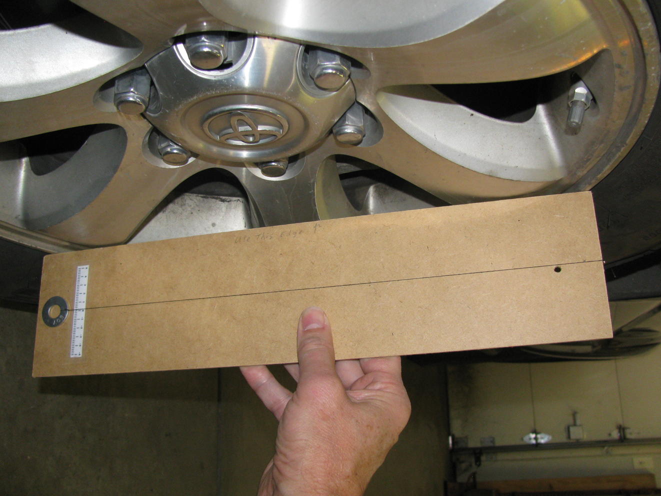

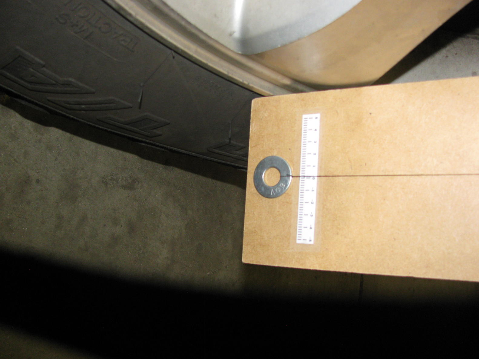

As far as the vertical angle scale, I made a board out of masonite with a straight edge that will fit against the rim (approx. 16" long). Then attach a string and weight to the top, and paste a carefully calculated angle scale on the bottom. Here's a picture. Just lay the long edge against the wheel and read the camber angle on the scale.
Here are some pics. Later when I have more time I can post the formula for making the angle scale. (Sorry about the rotated pictures. I don't know offhand how to fix that.)
As an FYI, the picture shows a camber angle of about -.1 degrees. (Leaning in at the top of the wheel). Each minor tick on the scale is .2 deg.
Thanks for that clarification because I must admit I'm not clear on how the chart works yet with respect to the adjustment marks on the eccentric plates (if that's what they're called) but when I start doing the measurements and trying to adjust things, I think it will become more clear to me so I don't have questions yet (since I have to study the chart more first).
I found some more specs by googling, which have an expanded chart as can be seen below for 4Runner.
The cam marks are easy. But yes the chart can be challenging. The axis are obviously rear cam and front cam. The cams have 20 gradients. The center is 0. When you turn the cams outward toward the wheel, you are shortening the LCA which is making it negative, vice versa positive. So say you turn both all the way to -10, (both 90 degrees towards the wheels) you plot that point and by looking at the solid line (camber) and broken line (caster), you end up with a little more than a degree of positive camber and about 2.75 degrees of caster.
Heh heh ... that's not so "obvious" but now it is, now that you mentioned it, that is! :)
Thanks. I have been concentrating on the wheel mounting and balancing, so it will be a week or two before I get to the alignment part of the job.
I'm sure that's when this chart will begin to make sense to me.
Right now I'm just lining up the ducks.
Thanks. I will keep that in mind when I need to "shorten" or "lengthen" the Lower Control Arm to change camber/caster.
Since measuring camber is easier than measuring caster, right now I'm looking up the formulas for calculating caster by measuring camber so that I get a "feel" for how that works (right now it's as clear as mud to me that you can calculate caster from a measured camber - but that's because I need to work on the basics).
That doesn't make sense to me yet, but it's because I need to think slowly about it when I'm doing it, so I'll have questions later - but I need to work on some of the basics offline on my own first.
