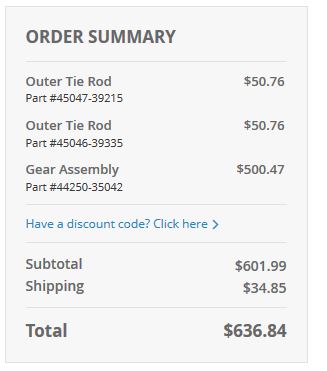

I bought steering rack, and both OEM outer tie rods. With shipping it was $631 for everything. So shipping was under $30. Still cheaper
