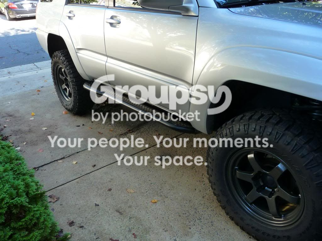

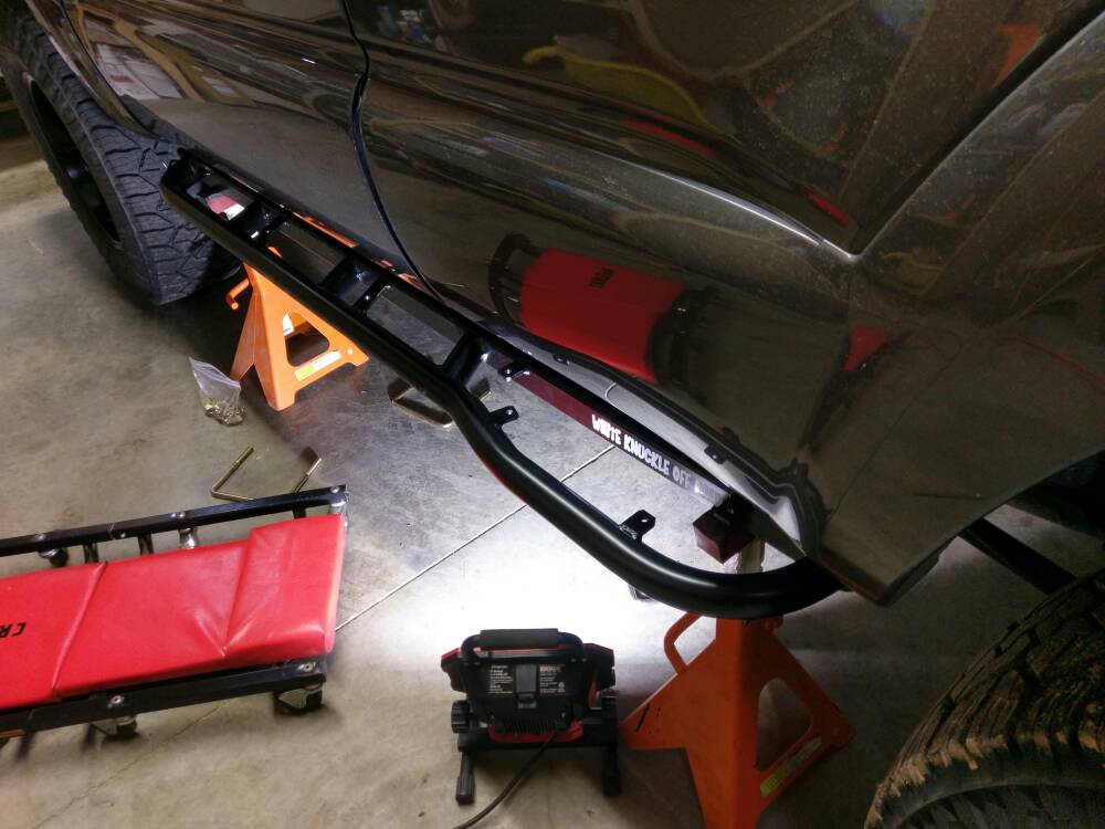

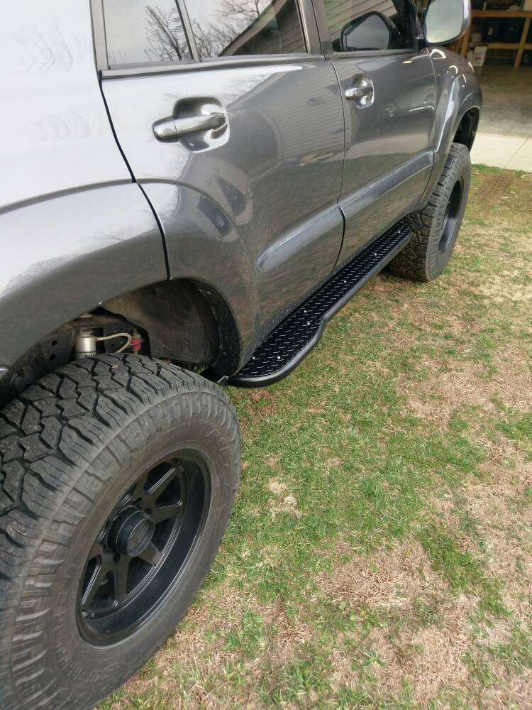

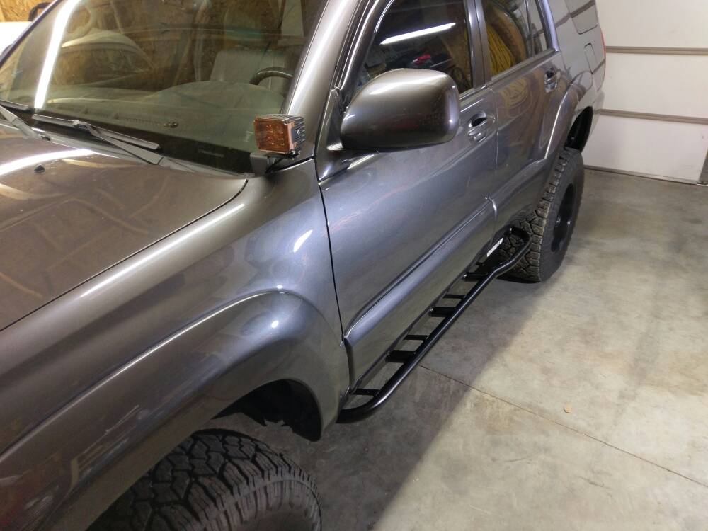

To reference earlier posts, I had John move the center mounting leg 3.5" rearward so that it would accomodate the RCI transfer case skid without modification. Finally following up with the pictures....better late than never.
The top plates are a great option btw. Not only do they make rooftop access easier but they're also great if you've had to remove the mudflaps. They keep a good bit of rocks, mud, snow, etc off the body while on the trails.

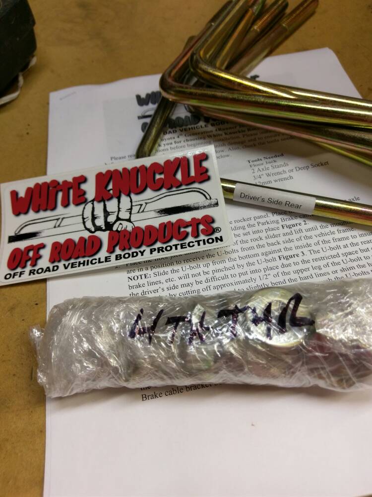

One word of advice when installing these - get the nuts on loosely and then jump up and down on each slider to make sure they shift away from the body. Then snug them up. I know there are folks who grimace at the fact they mount with U bolts. But they're plenty strong and then some.

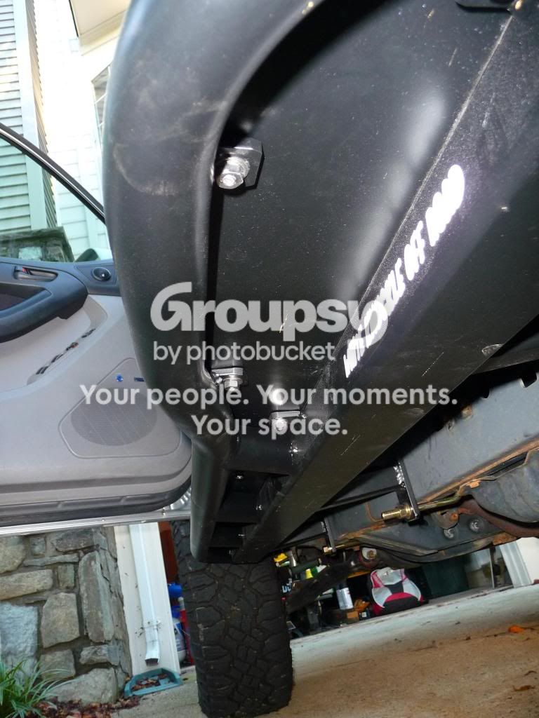

BTW, I found it made it easier to get the driver side, rearmost U-bolt into position by first removing the fuel tank skid plate. It gives you just a little bit of extra room and visibility. That was the trickiest part of the installation. The passenger side went on easily.

I think I need to re - seat or re-torque the U-bolts to help fix a creaking sound. You can hear a creak inside the car as you drive... When the frame bends ever so slightly as you drive down the street, I think the U - bolts move a tiny amount and it makes a creaking noise inside the car... I'll get to it this weekend.
Did you make sure one of the mounts is not touching the body? That's more likely than the u bolts being loose enough to move around. If one of the mounts is touching the body, you can either move the sliders back a bit or put small dent underneath where the mount would touch.
I adjusted mine in the same manner that NJShadow mentioned. I had minor rubbing (it sounded like creaking) on the floor pans and took a pry bar and hammer to the floor pan and made very minor indentations to clearance the slider mounts. Then loosened up the U bolts and jumped up and down on them again. Then I think I tightened up the lower nuts first. Haven't had an issue on or off road since then.
I did like NJShadow mentioned. I had minor rubbing (it sounded like creaking) on the floor pans and took a pry bar and a hammer to the floor pan and made very minor indentations to clearance the slider mounts. Then loosed up the U bolts and jumped up and down on them again. Then I think I tightened up the lower nuts first. Haven't had an issue on or off road since then.
I think mine's doing the exact same thing. Thanks for the tip.. It sounds like it's coming from the driver's side slider. I'll take a look at it this weekend when I have some time.
This was the issue. The center mount on the driver side slider was rubbing against the floor pan. A little persuasion with a large screwdriver and a hammer to make some clearance solved the problem. Thanks!!

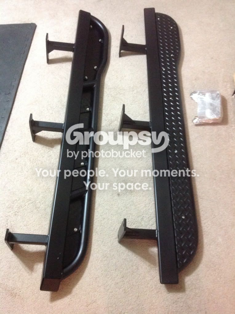

Wow! I just received my WKOR sliders today and am very impressed! These things are beefy and are well built! I opted for the DOM material and the full diamond top-plates. I'll be changing the mounting method just because I've already had something different in mind and can get them to work with my RCI transfer case skid.
John was great to deal with, they were packaged very well, and were right on time. If you're considering these sliders, you won't be disappointed!

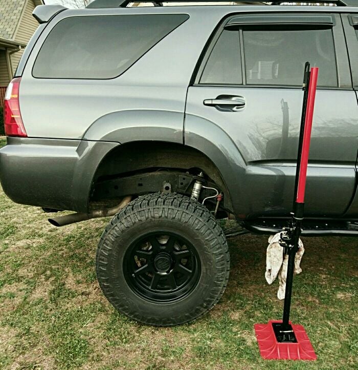

Just installed mine a couple weeks ago and headed out of first trip this weekend. Great company to work with and a nice looking/feeling product. Tested with the hi lift in the yard and they worked great but will report back later.

Was there a lot of flex at the slider when you listed the vehicle with a hi lift?
Please provide more feedback as time goes on. I read somewhere on here that someone noticed some noise of the slider U bolt hitting the floor of the cab. Since you have body lift I do not see that happening to you.
