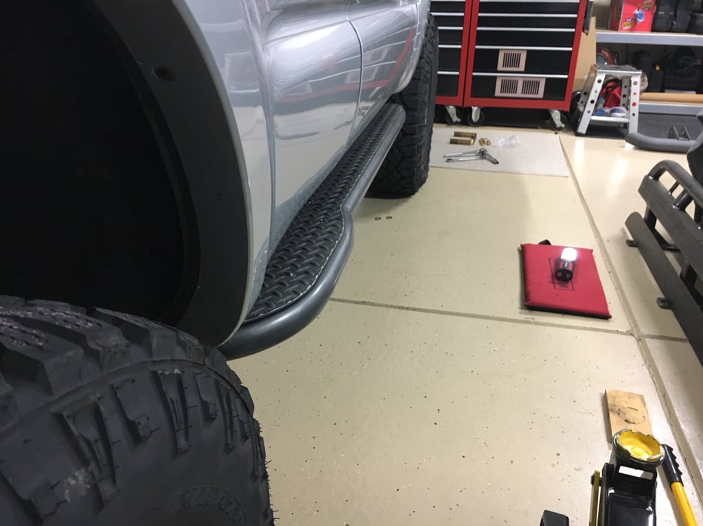

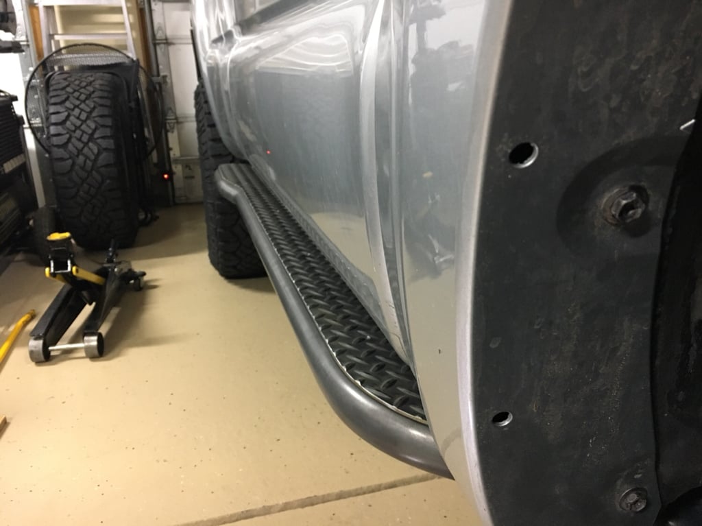

I picked mine up from John yesterday (cash discount Baby!) and then installed them in my friend's shop. Took about an hour and 45 minutes to install the driver's side slider. The passenger side took about 20 minutes. I'm really impressed by how nice these look and they feel incredibly sturdy. I'll be testing them out next weekend in Big Bear. Can't wait!
I have now officially used mine on rocks and trees. They are great and tough! From their customer service (even to me all the way over in Indiana) to their excellent product I tell everyone I can how awesome White Knuckle Offroad Products are. And no I'm no paid or sponsored by them in anyway, I just support good stuff when I get to since I also shit on the bad stuff all over the web too.

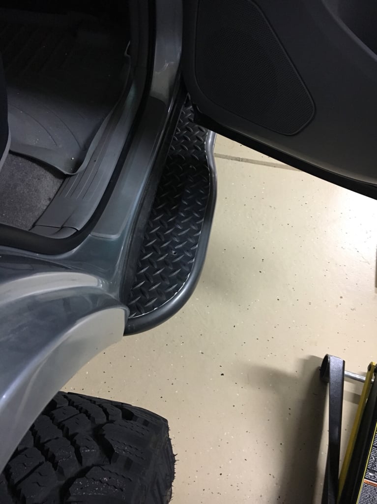

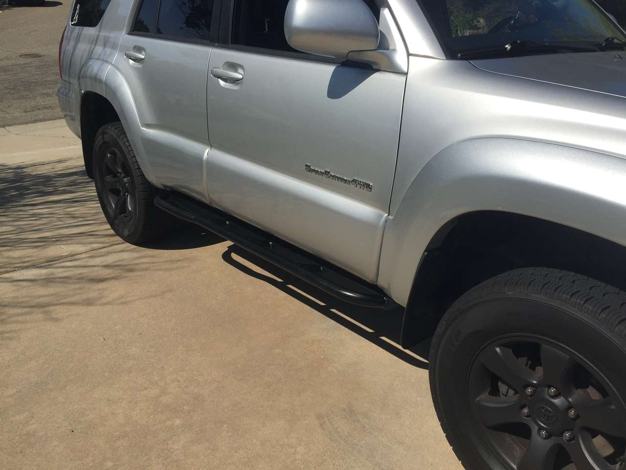

I added 3M Walk Safe grip tape on mine this past weekend. Mrs. Yeti almost slipped getting out of the rig because the slider was wet. I like keeping Mrs. Yeti happy (she lets me buy more shit for my rig :biggrin1: ) so I added the grip tape by cutting out 4 oval-ish sections that more or less mimic the Sport Edition steps.

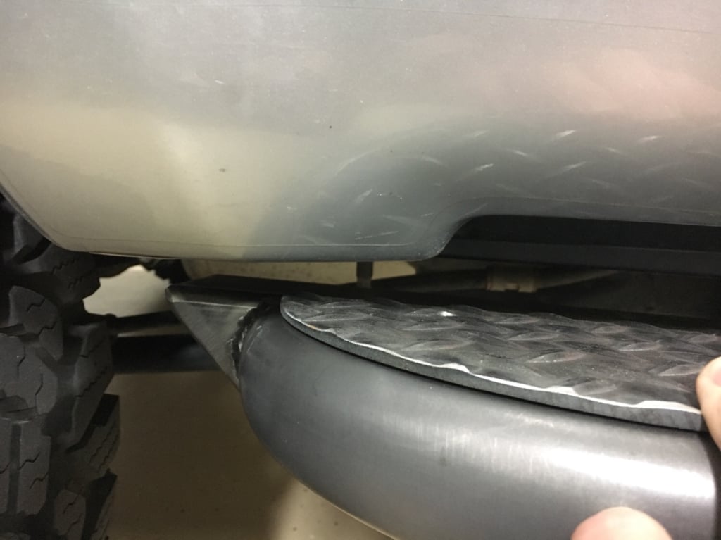

The rear doors on mine were really close with the extra top cover (diamond tread) its heavy too, as it is steel, aluminum would be nice for the top step tread...IMO.
No top tread plate, it would not have rubbed.

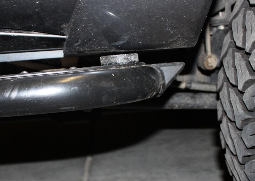

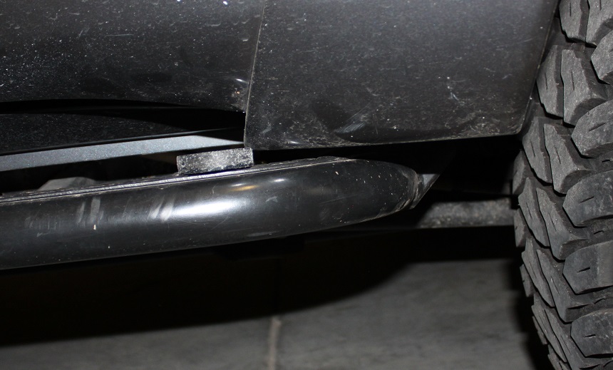

With the top cover on, the closest that the back door comes is exactly 1/2” from the highest part of the slider. I don’t suspect that will give me any problem. I’m also planning to weld these to the frame.
Mine was closer I guess.
1/2" puck in pic.
opened and closed.

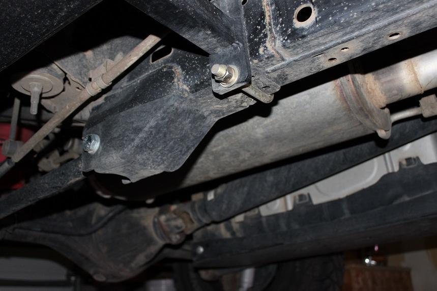

Folks running these - did you have any clearance issues on the driver side middle and rear brackets?
I just got a set for my 2004 T4R (non XREAS) and installed them this weekend. I did finally get the rear ubolt in place, but it is touching a hardline (not pinching, just underneath it and touching). And the middle ubolt is also touching the hardline(s).
My general thought is that these ubolts probably shouldn't be touching the lines. Right? I was assuming general vibration could wear a hole?
Should I shim them? If so, how/what material? I think the rear one will be particularly difficult to access.
Pictures here, poorly labeled: https://imgur.com/a/z7Lix - I could not get them to cooperate and display in a normal size in the browser, so didn't want to ruin the thread with giant pics.
It's been a year since I installed mine, but I recall the instructions said to slightly move the hard lines. I recall one of mine I was able to bend the bracket to get clearance. I think I may have shimmed the other but I don't specifically recall. I know it was a bit of a ***** to install the driver's side.
Passenger side install = 5 minutes
Driver side install = cursing, blood, more time.
I ended up bending those lines away from the u bolt. I couldn't be happier with these sliders a year later!
