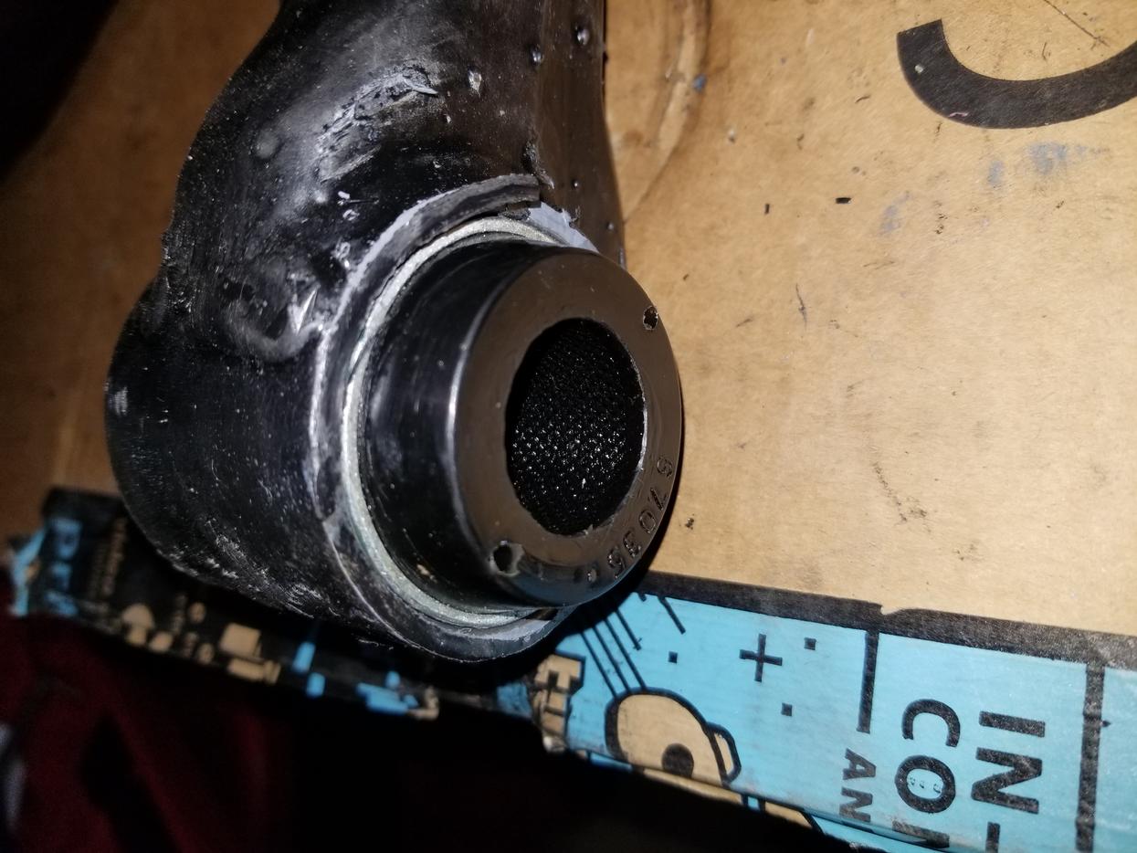

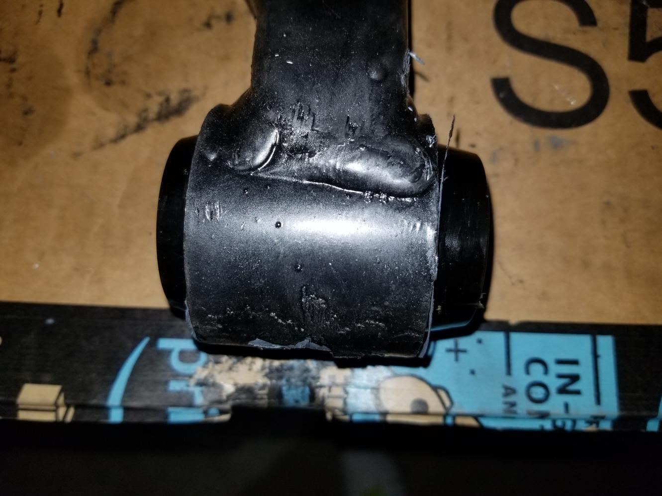

Well, they looked good. Got them pressed in and I found a flaw in the fitment. You can move the control arm maybe 3/16" front to back. I sent them an email. We will see what they say.
You can see the gap in the picture. This is not at the same time. That is the gap when the arm is pushed in each direction. Push back it seats against the opposite bushing collar, forward and it seats against the other collar. If that makes sense Haha.

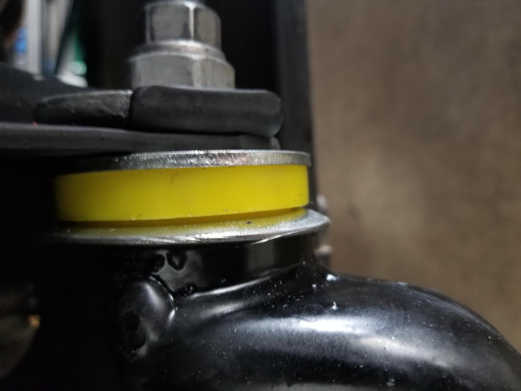

Removed Siberian bushings. Installed Whitelines. Confirmed they fit perfect even though whiteline does not list them as fitting. They are not tapered like OEM style, they press in the entire way of the sleeve. Makes it slightly bit more difficult for installing, but not by much. I stuck them in the freezer for a few hours and they pressed in place nicely. I'll finish installing when my coils get back and its aligned.
As a side note for anyone installing these, make sure you install them in the correct direction. They look like they are non directional, but look close and notice that one side of the sleeve has more poly sticking out than the other.

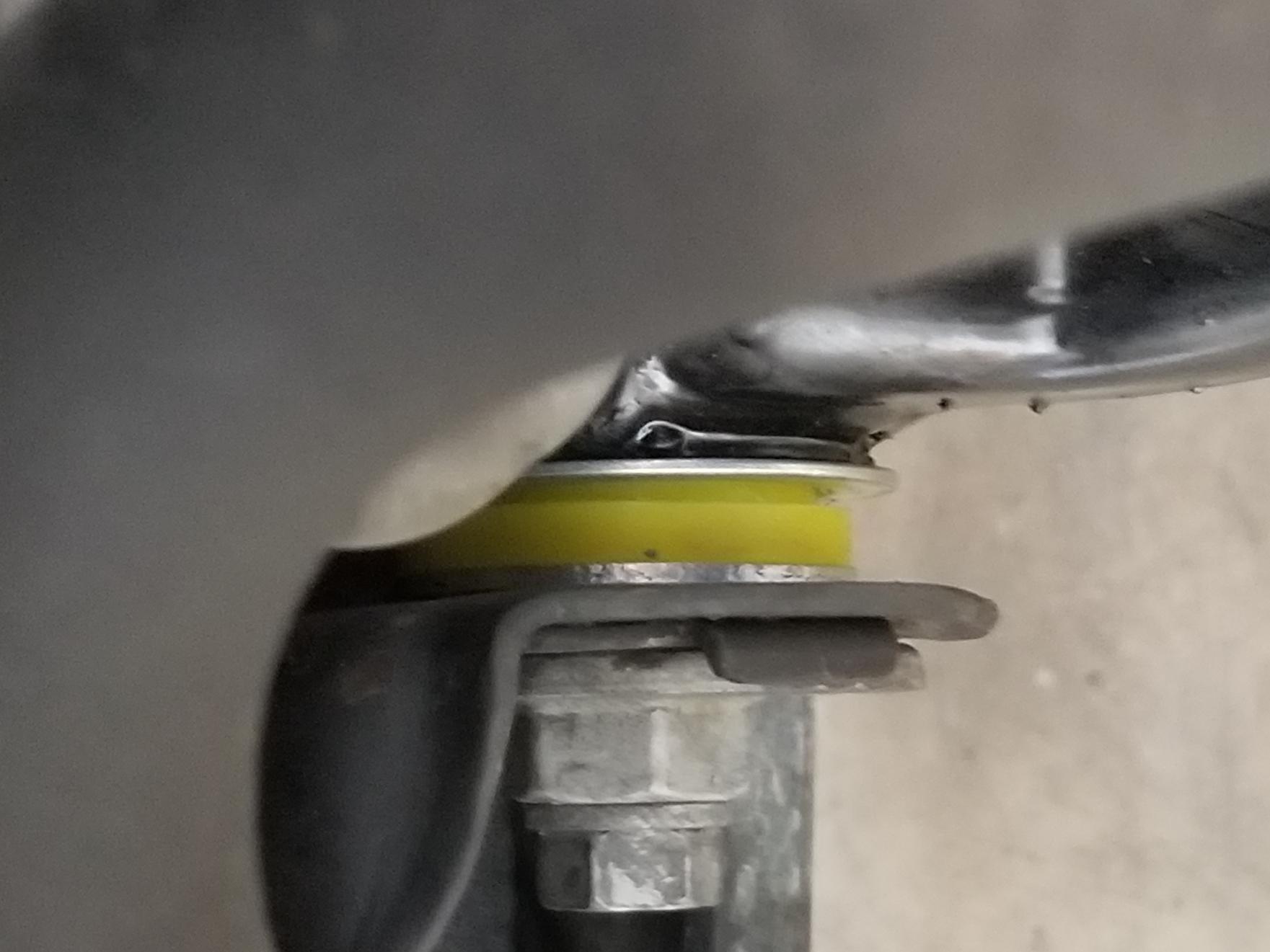

I'm considering drilling them out for a grease fitting. Anyone else did this? [MENTION=140870]Offcamber[/MENTION] or [MENTION=134758]SoSoRunner[/MENTION]

I considered it, but decided to leave them alone and added the bushings to my maintenance list. Given the number of poly bushings, uni-balls, and Johnny Joints now on my 4Runner, I figured "What's a few more to grease, right?!"
Well got it all finished. Whitelines fit and work great. I got 555 ball joints from Napa under the Atrom brand. Clearly higher quality than the Moogs I had in before. The Moogs had maybe 10k on them and were already getting loose.
