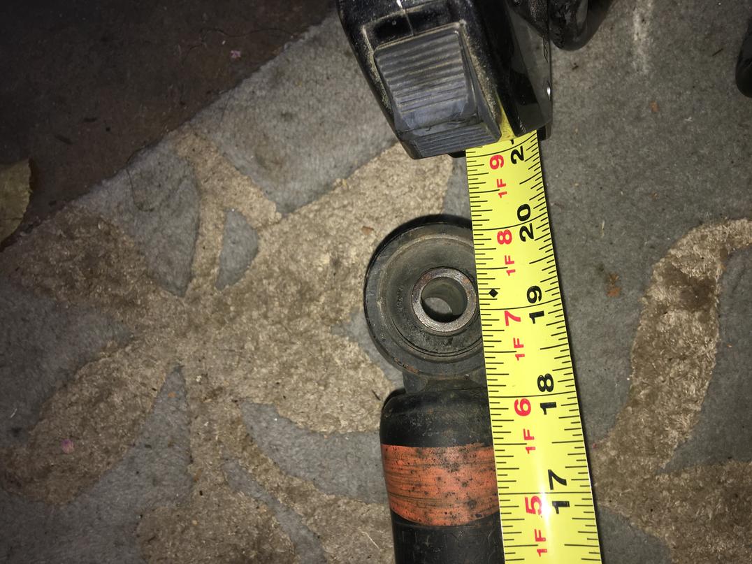

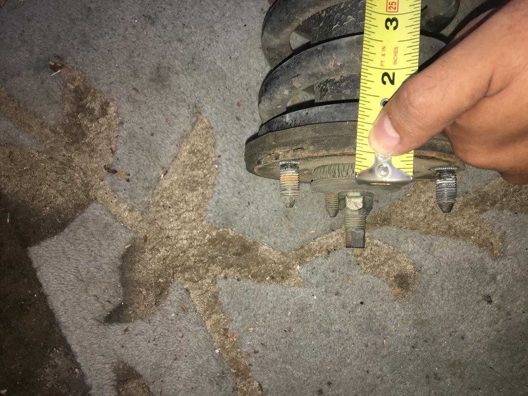

I have the springs, but it’s all apart. I can measure the springs from a 98. I know it’s not what you asked, but if it helps I’m game
Off a 00 limited 4x4
Color code yellow/white
Not sure if that’s what you wanted tbh
If it’s not at all what you want let me know I’ll remeasure or hopefully someone else helps out

Thank you! A little hard to read measuring tapes in pics- could you hook the hook on the top plate, and tell me what the distance is to the center of the lower eye bolt hole?
Looks to be 18-18.5"?
I posted above 18.5”, which is center of top hat to center of the lower eyelet. I think he measured at the top of the upper bushing to get 19.5”.
i misread the original post :lol:
it brings it to 18.5" when measuring it from the top plate to the center eyelet
