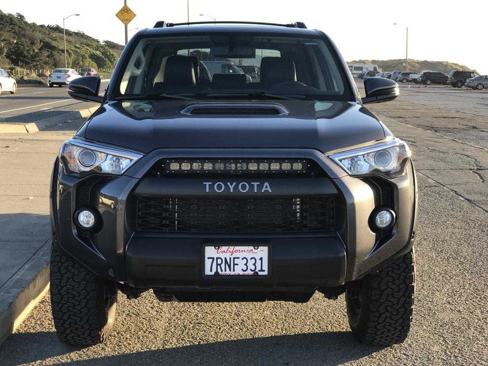

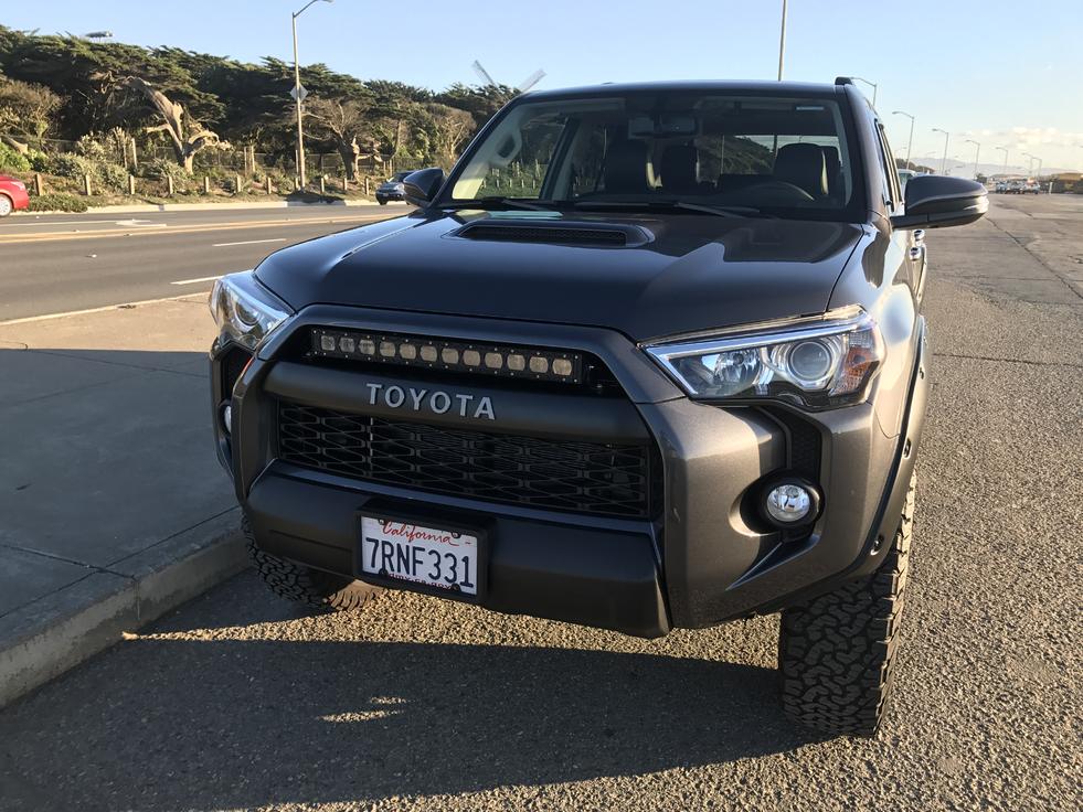

Coming to you guys again for some help. I'm still not 100% happy with my stance after adding my bushwhacker flares.
Initially I wanted to avoid doing a body mount chop, so I went with 285/70/17 ko2's and 1" bora spacers. It does not rub on the body mount but it is very close. Most recent pictures of stance shown below.
It doesn't look bad, but I want to go wider and have my tires stick out more. I was looking to switch to nitto ridge grapplers in 285/70/17 because they seem to run a little wider than the undersized ko2's which would probably require a body mount chop, which I am now willing to do.
So I got to thinking, if I'm going to chop, maybe I should just go all the way and go for 33x12.5
if any of you are running 33x12.5, can you please share some pics with your specs. Such as wheel size/offset etc. and what mods did you do it make it fit without rubbing?
Currently I'm running 285/70/17 ko2's on 17x8.5 zero offset. I have a 3" lift with stock upper control arms.
Let's see those wide stances! Thanks

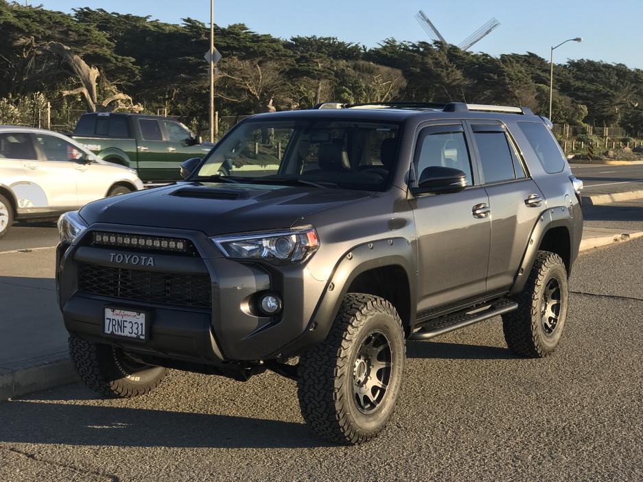

Another reason I wanted to go ridge grapplers is for the slightly more aggressive tread pattern and seems they run closer to a true 33" diameter.
My current tires measure in around 32" and look small to me. I know it's just aesthetics, but isn't that half of the game?

I think the swap to nitto's will help. 285/70/17 are suppose to be 32.7x11.2 but I measured them on my rig and they were more like 32x10.25

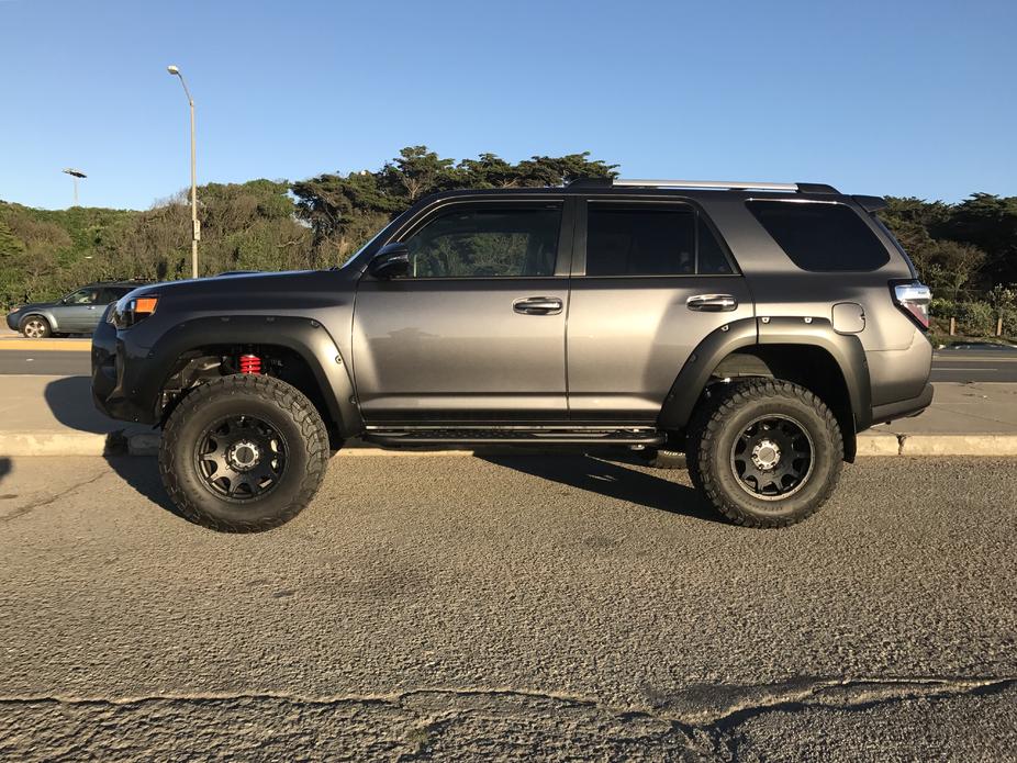

Here's an image I found on IG that shows the stance I'm trying to achieve

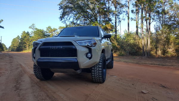

My 2nd TRDP came with dealer-installed 20x10s with 4.5" backspacing, wrapped in 33x12.5s. I loved the stance, but didnt like the poor ride quality and we lost about 1mpg relative to stock.
I had to move the fender liners forward and trim the bottom rear of the bumper. This created about 1.5" of space on level ground. They still rubbed lightly on the BM, but I never experimented with alignment to possibly increase caster. As minimally as they rubbed on the BM, I am pretty confident that, especially with aftermarket UCAs, it could have worked.
However, I can't confirm they would not have rubbed at full articulation. My current 285s on 17x8s with 4" BS are only about 3/8" away from the rear of the fender liner above the BM, with the wheel cranked all the way left and the front left tire stuffed all the way up (left rear off the ground). Again, however, I have not experimented with caster.

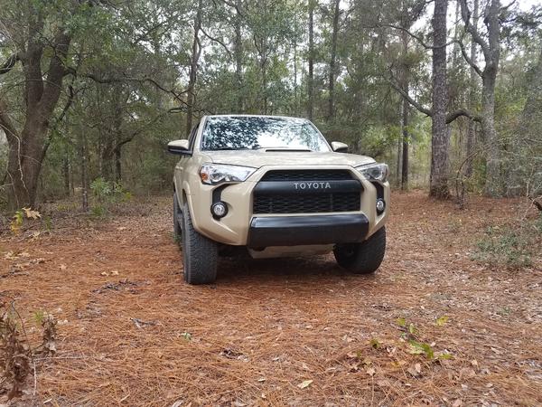

Your stance looks good! Is that picture of your current 285 set up? Is your wheel offset -10? The stance looks really wide for not having spacers. What brand of tires?
I got 305/60r18 on mine with the flares and it sits perfect in my opinion. Without the flares it looked like the white T4R in the above picture
That was the 20x10s, 4.5" Backspace with 33x12.5x20 Treadwright Mud Claws.
Here is my current setup with the 17x8, 4" BS, with 285s.
The 20x10 / 33x12.5 setup stuck out about 1" further than my current setup, which sticks out a bit more than 1" further than a stock TRDP, which is something like an inch wider in stance than a Trail (and more for an SR5).
