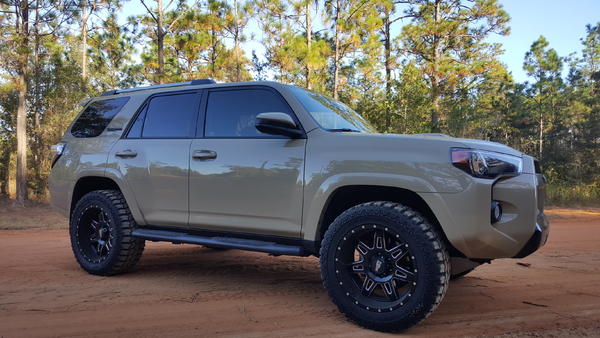

I'm running 285 Trail Grapplers 17" rims with negative 10 offset with spidertrax spacers 1.25". I also have aftermarket UCA. I had to do a body mount chop because I was not clearing at all. I also had to trim a lot from the bottom front fender flares. My tires stick out a little pass the bushwacker fenders. The picture angle doesn't really show.

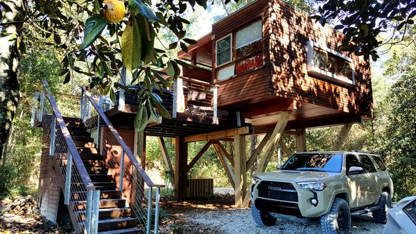

Do you have any side profile pics of that setup?[/QUOTE]
It definitely needed a lift to round out the look. When I was debating whether to keep that wheel / tire combo, the first contingency for keeping them was to repaint them to get rid of those silly fake silver rivets, heh.
*edit*
Here is another pic that better depicts how it actually looked from most angles.
*edit*

thats actually a good look if u had it lifted 2 more " and a different face for that sz wheel

I'm definitely looking for something similar to your set up. Do you have any more pics you can share?
You had to trim the bottom of the fender flare? Or did you mean the fender liner?
I had to trim both the fender liner and fender flare. I'll take more photos later on tonight when I get off from work and pm you.
