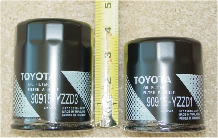

I finally got a chance to take a picture of the D1 and D3 side-by-side. The only difference is about 3/4-inch in length.
The D3 is Toyota's V8 filter. They only make 3 sizes - 4, 6, and 8 cyl. You can always use the largest one that physically fits in your vehicle, regardless of what the book says.

Thats funny, Ive always gotten the D3 from the stealership. Never asked for more than a "2006 V6 4R" filter. :confused: Im not complaining though, maybe Ive been paying less for them?
