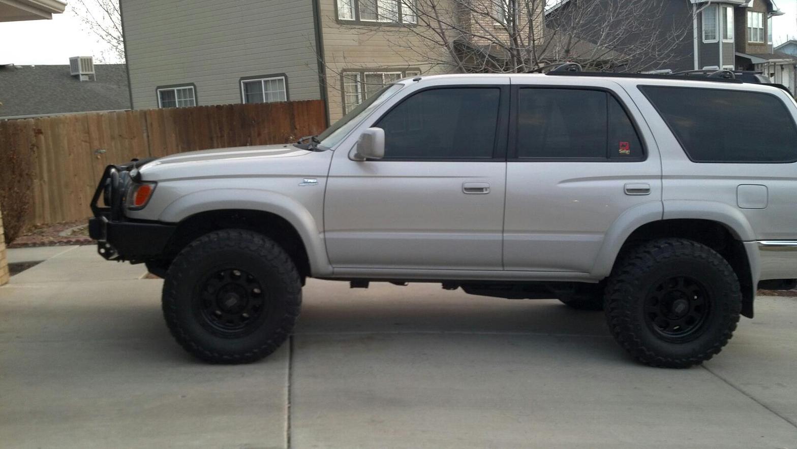

I did Line X on my rockers and flares, color matched. I Por -15 any rust on the under carriage, then had Line X undercoat everything. Not cheap, but not awful either ( $ 1000.00 ). I think it came out pretty good.
Man I can't tell that they are sprayed with Line X. You have a closer shot? Hurculiner only cost me $80 and it did my fender flares, rockers, and my brothers Ram.
