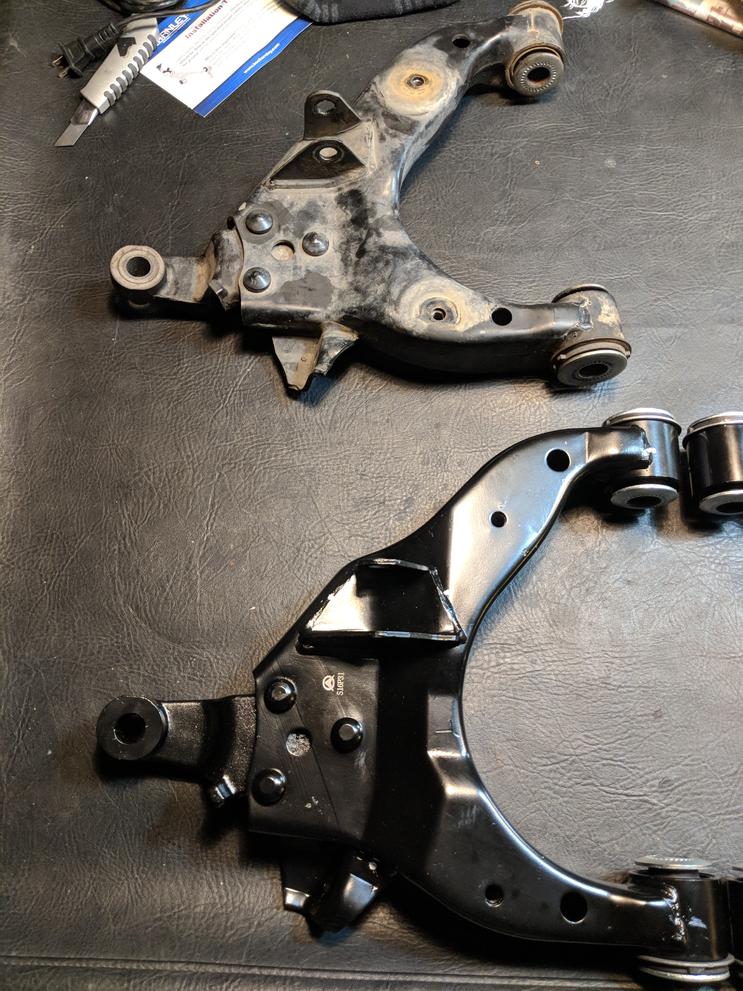

Just chiming in on aftermarket LCAs. I bought a set of Beck Arnely LCAs from rockauto for $220 shipped and they seemed to be just as good as OEM plus it was nice to have fresh coat of paint instead of looking at my old chipped one. With over 10k on the new LCAs, I have had no complaints.
At the time of purchasing I didn't have a press but I still think it would have been worth it to just swap new LCAs in instead of having to wrestle with replacing the bushings. Basically fewer unknowns and less-down time (important if its your daily driver).
Thanks for the side by side pic. Those look ok...that said, your OEMs look immaculate compared to mine.
also, yes... one photo of a ripped apart aftermarket shouldn't be a blanket statement that they are all garbage. If i didn't already have a press and all the other tools required to press my old rusty ones out, i would have definitely considered the rock auto/whiteline route much more.
