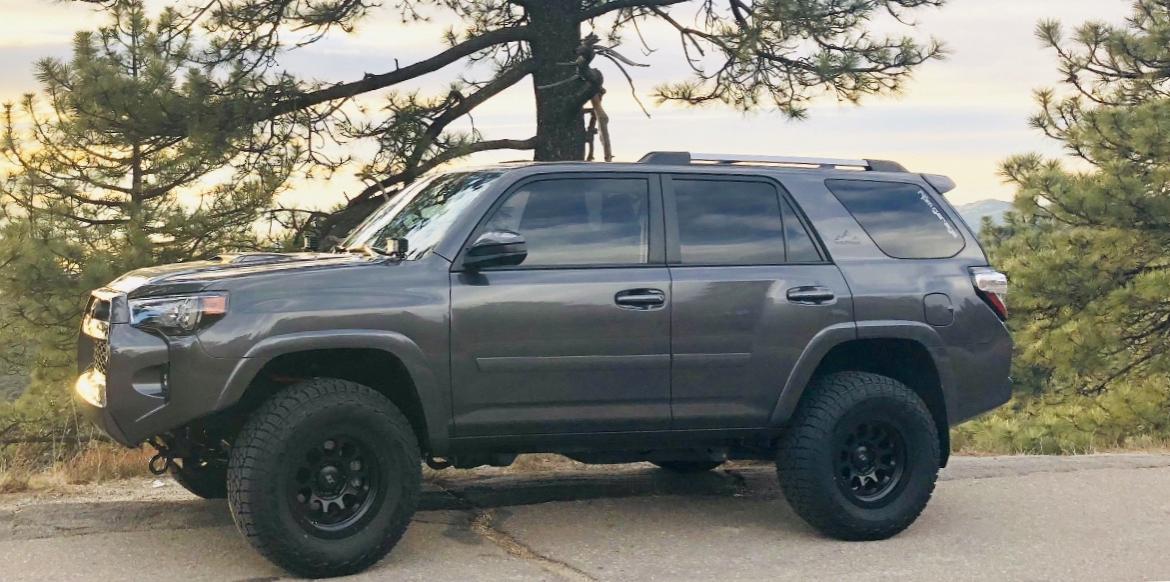

This is where I’m at as well, same set up with spacer driver front side for lean. No more nose dive, stiffer ride without being harsh, and surprisingly capable off road. I will upgrade to King or Radflo once i blow through the 5100s, but the T1/13 combo is amazing.
