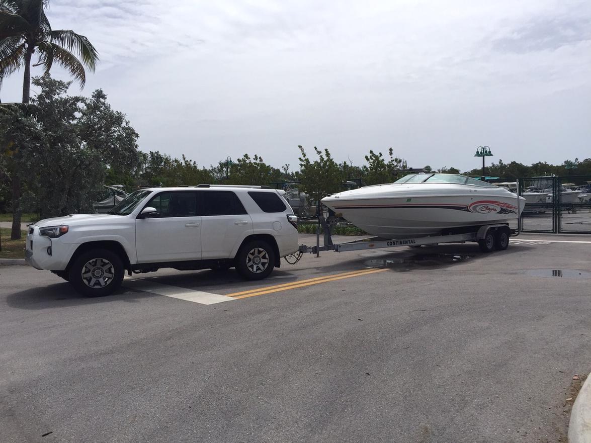

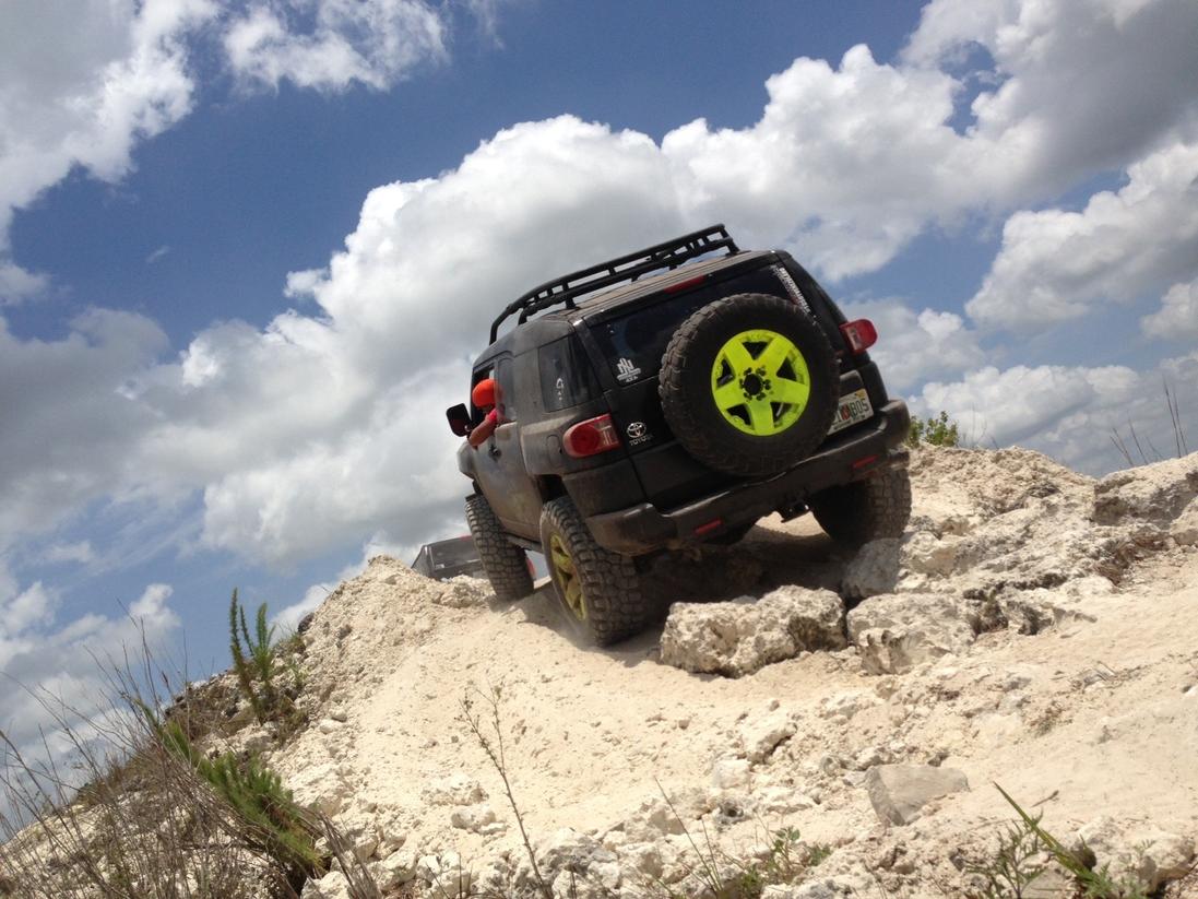

Here is a picture of my 4Runner and also my Fj Cruiser
