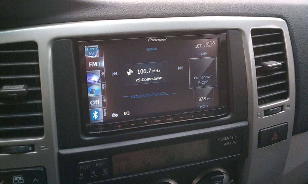

its an 06 sport edition... I could have sworn I have seen the names of stations come across it, but I wouldnt put any money on it... I did just purchase the car so this is one of those things that I havent paid attention to... here is a pic of the unit.
2011-06-19_22-02-24_856.jpg~original
So the head unit fitment has the most to do with what kind of mounting bracket you can get for the space. Your head unit seems to be the same shape as mine, with the same shape of dash opening. See this pic of my head unit (first) and the JBL head unit for comparsion:
4runnerheadunit.jpg~original
11779d1161171937-wanted-2006-6-disk-jbl-head-unit-dsc00459.jpg~original
So there are two different mounting brackets. Yours will fit the same characteristics as the one I ordered, just in double DIN. So I think it's safe to say that you should select the non-RDS and non JBL options, and go with whatever that gives you. You still may want to see if your head unit has RDS, but to be honest, I have no idea what difference it'll make (maybe with the wiring harness? but doubtful). I can tell you that the bracket you get from putting in the non JBl and non RDS options will fit your dash opening, thus any head unit that they say will fit with these options selected will indeed fit. Hope that helps!
