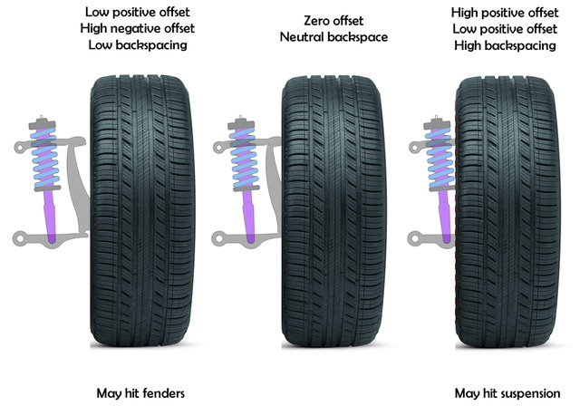

This may help as a visual.

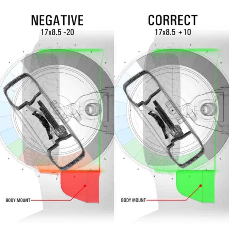

It's called "scrub radius." Moving the wheel outboard of the steering centerline results in a negative scrub radius, which can cause the tire to rub on the fender. Here's another image:
Last image is precious!
Now it absolutely explains the reason.
Looks like lift will not help there too much, so may be I'll stuck with 275 tires then, it's a pity there is not a lot of C-loads there not talking about SL ones :(.
I thought the same thing about negative giving me more space. Thanks for this as that explains a lot!

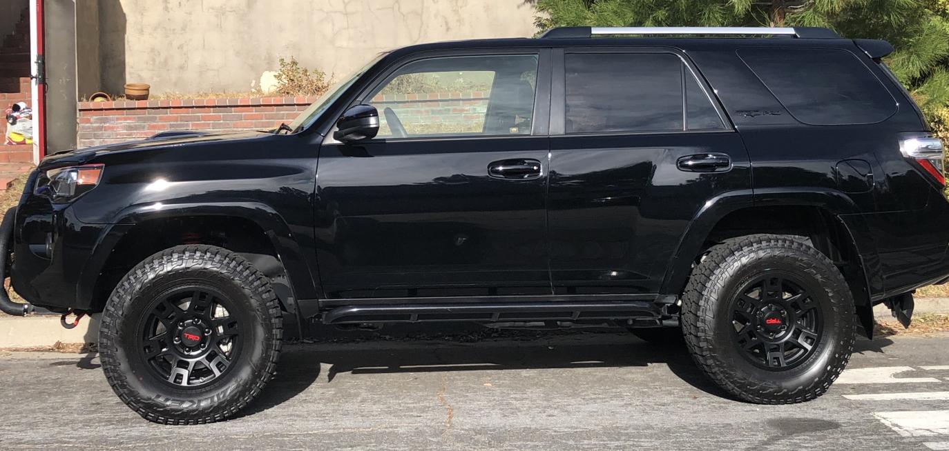

Here is my Pro with 1.6" Eibach springs in front and 1" in rear with 285's. Zero rubbing while turning. Haven’t had heavy off road yet.

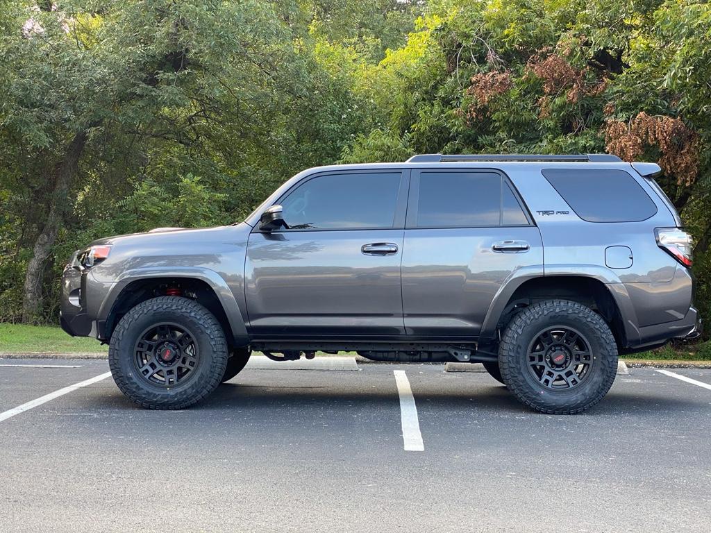

Mine is basically the same as DallasTRDPro including tires, except I am running 1.5/1” Cornfed spacers on my Pro. No mods or rubbing with 285’s. Still have my front mud flaps. On the Pro the combination of the wheel width and offset along with the port fender mod creates no rub and very minor rub in maximum articulation conditions off road. Center of hub to front arch = 22.5”, rear = 23.25”. Go 285’s. You won’t regret it.
Looks really great and sounds very promising!
You mentioned very minor rub offroad - what place is it rubbing?
I did a 128 mile Offroad trip a few weeks ago and there would be a very slight scuff once in awhile on the front inner fender liner.
