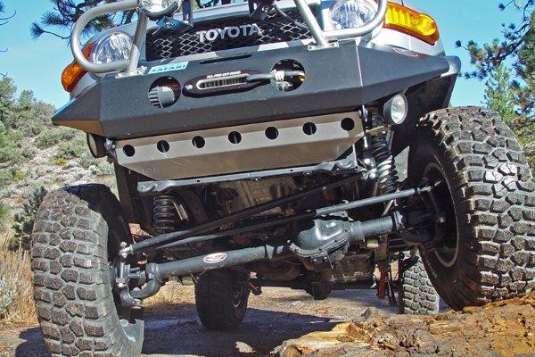

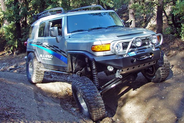

SAS would cure all these problems - several FJ have been done (same frame)
ALLPRO might be able to help:
If you want to be the first your better hurray DLAK is already threatening a SAS ... his tires are hu-mong-gus
