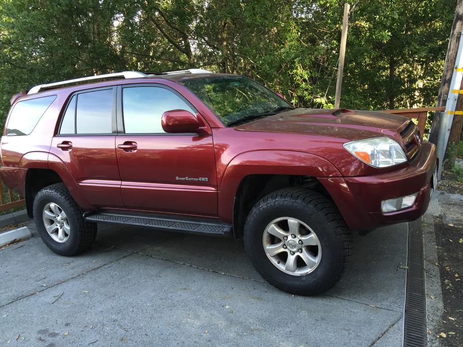

Here is mine with that lift and 285 Nitto All Terrains. It definitely would have been easier to do with 275's but I wanted the bigger tires. The lift is great I think but I would've got the regular springs out back instead of the heavy duty ones I ordered the lift with. They are really stiff but I haul my dirt bike on a hitch carrier so that is why I got the heavier springs. They are actually breaking in now and are a lot better then when I first installed them.

Those have to be the smallest 285/70s ever. I had 255/80s on my 4th gen and couldn't turn the wheel much more than half a turn before they started to rub the mud guard on the rear of the wheel well. The front well required a lot of trimming to include the bumper. I had to remove the rear mud guards to stop the tire from pulling on the rear mud guard screw heads while flexed too.
Well they are all terrains. They did rub on the UCA and the front fender liner. I easily fixed that with a 8mm spacer with longer wheel studs. Now it is fine. 275's like I said would be much easier.
