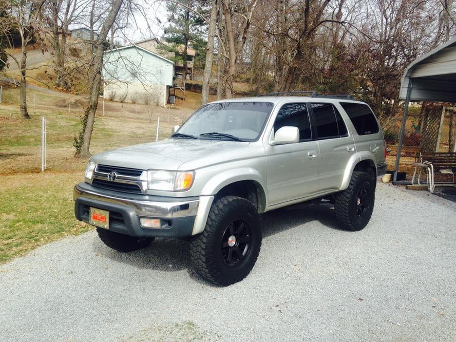

My guess would be yes. I ran 255/80r17's with 17x8 -10 offset and i had to do some trimming and it still would rub with the Toytec ultimate lift. My tires would be .3" taller and about a 1" narrower than the ones you want to run.
Thanks, that answers it for me. Think I'm going to go with American Racing AX199 MOJAVE II 16x8 0mm:
https://www.tirerack.com/wheels/WheelCloseUpServlet?&target=runWheelSearch&autoMake=Toyota&autoModel=4Runner+Limited+4wd&autoYear=2000&autoModClar=&initialPartNumber=AX19968060700B&i1_Qty=4&wheelMake=ATX&wheelModel=AX199+Mojave+II&wheelFinish=Black+Painted&wheelFinish=Black+Painted&showRear=no&packageFlow=false
I doubt I will get much rubbing, if any with those. I can always bump them out a bit with spacers to make up for the 0 offset. Thanks!
You should be fine with those. I have a 2" lift with 33" tires and that offset and it rubs slightly when turning all the way. Hopefully once I get my new Toytec lift kit it will fix the rubbing for me.
