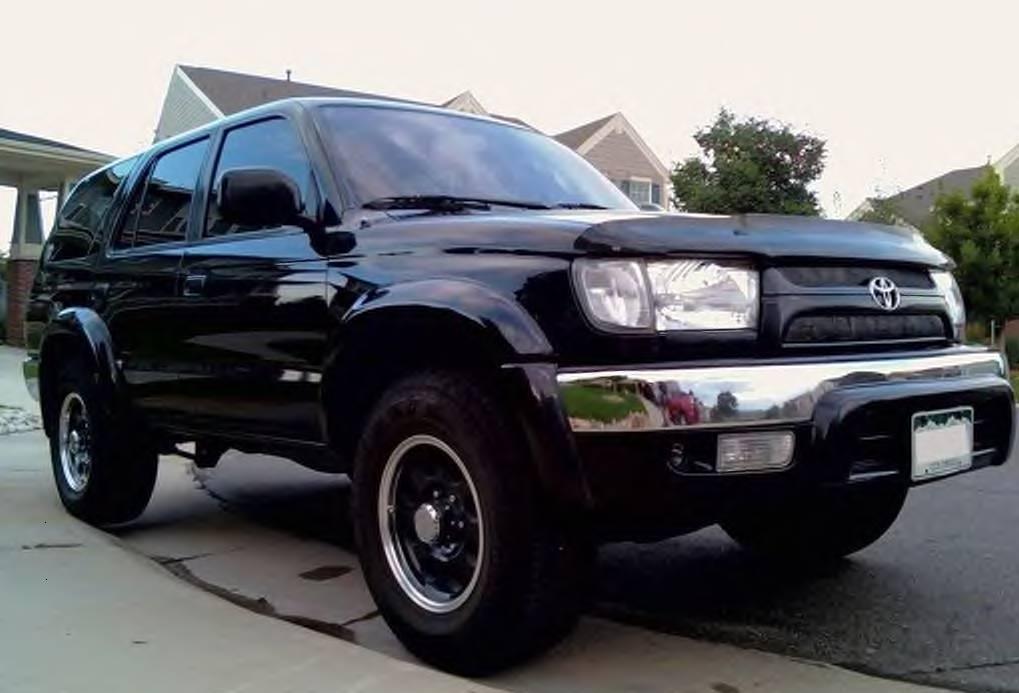

I was thinking 8 hole Black wheels with stainless steel center cap and lug nuts...and maybe a stainless steel trim ring around each wheel.
How does that sound? :fishing:
No trim rings????? Whaaa....
