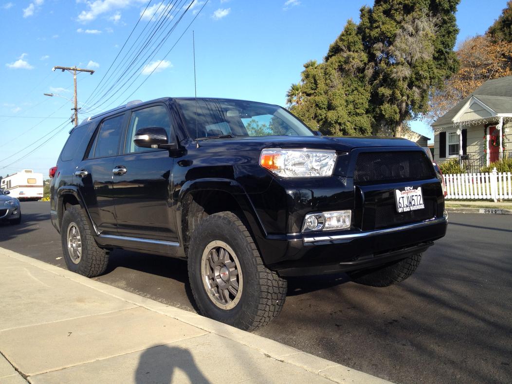

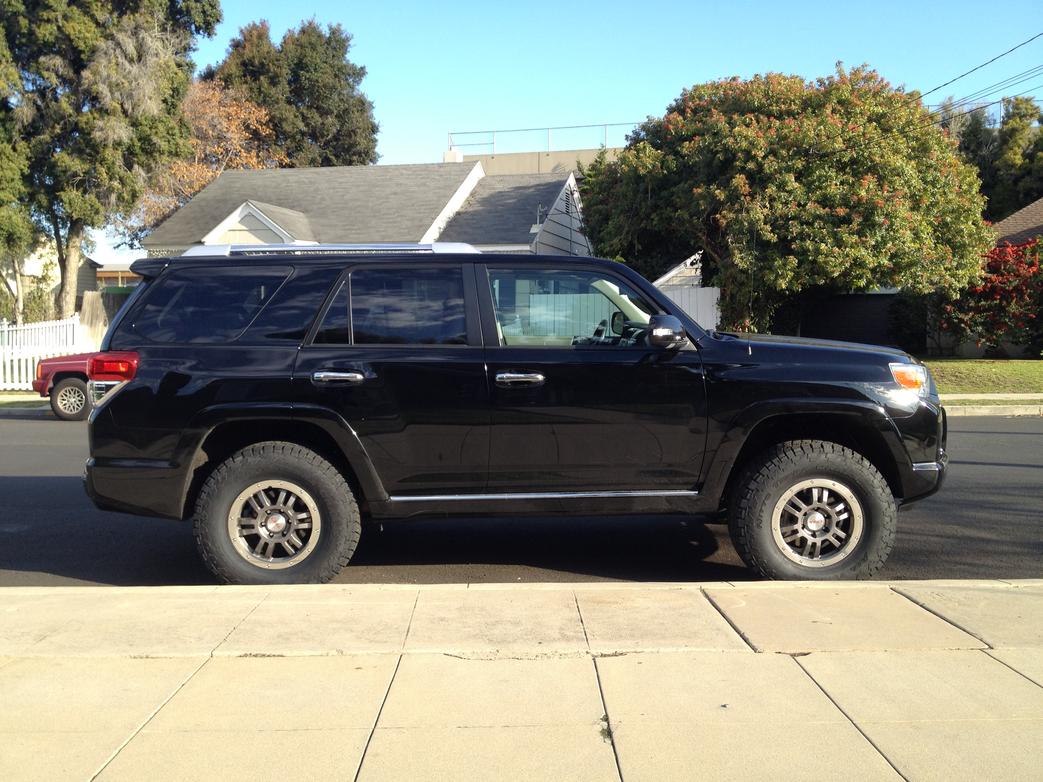

It may not rub now...But when, and/or if you go off the road and start articulating the suspension, let us know.
So how much rubbing is there id any is present?
surprisingly there is no rubbing whatsoever. I moved the front fender liner foward a couple inches and thats about it. I'm heading out to the desert for new years and I will update if I get any rubbing then.

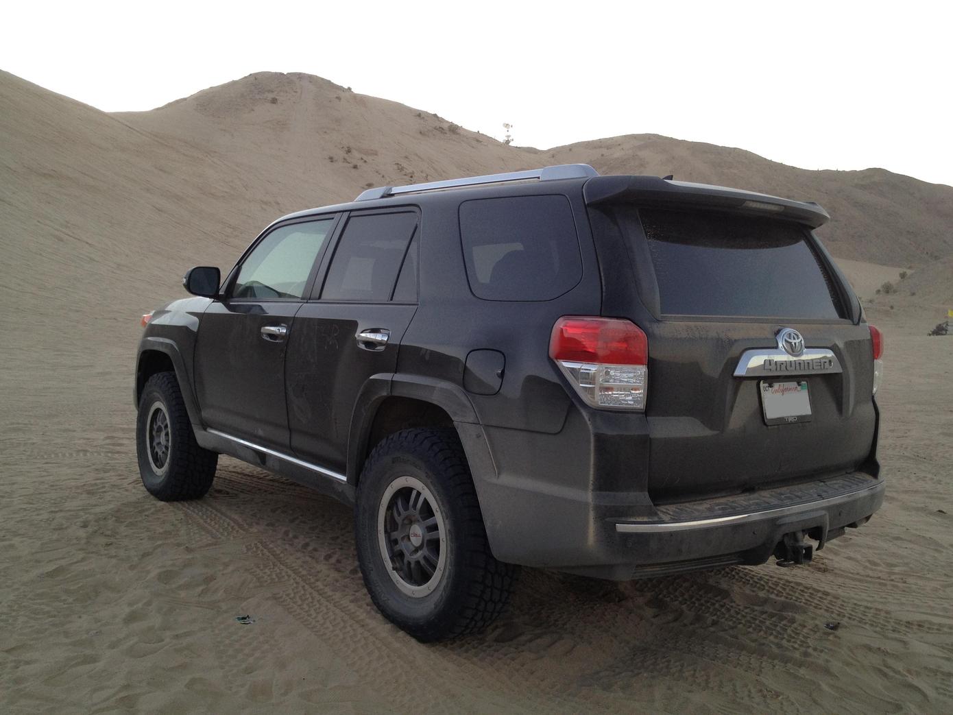

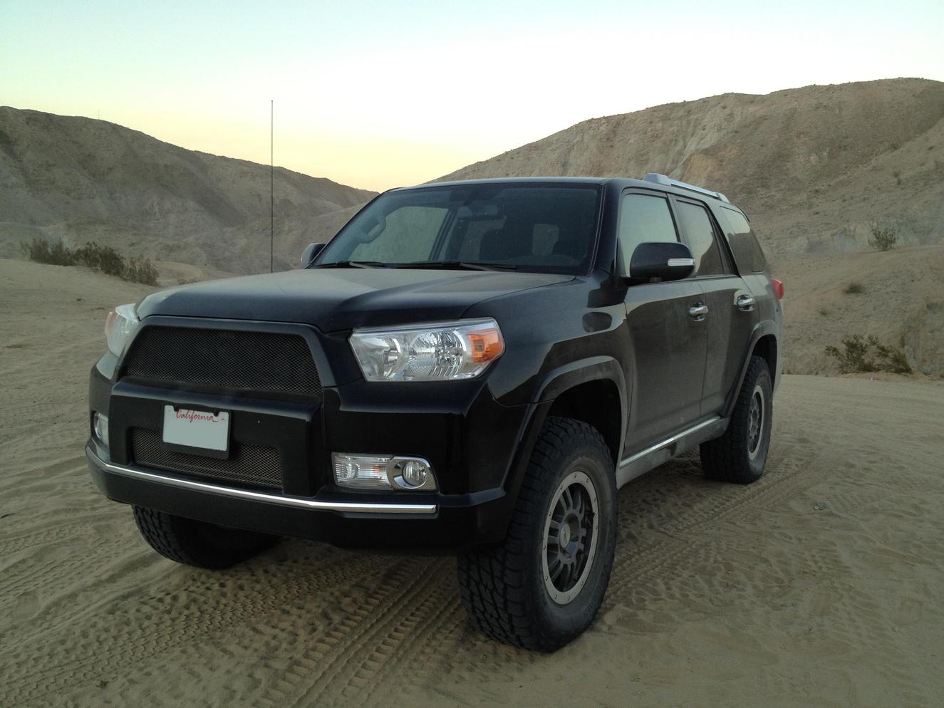

I took it out over New Years weekend to superstition. No rubbing at all, even with bilsteins lowerd to 1.75. Super impressed with my new T4R, Ran it straight up the face of Sand Dam with no problems. Here is a couple pics at the bottom of sand dam hill.
