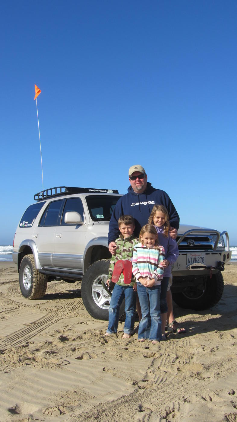

I just use electrical tape and zip ties and attach it to my Bajarack . Works great and it puts it up even higher. Kinda redneck but it works awesome.

Ha ha i have done something like that with ju precious truck aswell. I put the spare wheel and tired I. My bed tied it down and screwed the flag through one of the lug holes.
