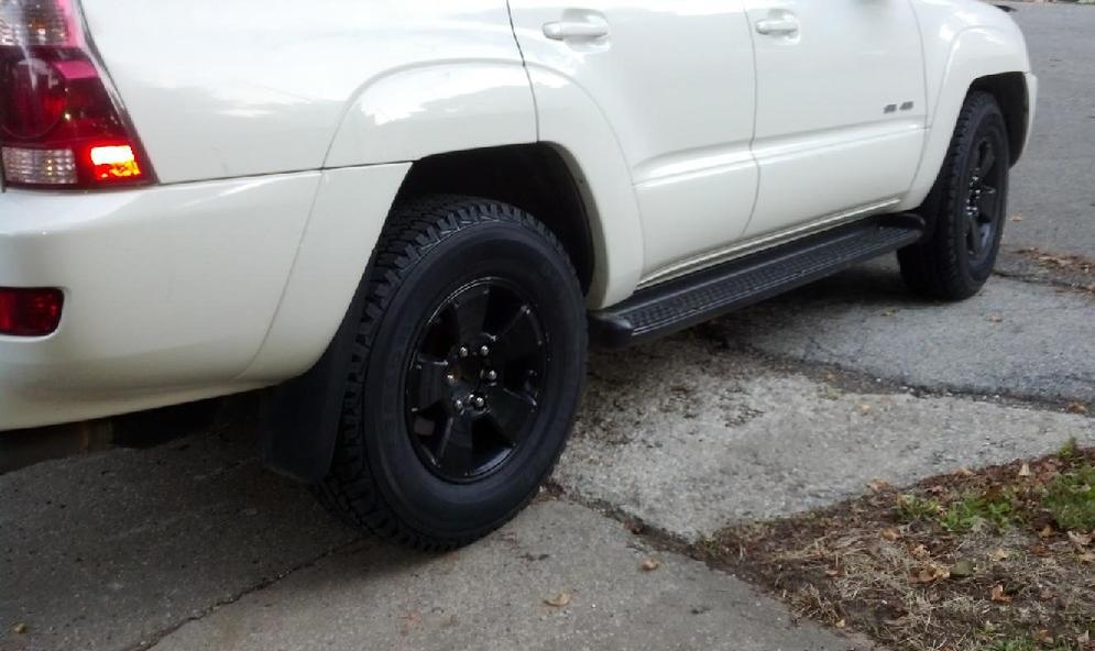

I'll get better pics posted later. Here they are on the newly acquired PC black SR5 wheels.
