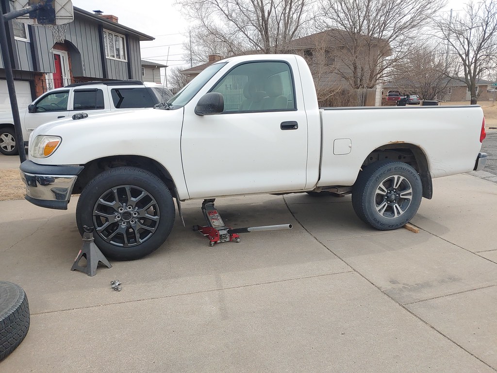

All the 2022 Tundra wheels are 6 lug. I have a pair of 2022 wheels I was going to try and run on my 2005 Tundra which has the same bolt pattern as our 4Runners.
The problem is the offset, you will need wheel spacers to clear the spindle.
You will also need wheel spacers that adapt from m12 to m14 threads as the 4runner conical lug nuts wallow around in the bore. Newer Tundra's must use m14 studs.
You will also need wheel spacers that adapt from m12 to m14 threads as the 4runner conical lug nuts wallow around in the bore. Tundra's must use m14 studs.
