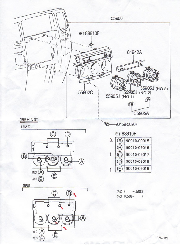

So half of my A/C control panel is out. I have found several post on how to change the bulbs, but not much luck on what part # for the bulbs. Wanted to see if these are the bulbs I need;

This diagram will give you the OEM part numbers for the the HVAC display/control bulbs.
Keep in mind as shown on the left in the diagram which is viewing the displays from behind that the number of bulbs and or location are a little bit different on the Limited dual zone system compared to the SR5 single zone system.
