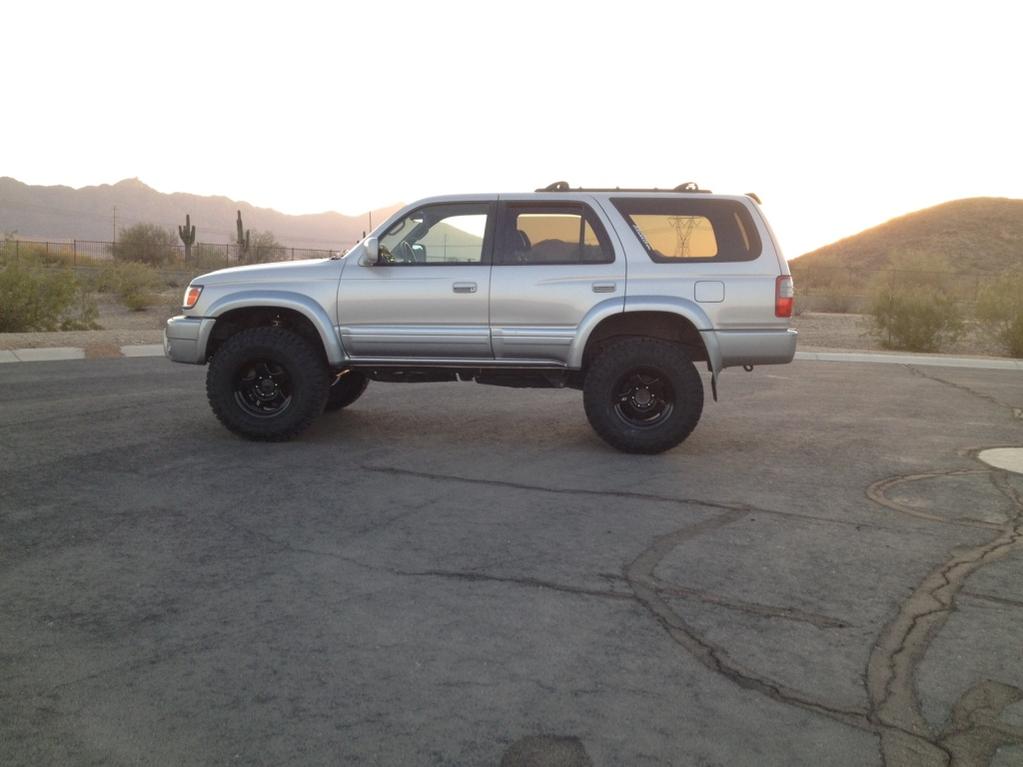

Can anyone show me pics of superflex in the rear and 3"in front?

With superflex. I searched and found this. Toytec coils and superflex.
Right, I don't think that looks bad, am I wrong? I could always put some weight in the rear, lol.

Hell no. It looks awesome
With that said. I've notice one thing difference. The front fender line vs rear quarter line are in different height levels. So you sometimes you bee look HARD AT THE ROCKER PANELS and see if the back is higher aka rake
