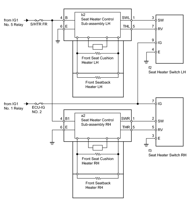

Anyway I just wanted to give everyone an update on my heated seats. I use them almost everyday and they are still going strong. I was worried about the thermistor wires breaking due to their location in the seat back but so far everything is working great. My driver side seat is warmer (at equal switch settings) than the passenger seat but not enough to for me to reposition the thermistor in the passenger side seat.
Attached is one of the wiring diagrams I used.
