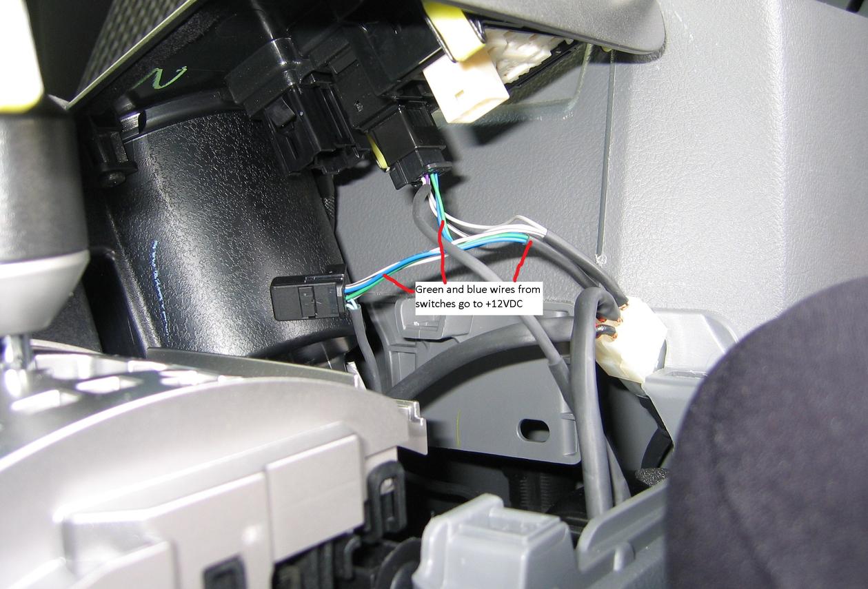

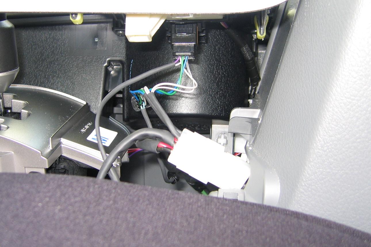

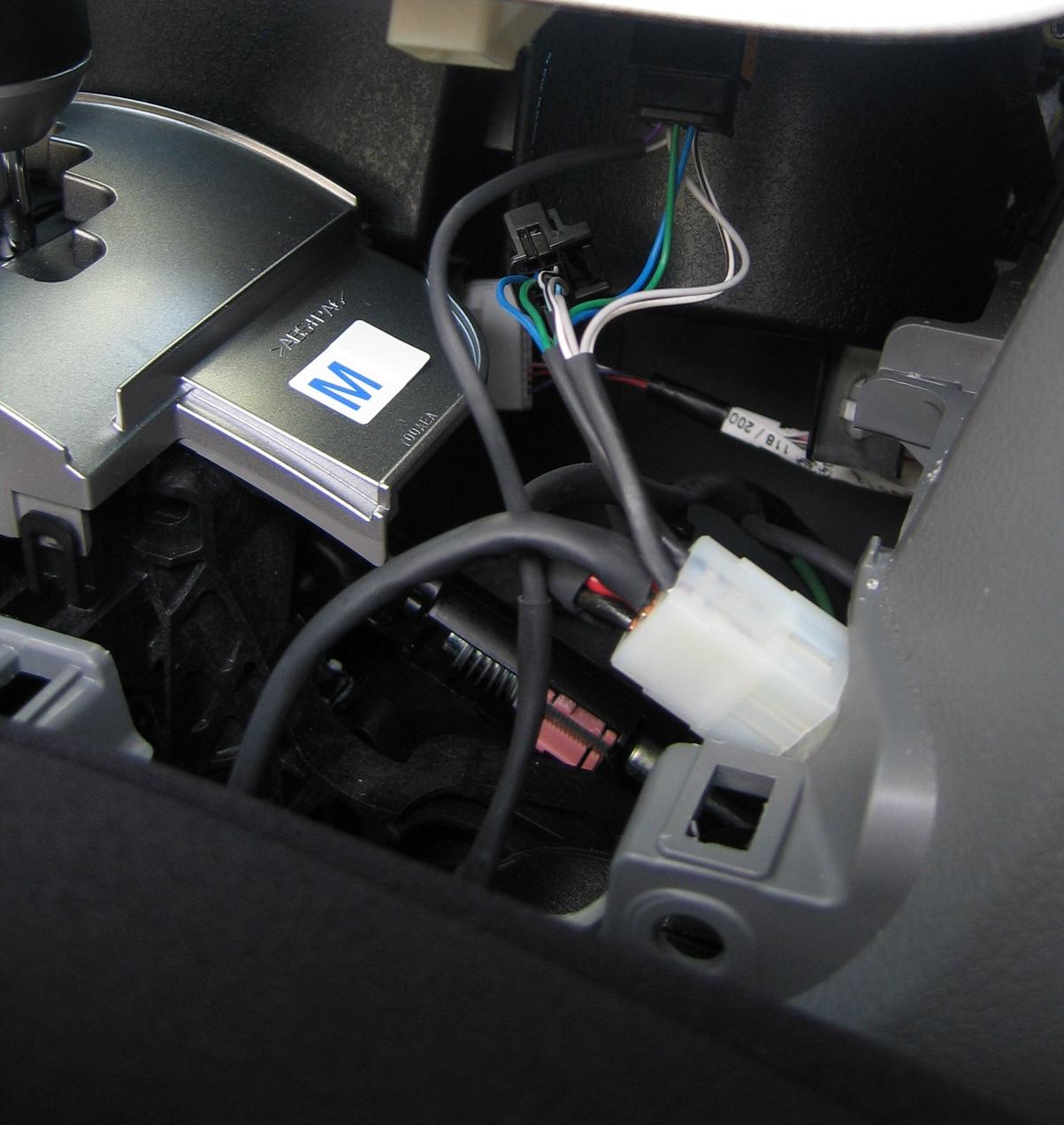

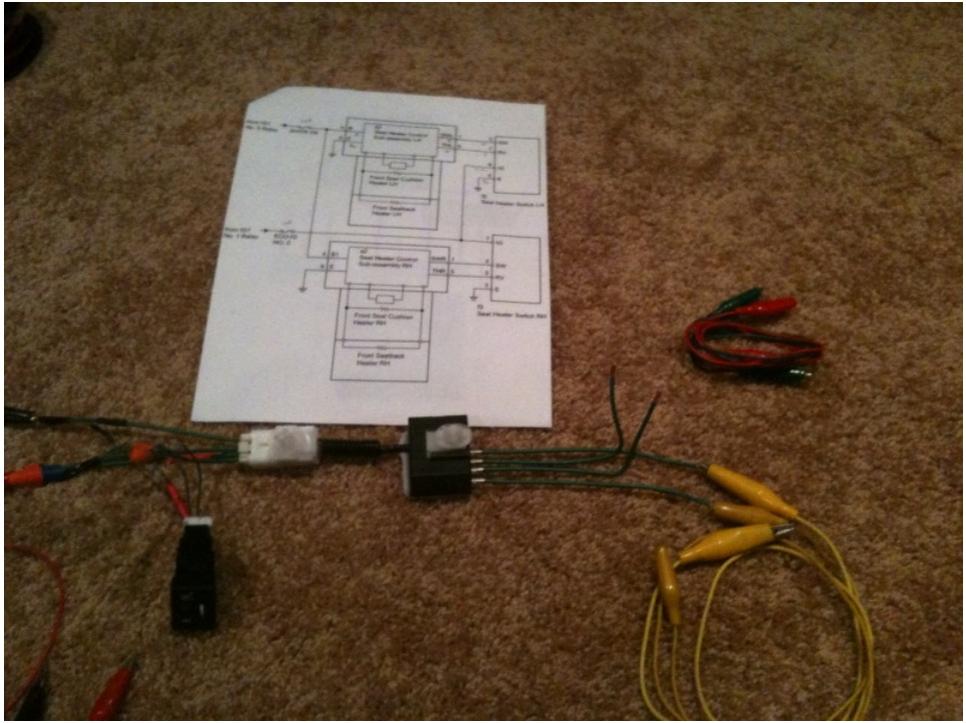

Just an update
I have begun testing the switch and sub-controller.
What I can tell so far is the switch and the thermistor work together to balance the voltage applied to the heating element.
It appears that when the thermistor's resistance reaches a value equal to (or a power of) the heating element the sub-controller shuts off. when the heating element cools down the thermistor's resistance changes and turns the sub-controller back on.
Depending on where you set the switch, full voltage (12VDC) is applied to the heating element. When the heating element heats up and changes the resistance of the thermistor the sub-controller is shut off.
So you set the switch position and the thermistor controls when the voltage is applied to the heating element in an on and off manner.
I am not 100% sure of this but this is my first pass. I am still waiting on my Wet Okole's to arrive.

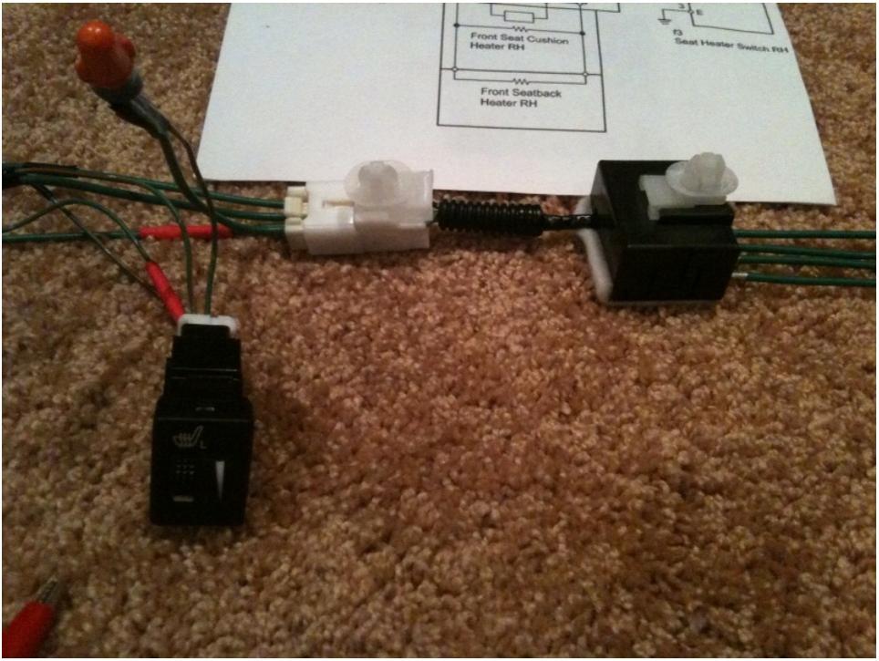

Sorry for the crappy pictures, but it's getting late.

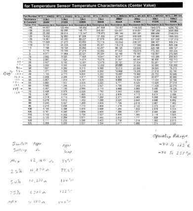

Ok, I am done with the Driver side. The system is working but I plan to test the "installed" setup for a few day to make sure everything is working.
The key to the Toyota switch and sub-controller is the thermistor.
Using a 20K Thermistor (Digi-key part # 490-4668-ND) you will get the following values per switch setting.
Switch Setting = Temp
Min = 95 Deg F
25% = 99.5 Deg F
50% = 104 Deg F
75% = 122 Deg F
Max = 145 Deg F
What this means is using this thermistor the sub-controller will turn on and off at these temperatures. (I ended up testing around 10 different thermistors until I found one that worked in the temperature range I wanted)

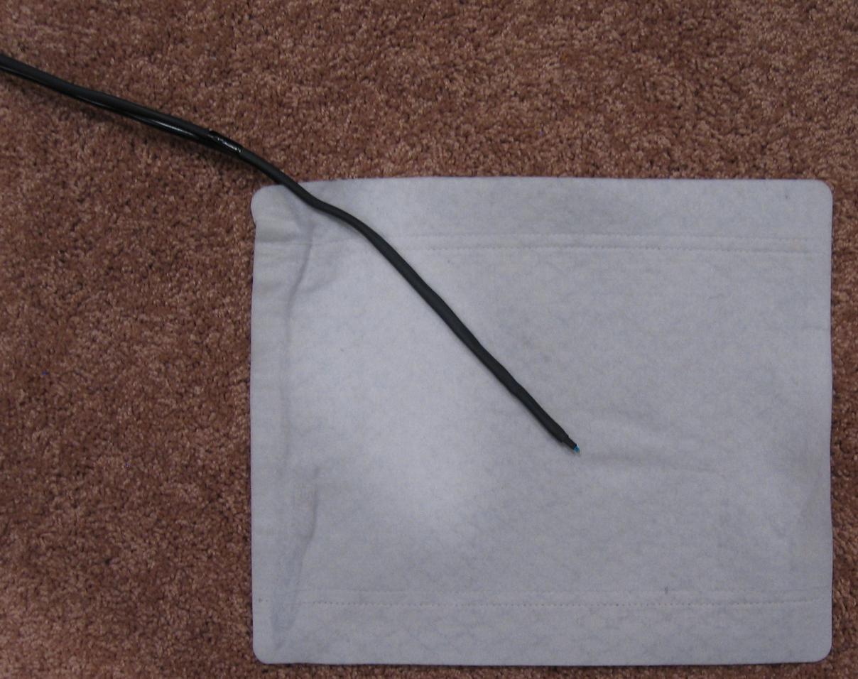

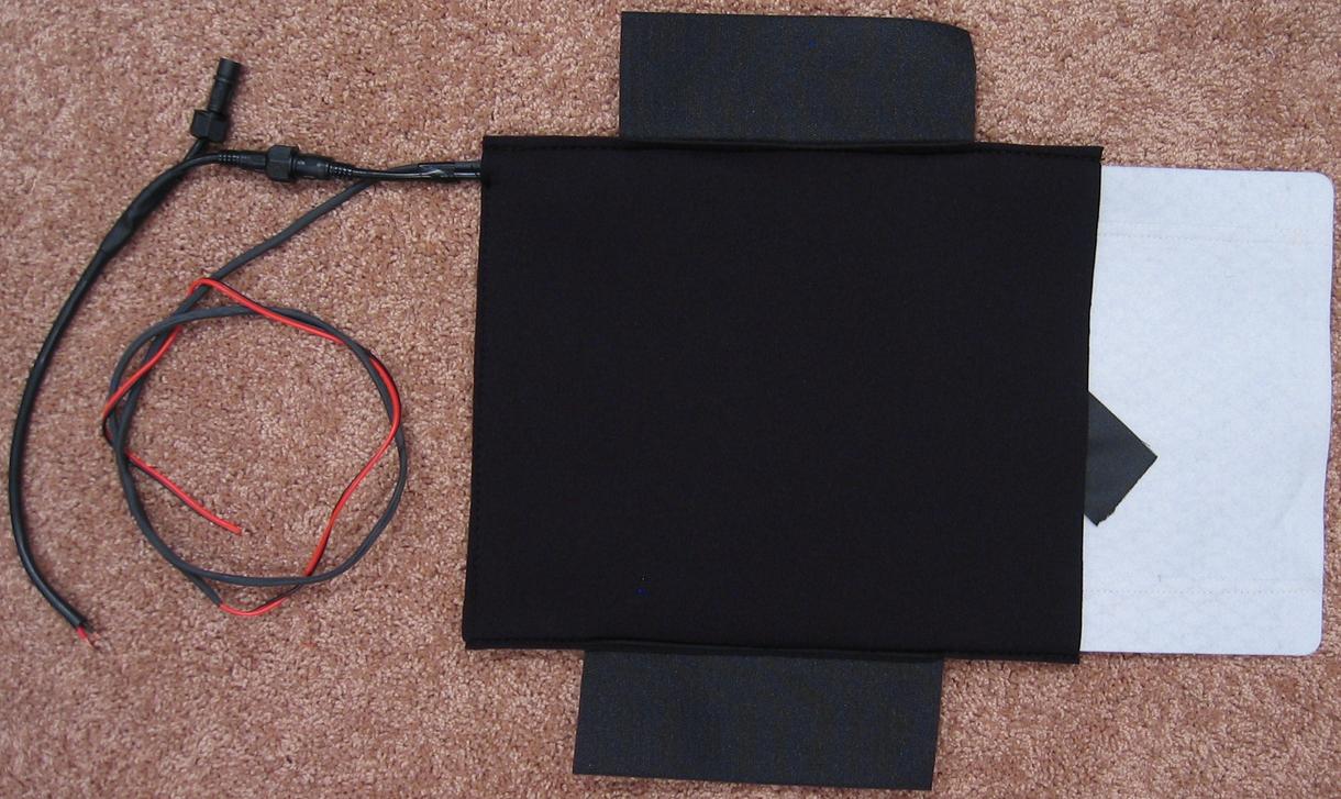

Part 2 (Thermistor build and install)

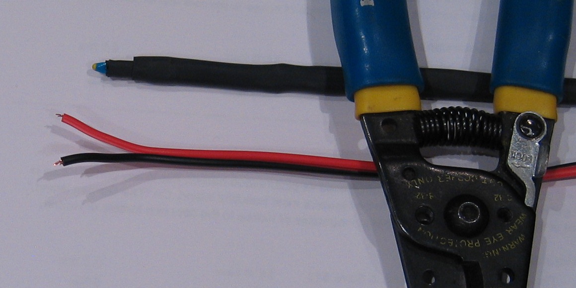

The thermistor costs around .71 cents, so buy a few if you are not good at soldering.
Parts needed for this step
20K Ohm NTC Thermistor - Digi-Key part # 490-4668-ND
20 AWG RED/BLACK AUTO ZIP CORD | AllElectronics.com
1 x - RadioShack® 4-Position Female Polarized Connector Model: 274-234 | Catalog #: 274-234
solder and soldering iron
Graffer or Duct tape
Heat shrink tubing

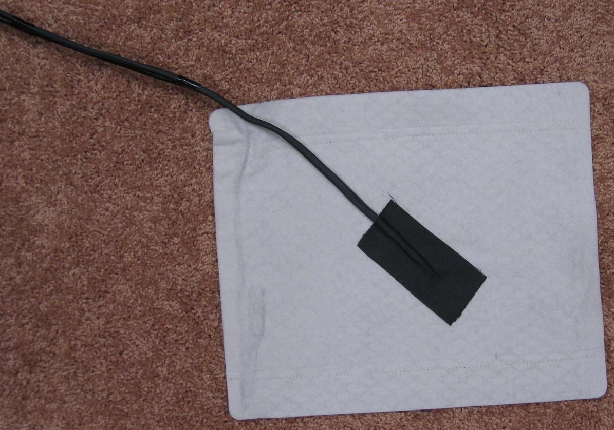

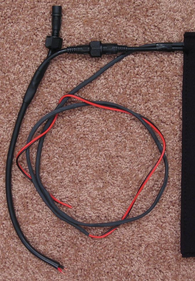

The thermistor needs to be soldered to 40" of 20 Awg zip wire.
The other end will be terminated into the center 2 pins of the 4 pin female Molex connector.
Once this is complete the thermistor gets taped to the back side of the "seat back heater" This places the thermistor between the Toyota seat and the Wet Okole heating element. (this way you will not feel the wire)

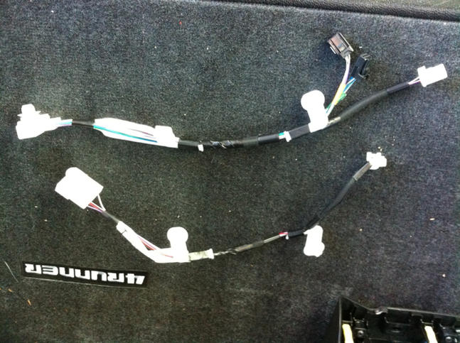

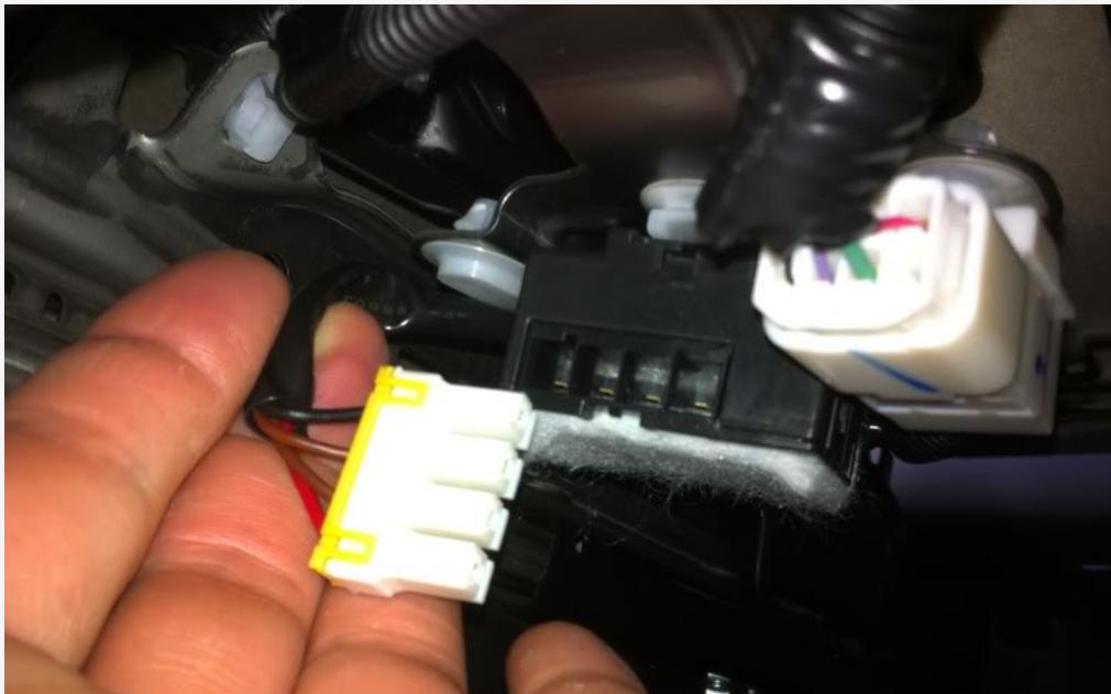

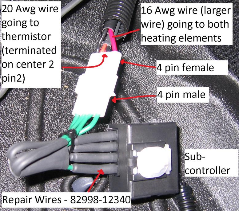

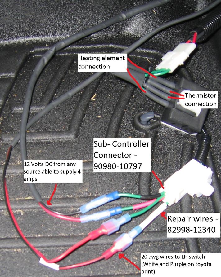

Part 3 (sub-controller build)
Parts needed for this section
1 x Sub-controller - 87501-60030
8 x Repair wires - 82998-12340
1 x sub-controller connector - 90980-10797
16 Awg wire
20 Awg wire
1 x - 1/4" Fully Insulated Quick Disconnects (10-Pack) Model: 64-3133 | Catalog #: 64-3133
1 x - 1/4" Fully Insulated Quick Disconnects (10-Pack) Model: 64-3131 | Catalog #: 64-3131
heat shrink tubing

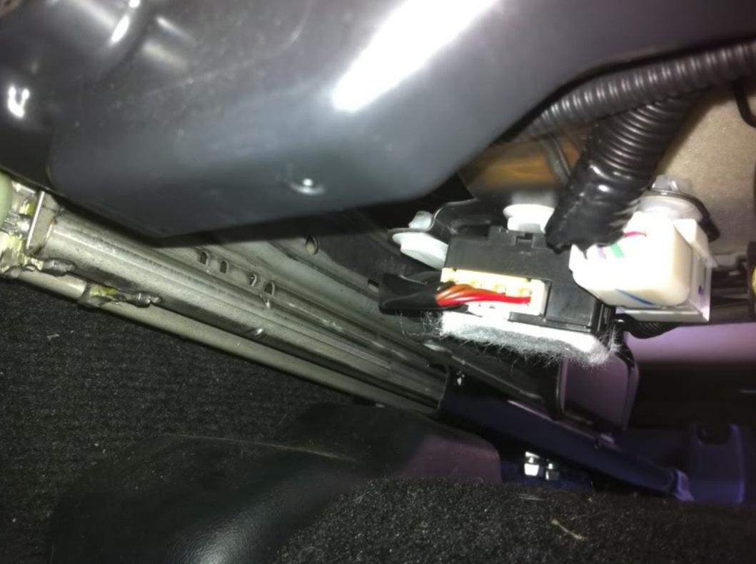

This section is just adding wire and connectors to the sub-controller, the pictures tell the story. Having the Toyota print on hand will help.
I was not able to find the connector for the one side of the sub controller (thermistor and heating element side). I had to used 2-3 layers of heat shrink tubing around the repair wire. Between the friction from the repair wire pin and the heat shrink tubing the connection is good.
This whole setup, once complete will be stored under the seat. one end of this setup goes to the seat cover (thermistor and heating element) the other end goes to the center console to connect up with the Toyota switch.

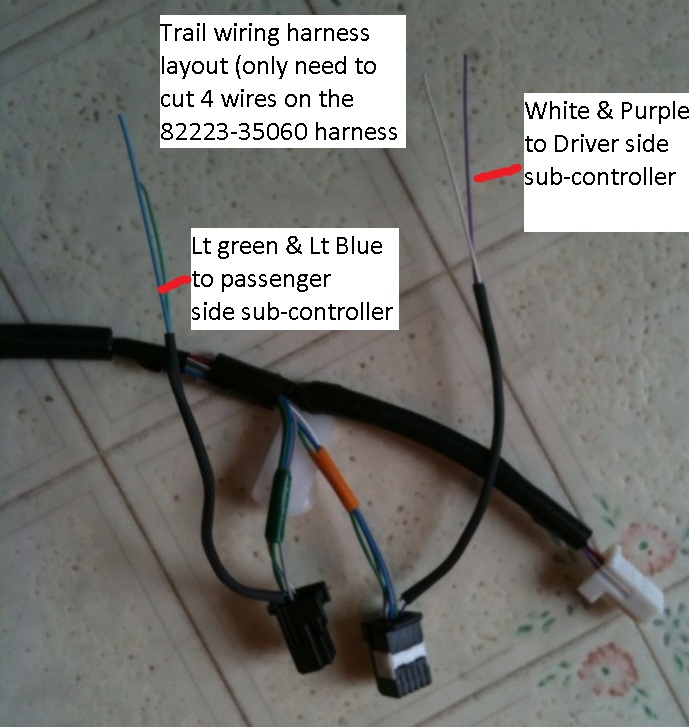

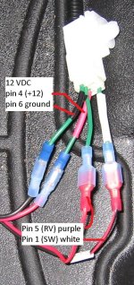

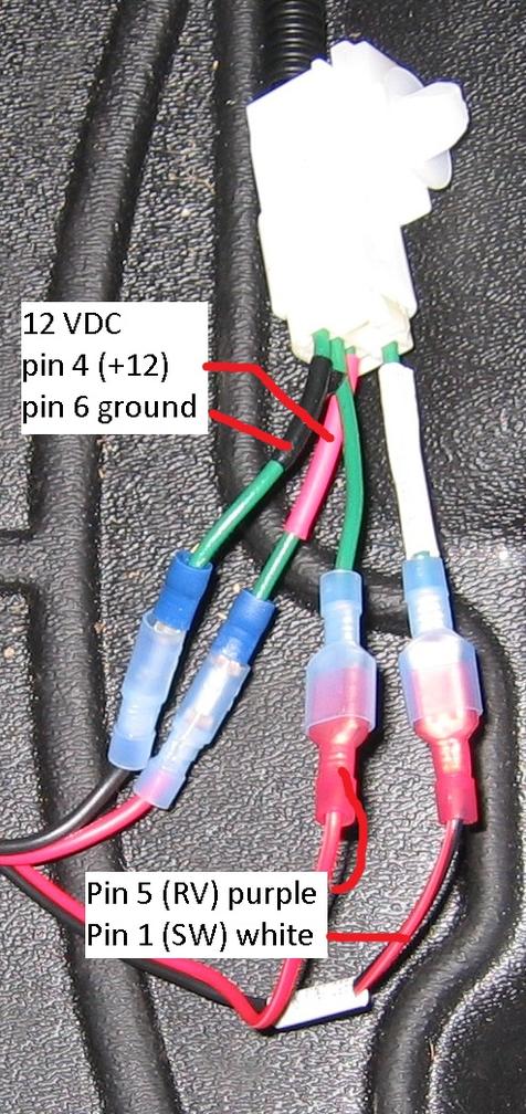

Part 4(a) Trail harness setup
Ok if you own a Trail you can use the whole wire harness - 82223-35060. You will still need to cut 4 wires on this harness. It seems like the Trail has a base harness system that is closer to the Limited than to the SR5.
I own an SR5 and had to cut all 12 wires and use just the connectors and wires (see next post).
If you own a Trail you will need to cut the white and purple wires on the driver side connector (10 pin connector, uses only 6 pins) and cut the Lt green and Lt blue on the passenger side connector (6 pin connector)
I would make the cut about 6 inches back from the switch connectors, this will give you enough length to work with when you need to connect them to 20Awg wire to go to the sub-controller under each seat.

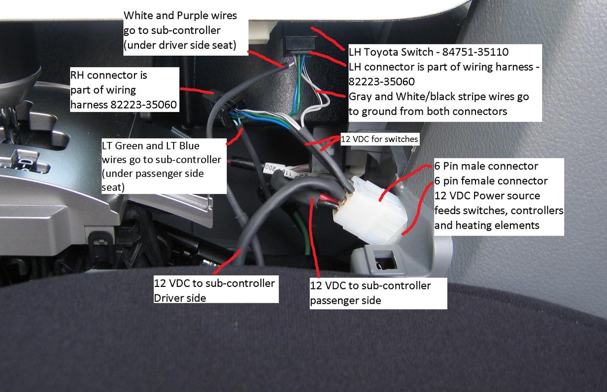

Part 4(b) SR5 harness layout and install
Ok, if you own a SR5 you will need to take the 82223-35060 wire harness and cut all 6 wires for the LH switch and all 6 wires for the RH switch and use them (the connectors and attached wires) to make up a harness.
When you cut the wires make sure you cut at least 6 inches (or more) back from the connectors so you have wire to work with. For this setup I would keep your stock harness lead (the one that came with your truck and powers the rear window switch) in place.

The wires from the 82223-35060 harness are very small and when you try to crimp them they can easily fall out. I recommend soldering them before you crimp them into the 6 pin radio shack connector. In fact any crimp connection you make I would solder to help provide a good electrical and mechanical connection.
In the following pictures my power source is from my center console. I ran a 20 Amp (12 Awg) line from the battery to my center console to run an inverter so this is where I got power from. The 6 pin radio shack connector is used as a power distribution point, 3 pins are ground and 3 pins are +12VDC.
This system (using Wet Okole heated seat covers and the Toyota switches and sub-controller) draws around 7 to 8 amps. Right now I only have one switch installed so I am drawing 3.5 to 4 amps right now.
In the pictures below the power runs are done with 16 Awg wire, the control wires (from the 82223-35060 wire harness are 20 Awg wire.

Ok the last step is to place the sub-controller under the seat.
This picture comes from nashman69g, (thank you) it's a picture of the sub-controller under the driver's seat.
The second picture is of the connector I was not able to find.
