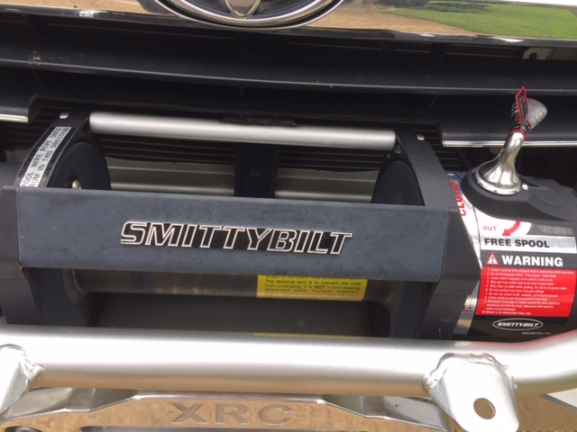

I mounted mine inside engine bay RH side, mounted controller plug recepticle in grille.
Depending on winch clutch lever location you will need to clock it, cutting grille cross bar is necessary.
AOR bumper & 96-98 grille works without cutting grille.

Okay, thanks. I was wondering about having to cut the grille. Based on my measurements, there is no way to get the winch in there w/o cutting the grille. I have the same grilles as yours shown.

Amount you have to trim going to vary with winch used, Smitty one of smaller ones.
