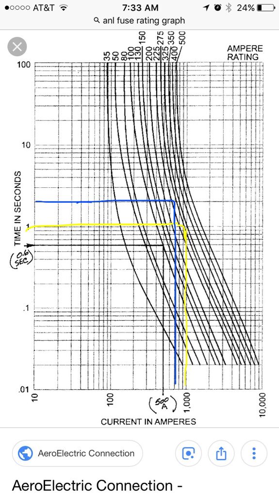

Here's a great ANL fuse time vs amp graph
And for all this new info I've gathered, I'm downsizing my winch fuse to a 300 amp. That should provide normal winch operation (since 435 is ABSOLUTE MAXIMUM which is going to be a rare event) and in the case of a dead short (releasing 800-1000 amps from my battery) should blow that fuse in about 1-2 seconds, which is significantly less likely to hurt my battery.

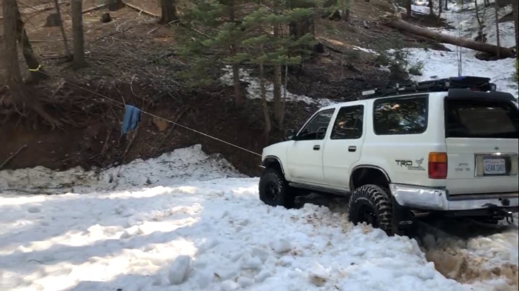

It's satisfying to spend a lot of time and money on a mod AND use it! First trip out with winch & bumper, and I used it.
My system worked great: popped the hood, turned on master switch for winch, connected control wand to interior port, ran out and attached winch cable, and ran the winch while idling in 4Lo and it pulled it right to solid ground. We didn't go much further as the entire trail was icy slushy snow and only getting worse.
But the winch and electrical additions worked great to pull me out. Nothing got hot or sputtered at all for about a 30-45 second continuous pull.

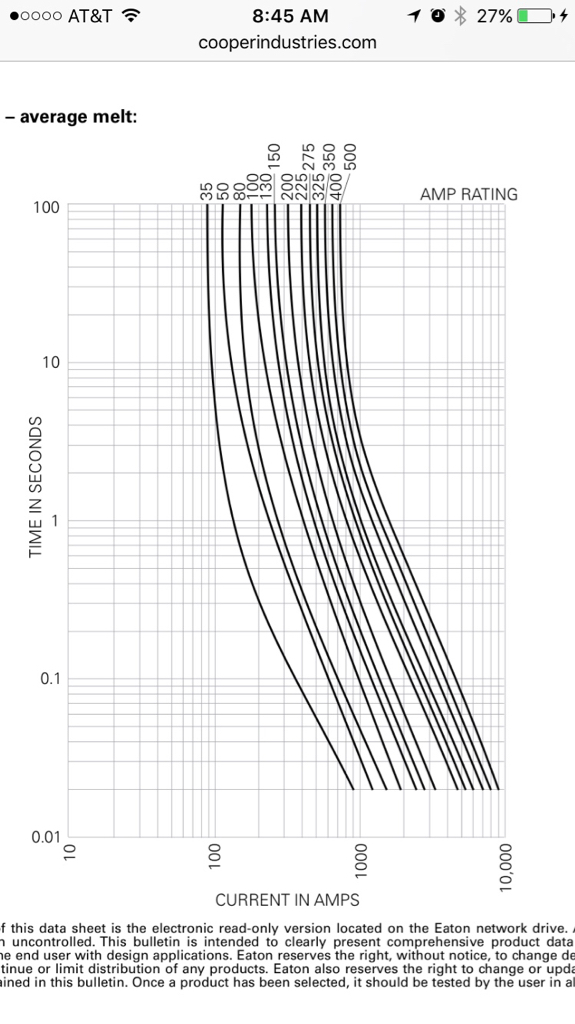

This is my understanding as well. However, different types of fuses blow differently. So that aspect needs to be considered. Here is a chart for an ANL style fuse for example:
Their actual amperage blow amount exceeds its written rating by quite a bit. Almost double for multiple seconds. My thought process was this: how many seconds are you going to be maxing out a winch? And then when you start thinking about how long 5 seconds actually is, you may realize it's unlikely you'll max it out very frequently for that length of time.
The other thing to consider: an electric motor will pull whatever amps it needs to do the work. Period. It will literally destroy itself or burn up wiring to accomplish the job. (Watts=amps X volts) so however many watts of power it needs to consume for the job will dictate the amount of amps it pulls. I've sized my fuse so that the fuse will pop if I'm nearing the amperage rating for the winch. Meaning: I have a telltale if the winch is at or near its upper limit. So it would be unlikely I would suffer catastrophic electrical opponent failure.
I'm also not a hardcore wheeler. I don't do crazy rock crawling stuff up insane hills. So I know that my winch won't be having to do an extreme amount of work repeatedly. Winches don't come with fuses for a reason. I understand not putting one in. I would still suggest a big fat kill switch however. The idea of having a winch or its solenoid short out and continuous run with no way of stopping it is terrifying to me.
After looking at the chart I'm not sure what to say really.
It looks like a 35 amp fuse will allow over a thousand amps to flow before burning out so where do you draw the line?
