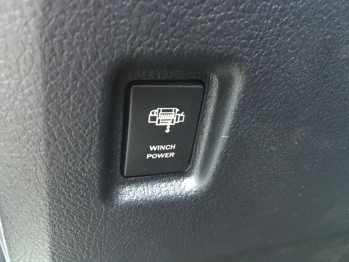

A winch for me is a JIC thing so I did it like this.
P1010953_zpsn11vz5cr.jpg~original
here's the old truck...not a great pic...right above the trailer controller

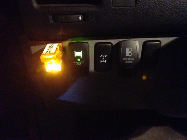

[MENTION=47340]Titanpat57[/MENTION] Thanks! Not my style, but those are the pictures I'm looking for.
[MENTION=80048]SecretSquirrel[/MENTION] I know about OTRATTW's rockers. I'm more interested in how/where you mounted the switch. Most of their switches aren't momentary switches.
[MENTION=78273]Jeremy556[/MENTION] What model winch is this from? I am more interested in a panel switch.

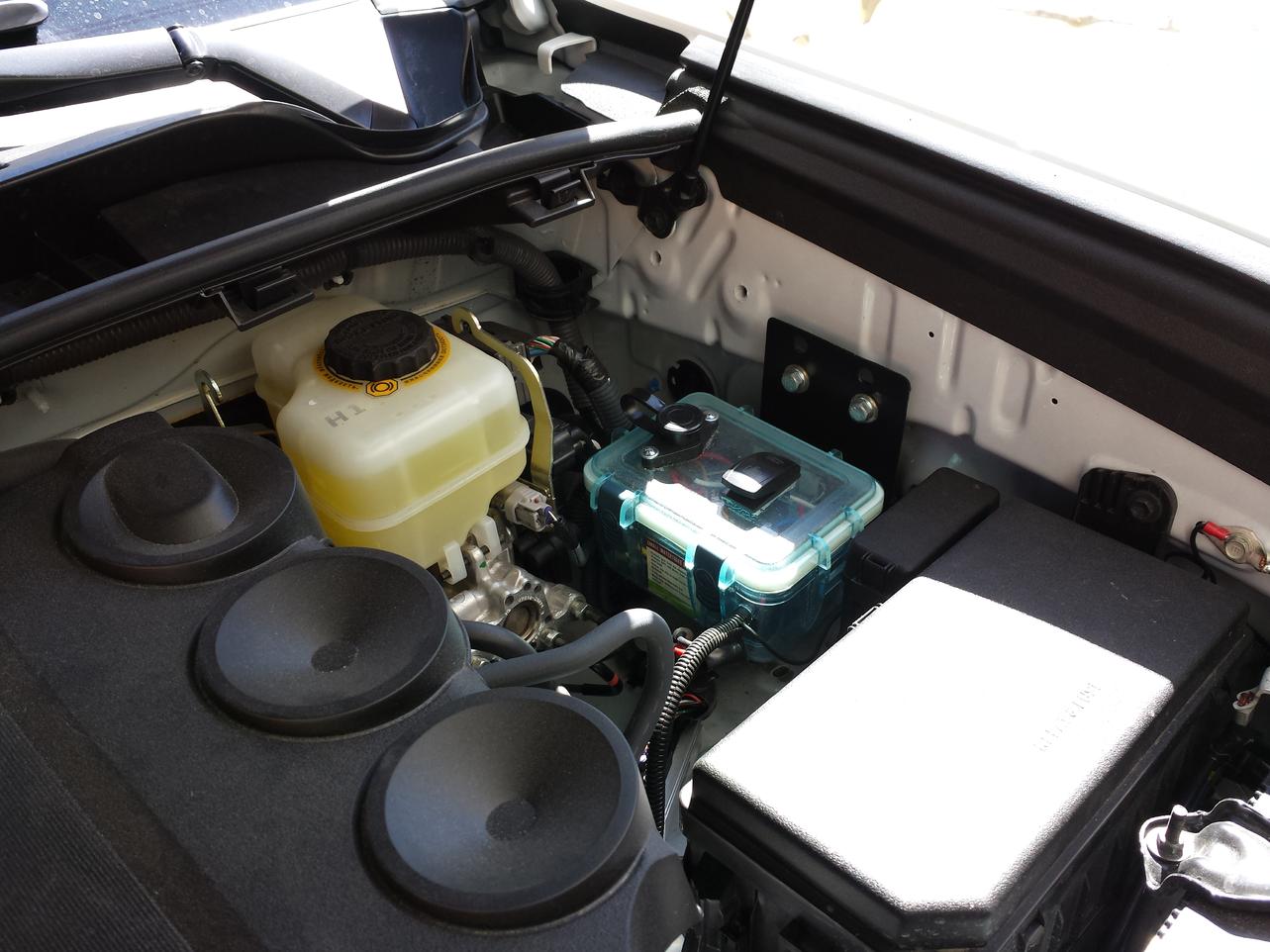

I put the plug for the wired remote in the engine bay. I really don't see any reason to run wires into the cab. Reaching down to the dash while you're trying to drive and manage a winching situation is not convenient. With an automatic transmission- it's doable, but it's just not where you want to run a winch from. A wireless controller with a plug in the engine bay is an easy and convenient way to go. I would not remote the solenoids though. Leave those on the winch. Just remote the switching. Inside that box you see is a fuse block with a couple fuses, a master relay and a master on/off rocker switch and a plug for the wired remote on top.

[MENTION=137555]Sleeter[/MENTION]: I like that idea, but how are you operating the winch in and out?[/QUOTE]
Wireless remote- IMHO way better than a hard wired control in the cab. Best option would be to have both a hard wired and wireless.

Does anyone know of a rocker switch that fits in the OEM holes and look more OEM than the switches from OTRATTW?
Check out the NSA option from Trail Toys. [MENTION=137995]SMKYTXN[/MENTION] Trail Toys
