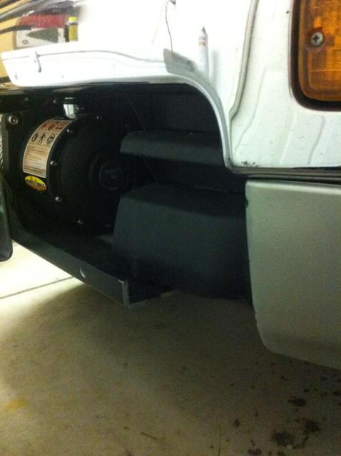

Well I think there are many out there that have been looking for this, or how to do this for a long time now.

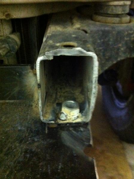

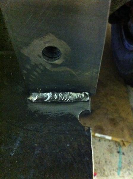

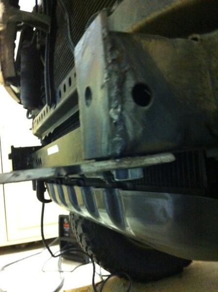

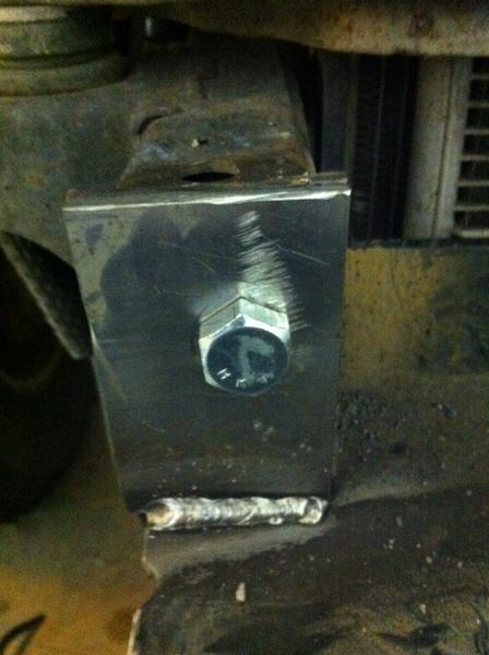

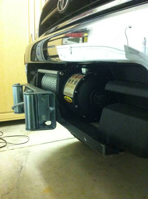

I started out with a X20 Smittybilt 8k winch,
Got a winch mounting plate at harbor freight for $33. (had a coupon)
Then bought some nuts and bolts from Lowes to mount the plate.
There were some minor modification to the winch plate as well as the front frame rails but all in all it fit well and seems to be really sturdy and solid.
Here are some pics, let me know what you think.
jmildoc-albums-my+98+limited-picture15785-cut-frame-ends-off-drilled-hole-bottom-welded-nut-mount.jpg
jmildoc-albums-my+98+limited-picture15787-welded-plate-only-winch-plate-bolted-mounting-plate-frame-rail.jpg
jmildoc-albums-my+98+limited-picture15791-fairlead-going-replace-low-profile-one-keep-one-spare.jpg
The bumper looks crooked but its really my grill that is crooked, because the tab that mounts the passenger side light is broken, hope to remedy that soon.
Thanks guys! Still not quite done. Still want to change the fair lead and mount some lights down there to take away from how far it sticks out.

I dont have any step by step plans, but I can add them to the top of this thread if you want, you are welcome to ask me any questions about what I did and how. Here is a link to the winch plate that I used, I did do some modifying of the plate itself too. I will add that to the top of the thread. Universal Channel Winch Mount

That would work for me, took me about 4 hours all by myself to do and less than $50 in supplies including the winch plate.
How's the strength up and down mostly? Seems like the only support for the rollers is the thin winch plate.
The winch plate is actually pretty thick, thicker than 3/16'' steel. If you look at most other winch plates on Jeeps and such it is the same thickness. They hold up well so I think this should to. If anything were to break I think the fairlead would be the first to go, that is why I plan on putting a low profile one on and keeping this on for a spare.

Here's a couple more pics. Also where the black part of the valance is left is where I want some 6" lights to go.
