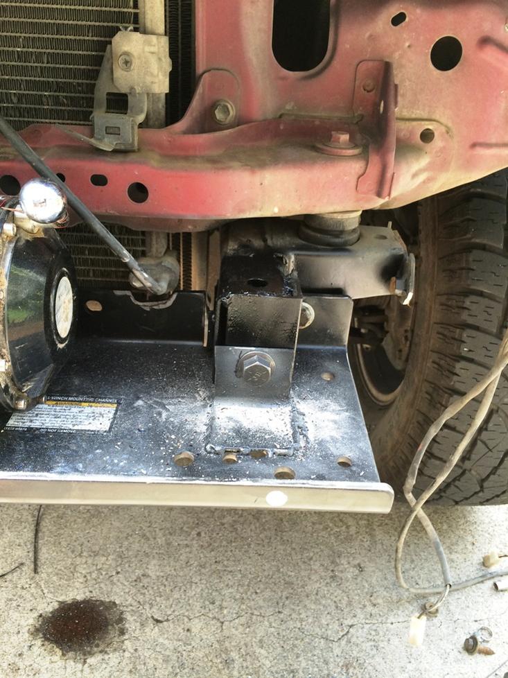

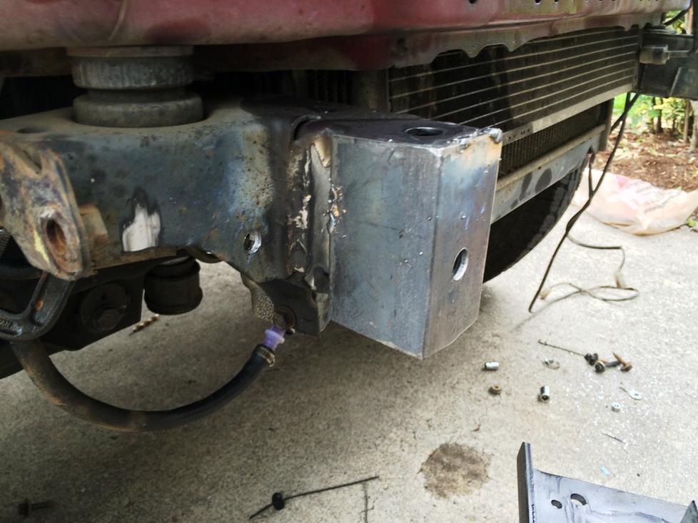

Per side when I'm done I should have one grade 8 bolt in the welded end-cap with a welded and gusseted stand-up on the winch tray. One grade 8 bolt from the side, like yours. The small grade 8 bolt into the frame body mount gusset (pictured). Lastly, the two grade 8 bolts that hold the tow hooks will pass through a welded extension to the winch channel.
I'm really trying to avoid a permanent mount so I can still disassemble the front clip when I do timing belt and water pump. You think this still leaves weakness?
I put atleast two 1/2'' welds top and bottom that i could grind off if needed. I can jump up and down on mine, i have pulled out full size trucks, trees, myself. never moved even a little. I am confident in the set up.
The valance has to be cut away just about all the way.

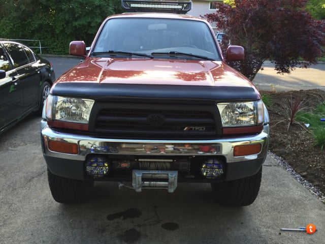

I'll update then process later but here is the finished product. I did end up welding to the frame too.
The oil is from me switching out the trans cooler....
Ended up with 8 - grade 8 5/8 inch bolts plus a 1 inch weld on the trailing arm of the plate to hold it. It's over-kill really but I like the looks.

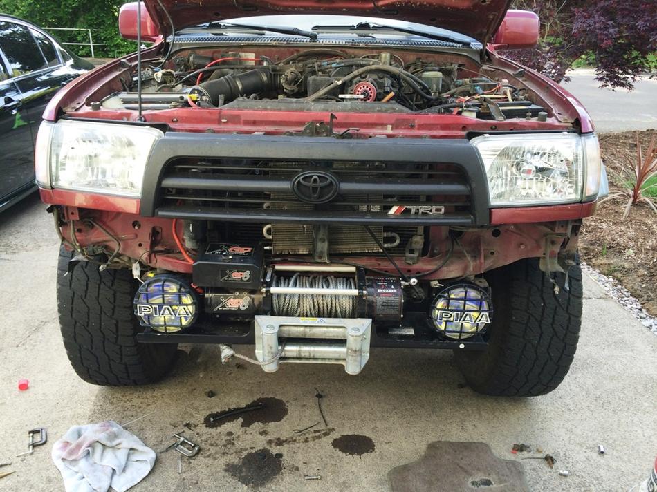

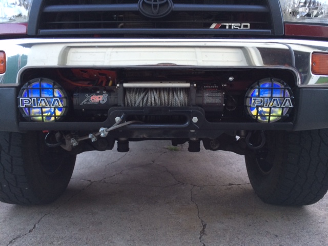

Not done yet but here is my start.
Started with stock - added Badland winch plate. Cut tabs and mounted with 4 grade 8 bolts. Tomorrow I'm welding the end caps and a 90 degree to the plate. Also trying to fit the Piaa's. This took me 4 slow hours and I feel like I should be done. Enjoy
That looks awesome. Which PIAA's are those? I'm thinking of doing similar, but I don't have a great budget for the lights.
Those are an older pair of Piaa 520's. They fit like a glove in there, but you could get away with any 6" light probably.

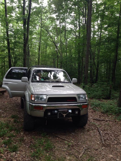

Oh by the way. The hawse lead looks nice. I just snap a plate on with mag light holders riveted to it to the current fairlead on mine. Here is a pic from the weekend on my own personal trails.
That looks great! I've been running without a front plate...which is a no-no in my state so I'll have to add something like that too.

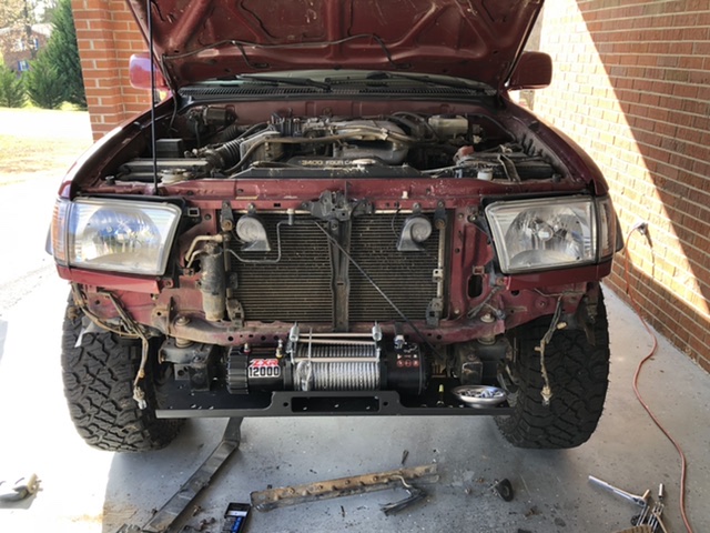

Been looking for a reasonable winch mount for my 96 - this is it! Winch arrives next week (HF Badlands 12000) with the mounting plate. Can't wait to get after it. Thanks for the great post and great pics!

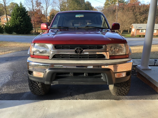

I sure am glad to see that this is still helping people to this day. I have since moved onto a Tundra that I have lifted and put 20's and 35's on I do miss my 4runner sometimes cause i could just run through the woods with it if i wanted. I had a Honda Pioneer 1000-5 for a little while as my 4runner replacement but sold it cause we didnt use it much. Now however I got back into a very capable suv and got my wife a 2016 Lexus GX460, not sure if we will take it into the woods just yet however we do have many plans for it in the future. look forward to seeing that badlands 12000 mounted up.

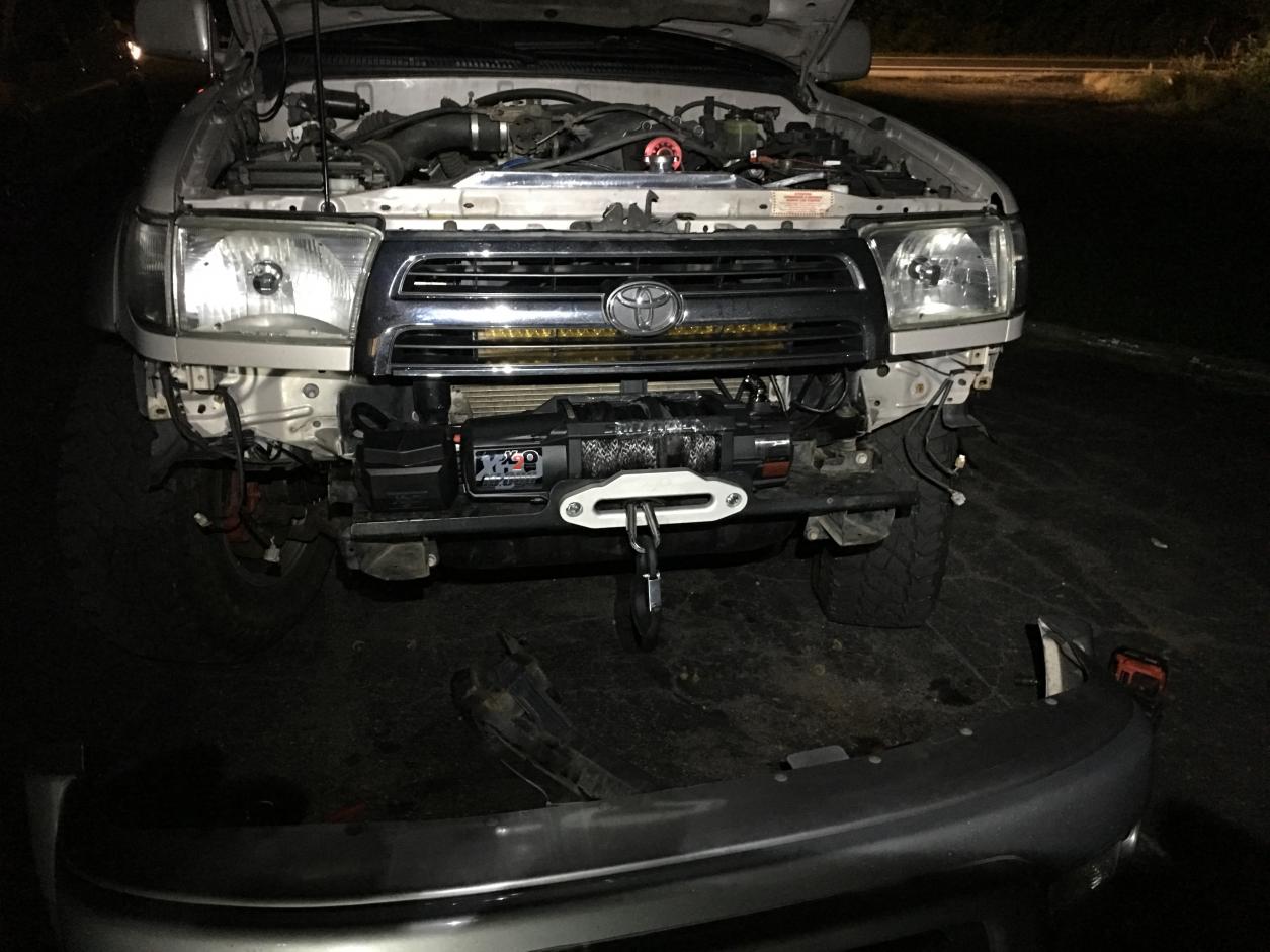

Installed hf 12000 lb today
Looks like the hf 12000 lb will fit also

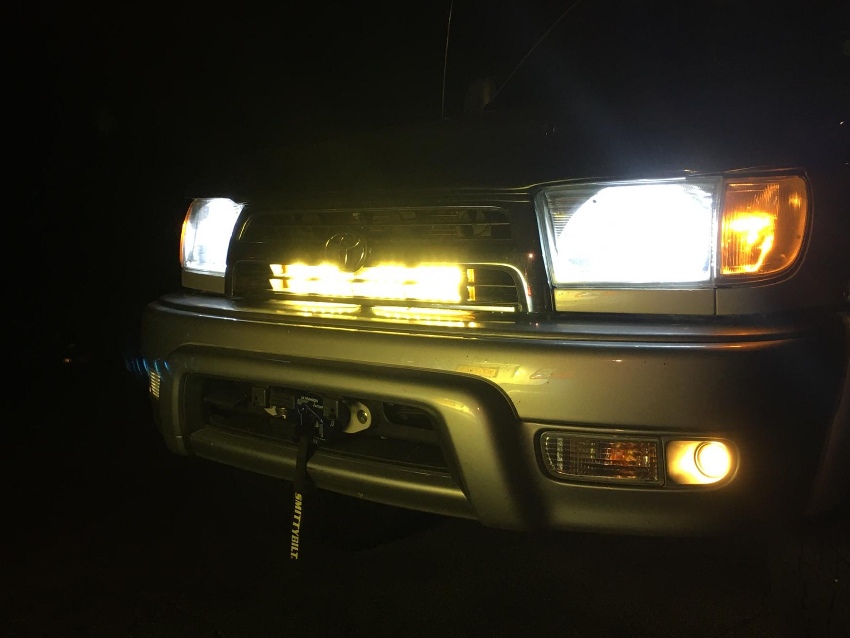

kind of answering my own question. seems bodean123 recently did this too in his post....what did you do to your 4runner today.

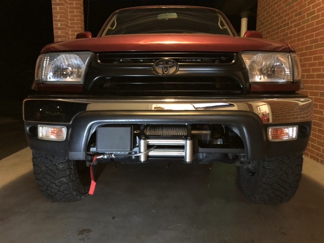

for those that dont want to add a new bumper, this looks like a nice option and a clean look

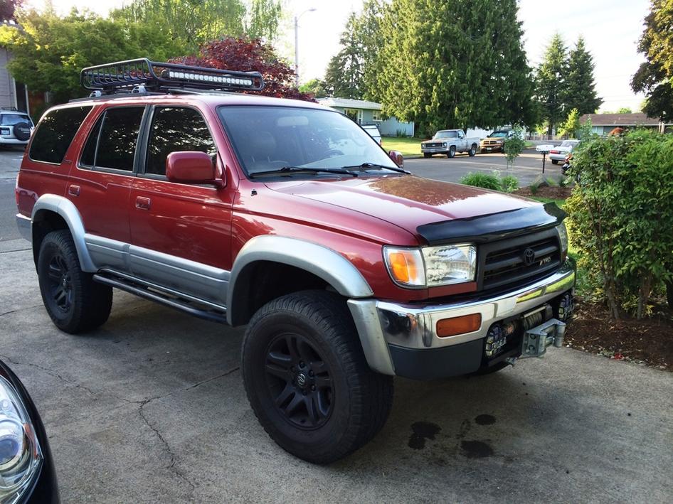

I did mine last summer...
