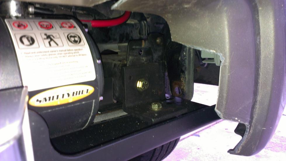

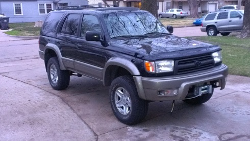

Finally got around and did mines. Setup is 99 4runner X20 8K winch. Did exactly what jmildoc did but i have no welder. So I bolt up some thick steel angle to the factory frame end caps. Use grade 8 bolts on each side. Thanks for all your help jmildoc!
Your bumper is only held in with 2 bolts. You need to add some more bracing. Vibration and time will cause your bumper to tilt and fall forward...
there's actually three ,one more underneath bolted to the frame, probably get it welded later with more support thanks

UPDATE, Used my winch a few weekends ago to clear some trees from a path from straight ahead, and the while strapped to the tree it snapped it in half, probably been down for about a year or so and it was about 6" in diameter, so pretty good,
basically just posting this to let everyone know that everything held up very well.
UPDATE, Winch is still holding up great! Pulled out many people this winter with it, from cars to full size trucks even a 3/4 ton dodge diesel. Yep still good, probably going to upgrade to some synthetic line and a hawse fairlead this summer though.

I wouldn't want to have to pull to hard on that. The factory frame is pretty flimsy at best. There's no cross brace up front. That's what normally gets welded in and you winch bumper would mount to that. And it's sitting very low, not good for an approach angle. Just my $0.02. It's definitely better than no winch at all. Good job man.

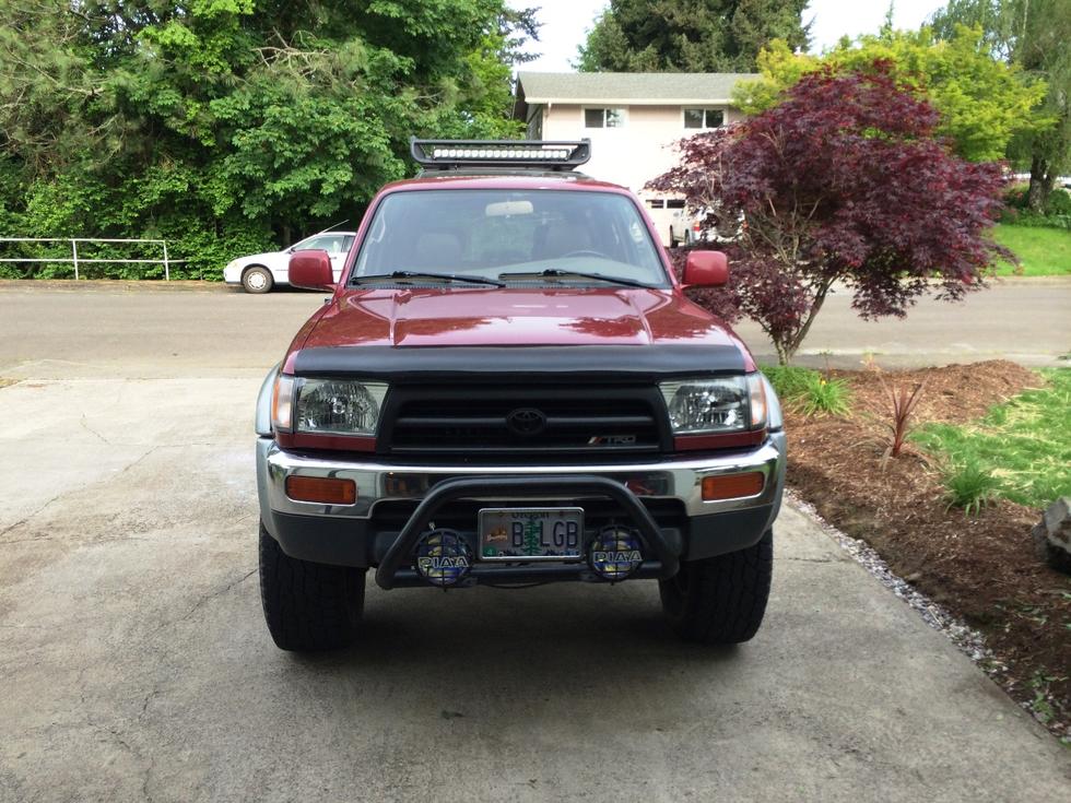

My turn!

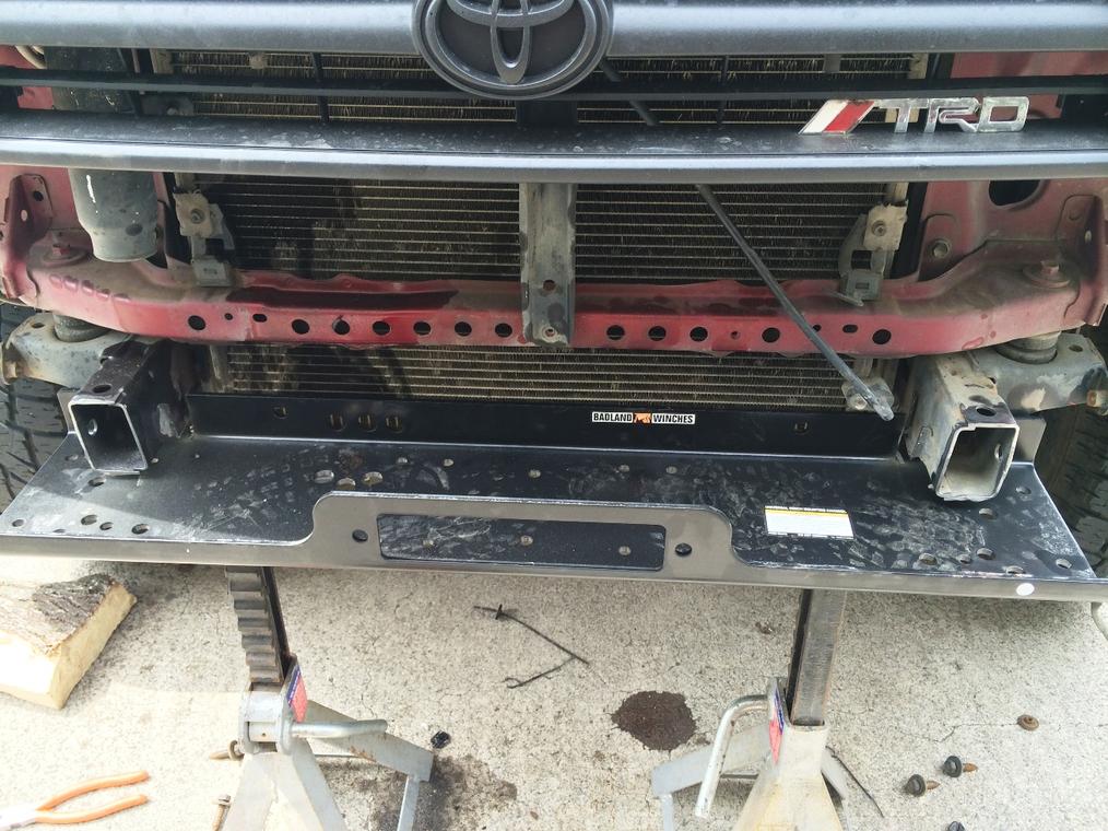

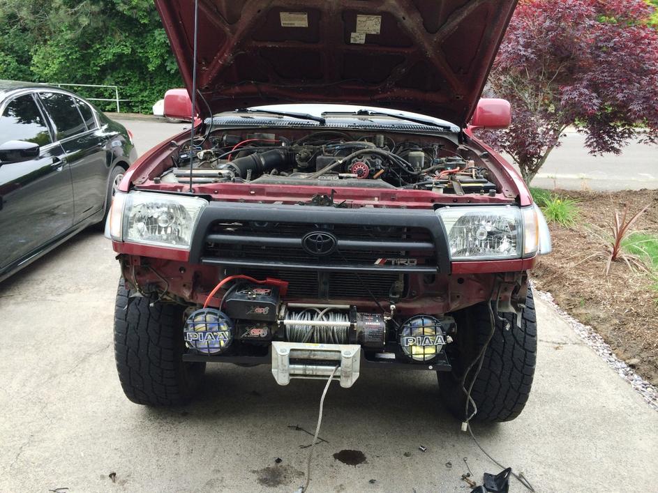

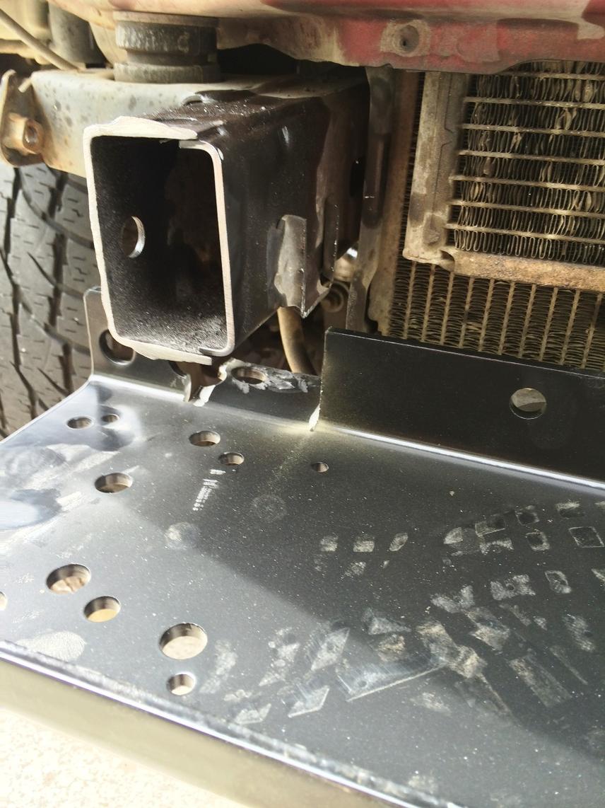

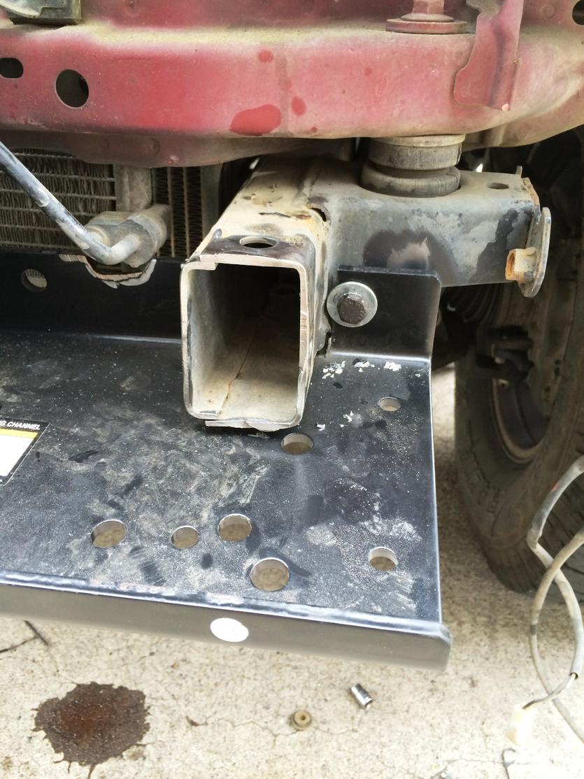

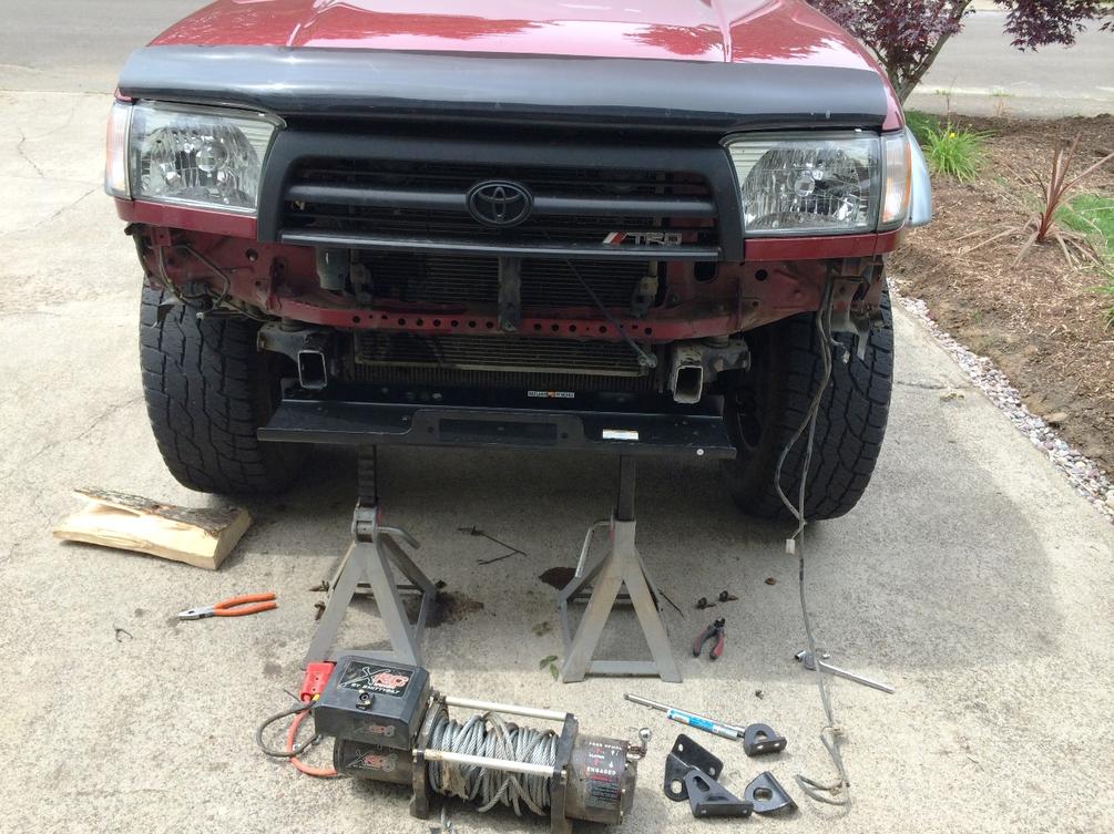

Not done yet but here is my start.
Started with stock - added Badland winch plate. Cut tabs and mounted with 4 grade 8 bolts. Tomorrow I'm welding the end caps and a 90 degree to the plate. Also trying to fit the Piaa's. This took me 4 slow hours and I feel like I should be done. Enjoy

Now if I can just figure out where to put my trans cooler again and how much plastic valance to cut out. Oh and where to mount my skids again.

Looks good man! Needs some more stability for sure. But it's coming along.
