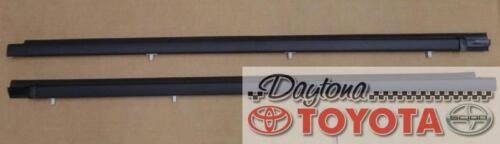

Outer Window Weatherstrip Belt Molding is what you're looking for.
Older the model the less supply & demand i.e. higher price w. less aftermarket availability.
68161-35010 Weatherstrip FR
68162-35010 " " FL
68163-35010 Weatherstrip RR
68164-35010 " " RL
68290-35020 Weatherstrip Assy (rear gate)
Front: OEM TOYOTA 4RUNNER EXTERIOR WEATHERSTRIP SET FRONT 2 WINDOWS ONLY 1996-2002 | eBay
Rear: OEM TOYOTA 4RUNNER EXTERIOR WEATHERSTRIP SET BACK 2 WINDOWS ONLY 1996-2002 | eBay

I did mine not that long ago. Yeah they are pricey online, approx $50 per door. I did the rear hatch one as well and that requires taking the panel off.
Just go get one at the junkyard, these things don’t really wear out that often and are always pretty expensive new. I put a product called gummi pflege stift on the weather stripping on all my cars and it seems to really rejuvenate it and keep it in nice shape
