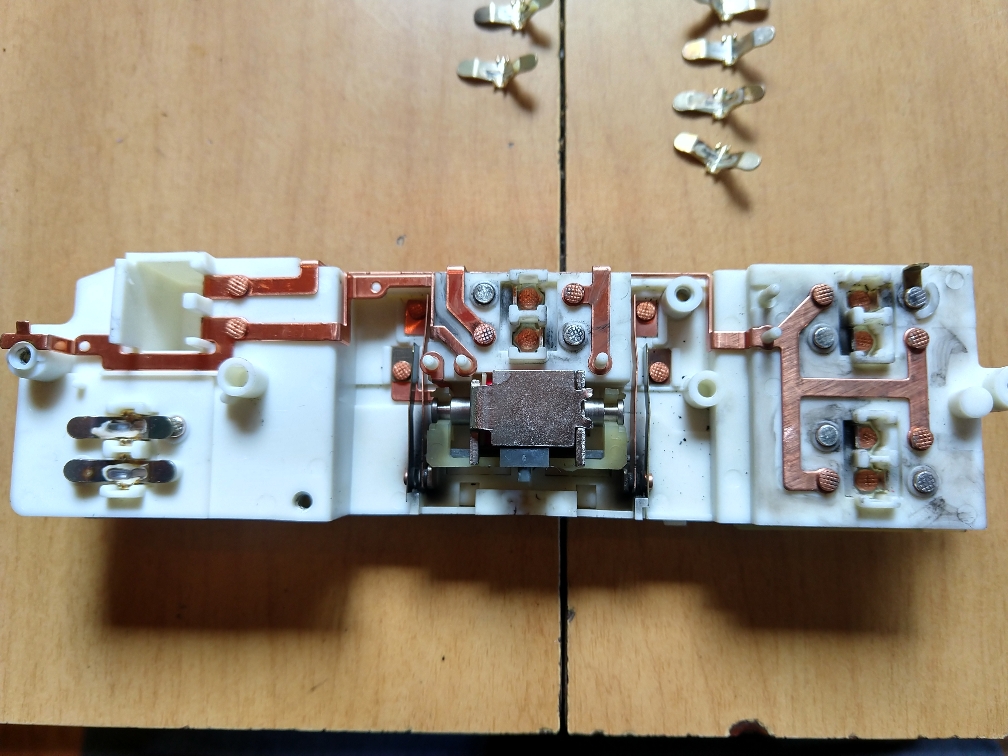

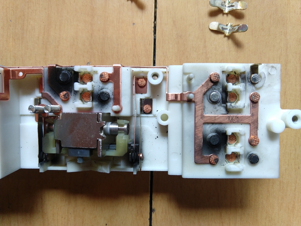

After watching this video I took my driver switch box apart and found that the contacts were all carboned up. Cleaned them up with some sandpaper and electrical contact cleaner and it seems to be working again. There are some finicky bits in there for the auto down window control and the window control lock button but I was able to get it all back to working order.

Here's a before and after.
