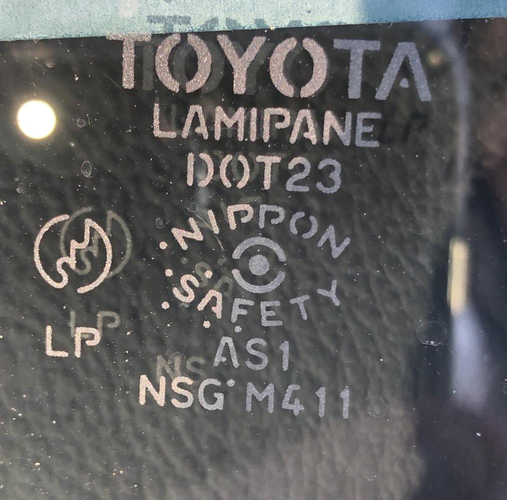

Made by Pilkington?
My label

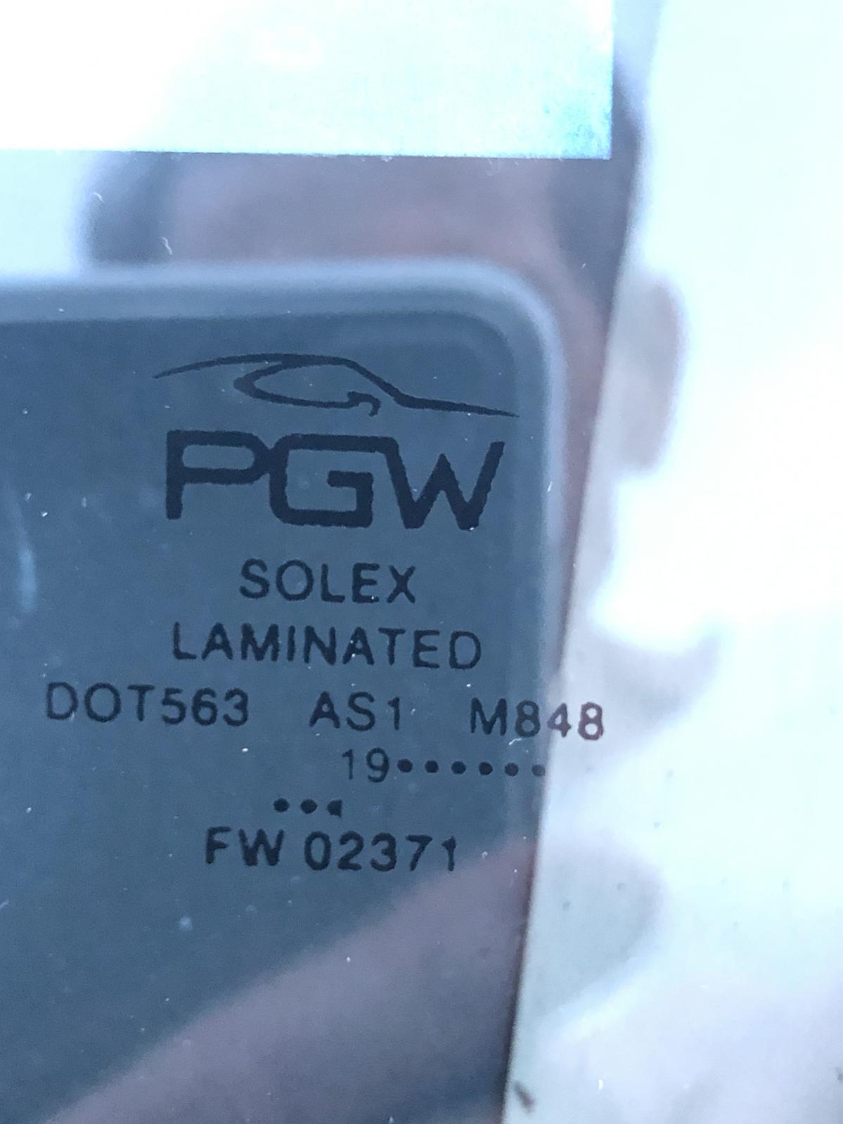

So, after over-thinking this I got the repair shop with the best rep in my area to do mine. It is a GlassDoctor franchise. I'm not sure they are healthy in hindsight but here's the net:
The owner said that Pilkington's quality fell off [maybe after acquisition?] and that OEM's do not use their glass. Their reco was/is PGW [PPG], which is used by some OEM's. [there's a brief PGW note here: ]Page not found | Windshield Surgeons Auto Glass
I think it is tight - I don't hear any noise I didn't hear before - as our beloved 4th Gen's are a bit air-noisy anyway. The optics are very good. What isn't good is the color. They either didn't think to even check the codes and explanations of tint/shade or it isn't available.
SOOOOO.... the question: how do I know what color/tint I actually have all around, and whether they goofed, or it is simply impossible to match here 14 years later? Supposedly the Color is encoded in the M___ code, which in this case is M848. The labels on my other glass, in this case the rear hatch, it Toyota Temperlite and code M2L3. Appearance-wise, as you would expect the new front shield looks 'clear' in indirect, and dull daylight, and changes in really bright sunlight - sort of greenish, but is at least a couple of shades lighter than the sides/rear which are notably tinted but not as much as our '13 Lexus RX.
Help me if you can.
