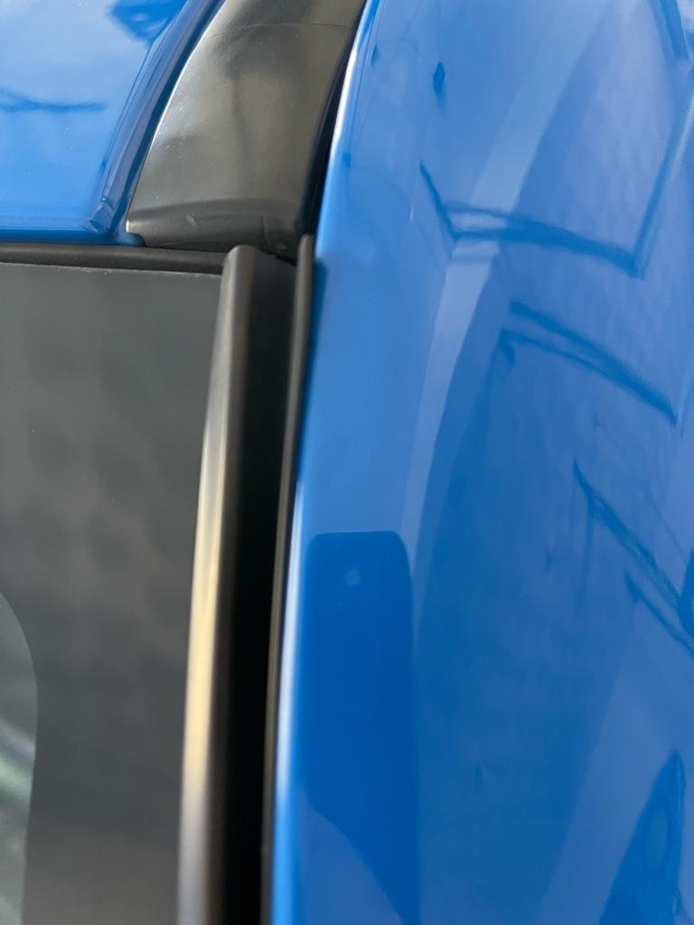

Is this the piece you guys are talking about? I had to have my windshield replaced this past spring and they did a good job, but now this trim piece keeps popping out at the top corner of the windshield. I push it back in but it keeps working its way back out. Could I pull it out and put some silicone seal behind it and re seat it or should I just have the windshield company come out and replace it? I have a lifetime warranty on the work.
yea i'd pop that corner out, use some black rtv and a piece of tape to hold it in place over night. its just a cover so the windshield channel/butyl is covered up and not visible.
