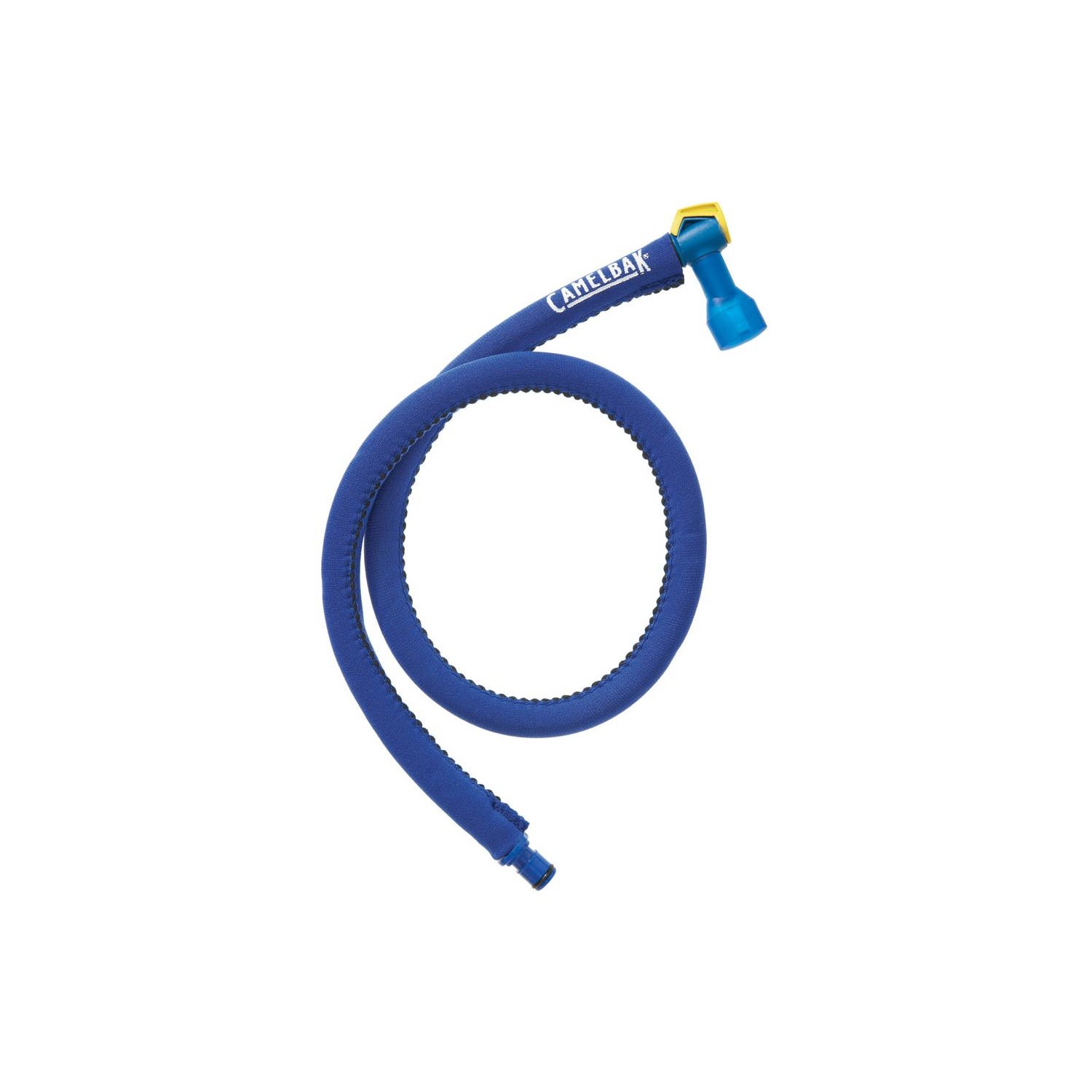

I really think you have some residual water in the line somewhere that froze up. I'm in NJ too and have the same temperatures going on and have not had any problems with my washer. I have an LE with the insulation on the hood, but I would think that would only make the situation worse as the lines run between the insulation and the hood, reducing any heating effect from the engine. I use the Rain-x -25 fluid, and always top it off before I go to the dealer for service so they don't add in anything else.
