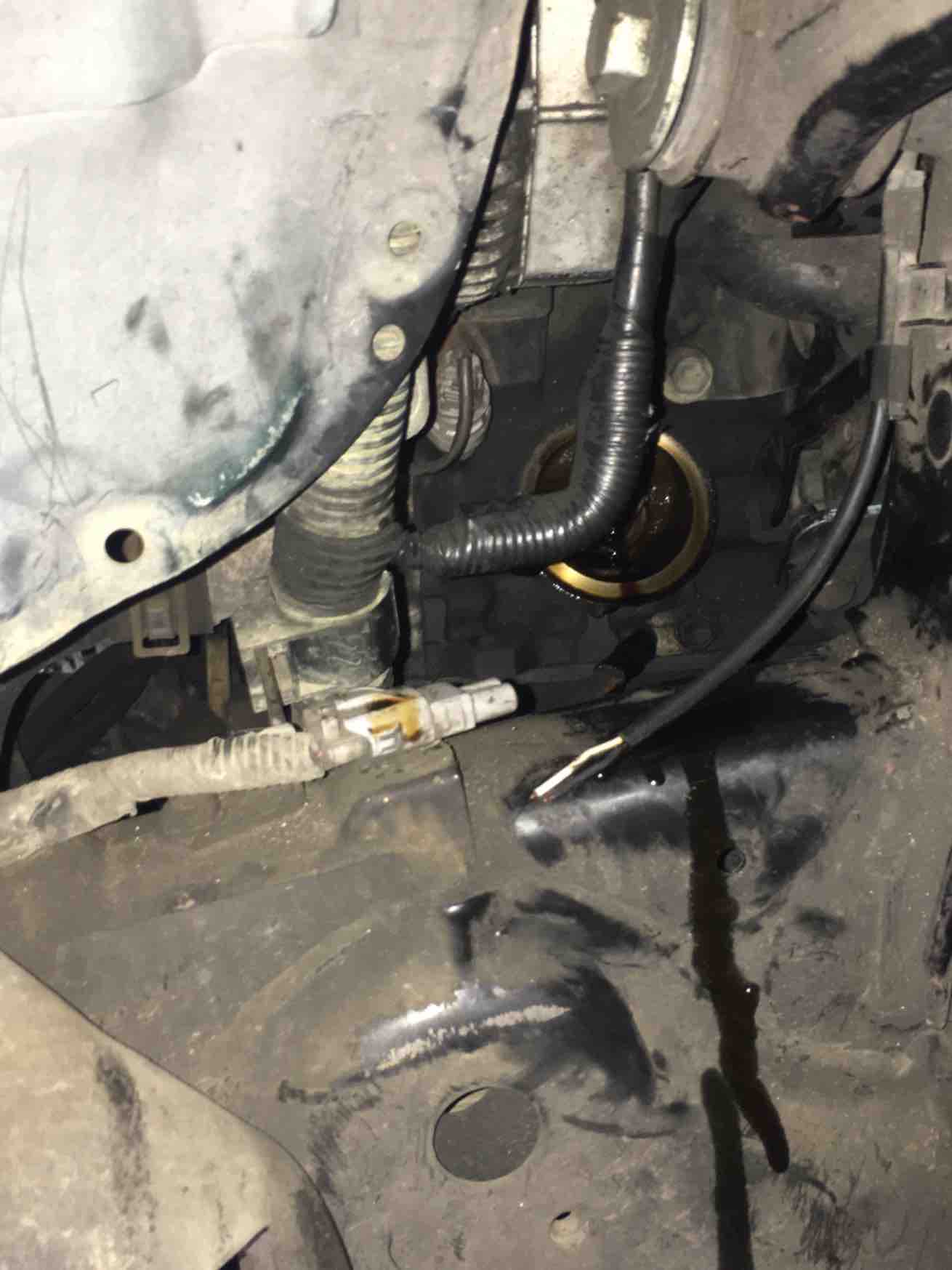

tjaguilar New member Jan 22, 2017 #1 Hello all, I was wondering if anyone could tell me what this wire is? I was pulling out my oil filter and noticed these wires were pulled out of its housing. Any help would be great!! Thanks! Sent from my iPhone using Tapatalk Attachments IMG_0236.JPG 81.5 KB · Views: 207

A alumarine Member Jan 22, 2017 #2 It doesn't really look like an automotive wire. Is it just a black and a white? You might follow it and see where it goes.

tjaguilar New member Jan 22, 2017 #3 alumarine said: It doesn't really look like an automotive wire. Is it just a black and a white? You might follow it and see where it goes. Click to expand... Yeah black and white. Followed it and it leads to behind the coolant reservoir to a bunch of other wires. Sent from my iPhone using Tapatalk

T technodrive New member Jan 22, 2017 #4 probably doesnt matter for this, but model details (often placed in the signature) could help diagnosis

ltsr New member Jan 22, 2017 #6 I think this is it: http://www.toyota-4runner.org/3rd-g...front-wheel-speed-sensor-test-replacment.html

TheDurk Elite Member Jan 23, 2017 #7 ltsr said: I think this is it: http://www.toyota-4runner.org/3rd-g...front-wheel-speed-sensor-test-replacment.html Click to expand... Yeah, those are black and white and thick insulation like the picture. You should probably have an ABS light on.

tjaguilar New member Jan 23, 2017 #8 TheDurk said: Yeah, those are black and white and thick insulation like the picture. You should probably have an ABS light on. Click to expand... Yup. I decided to snip the wires and use wire connectors to solve the issue. Wires are back together and lights are off. Sent from my iPhone using Tapatalk
