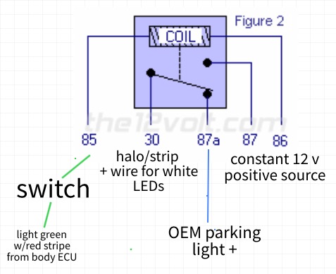

I'm assuming you disconnected the light green w/red strip wire to the flasher relay like in this writeup https://www.top4runners.com/ja/2007/drlmod.html and your 5-pin relay is the usual Bosch/TYC SPDT
87 and 86 share the same power source, although I put down constant 12v you can use your ignition ON source.
Switch is just a simple SPST type, no need for a SPDT like in JA's writeup

I'm assuming you disconnected the light green w/red strip wire to the flasher relay like in this writeup Toyota 4Runner DRL Mod and your 5-pin relay is the usual Bosch/TYC SPDT
This is very similar to what I was attempting to do last week, but the issue I was running into was the DRL wire (light green/red stripe) wasn't energizing the coil sufficiently to close the circuit. I was using a cheapo from the parts store, so I'll order a high-quality Denso or Bosch 5 pin relay and try this setup.
If you have PN recommendations for the relay, let me know.
Thanks again!
EDIT: AH HA! I see what I was doing wrong. I was using the DRL wire to energize the coil, instead, I need to use the Body ECU as Ground! This should be easily accomplished. Thank you!
Another clarification, the Parking light + should be the green w/red stripe from the DRL/Flasher relay, correct?
Thanks again!
Don't have any specific part numbers, maybe just look for Bosch, Tyco or Hella branded ones.
Yeah I forgot to ask if you knew the DRL wire was a ground LOL
The parking light + wiring doesn't come from the flasher relay, you'd basically tap into the existing parking light wiring. According to my '03 diagrams they're the green wires at each parking light socket (remaining white w/black stripe wire is ground), powered from the 10A TAIL fuse.
