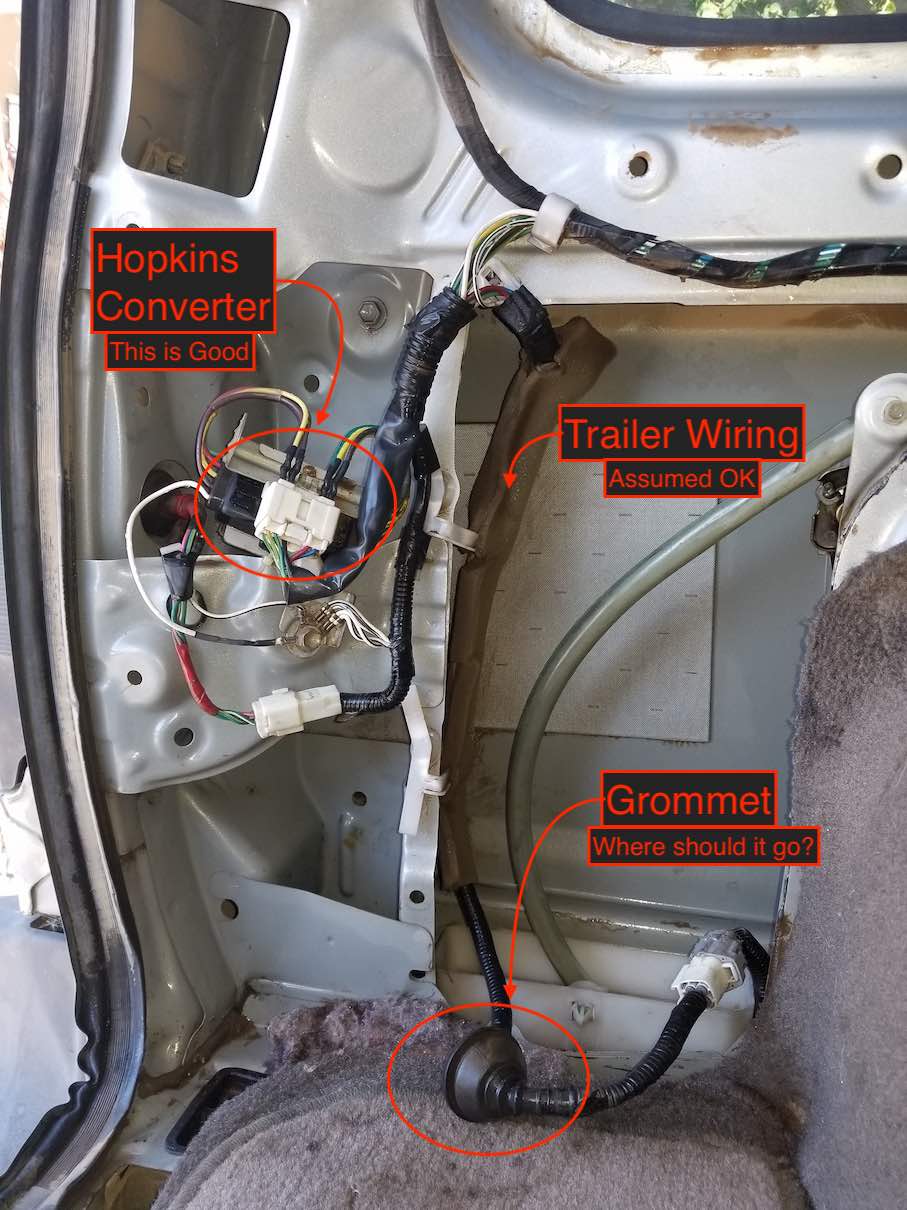

Proper wiring inside rear panel
I recently pulled the rear interior panel on my 2001. The wiring harness routing looks funky to me.
I know the trailer connector box was replaced with a Hopkins unit, no worries about that. But, the trailer wiring exiting in front of the vent/drain box, and the extraneous unseated grommet seem not-right.
It had rear damage looong ago, and the repair quality was sub-par. Does anyone have a photo of how this area should be?
Not normal the wiring mostly runs those black squares and out the rear bumper mount bracket. I can't say I seen one go out the rear vent before.
