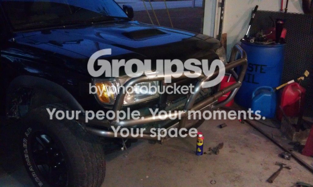

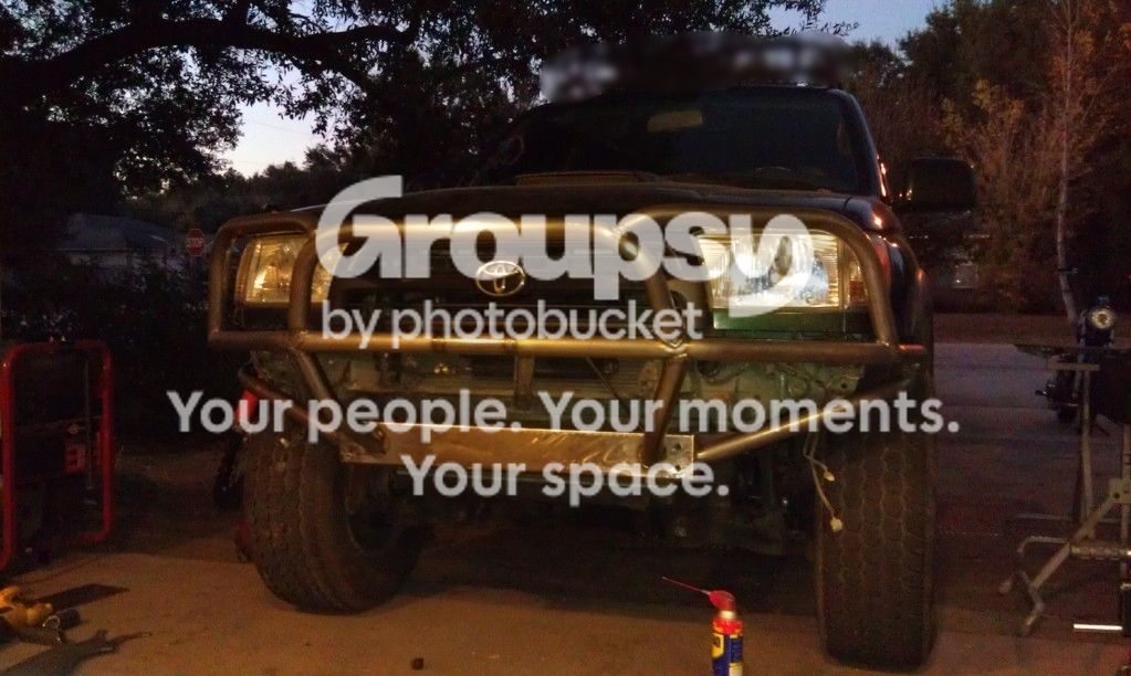

few more pictures, welded up what was there to be welded and slapped it back on. tomorrow i'll work out the winch plate and some gussets to make this thing super stout. also welded some peanut shaped plates on the ends that tie both tubes together, and close them up. hard to see in the pictures though.

That's sick! The center stinger matched with those light hoops is badass! I can see a Rigid light bar fitting on top of the center section perfectly. Your getting yourself into all kinds of trouble with these builds. First roof racks now bumpers. Your gonna be the next Shrockworks.
I love how this is turning out! I would love to see a plate version of this as well! Either way, the stinger with the headlight hoops look great!
My god. Those bends are super attractive. I already knew the lines of the headlight and grill hoops were great before, and now with these new pictures from the front. :jaw drop: such sexiness!! Im really liking the bend on the two bottom support tubes. It keeps drawing my eyes......

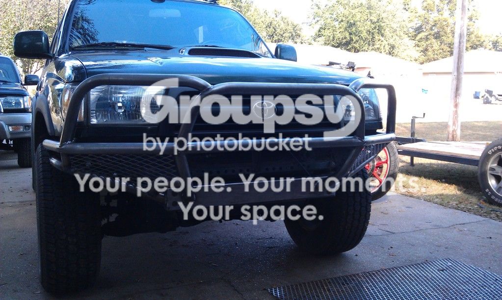

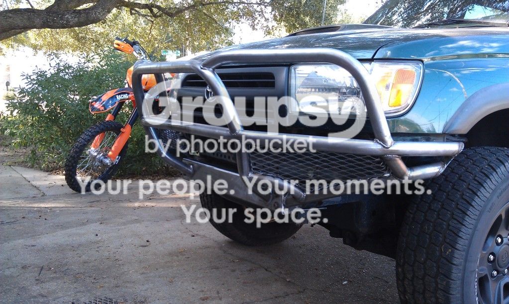

more progress: i added some connectors from the base of the center supports out to the bottom tubes as well as small section tying the ends together. also, im sure you see my solution to hiding the "ugly" that most just cover with black paint. once the whole bumper is black i think the expanded metal will do a great job of hiding. i also plan to put some simple LED signals behind the mesh. off to work rockin the bare steel!!

Still undecided there. I won't have a winch for a while but I think I'd like to have a solid piece there for a fairlead later on. I'm not sure if that would be too much expanded metal?
Looking really good Whitson! I like the mesh, helps to cover up the "ugly" behind it, as you said...
Nice KTM too!
Anyone have thoughts or opinions on using aluminum diamond plate for the center section? Bright finish or black?
Black, for sure. I like that idea, the diamond plate will match the diamond mesh you already have on there.
