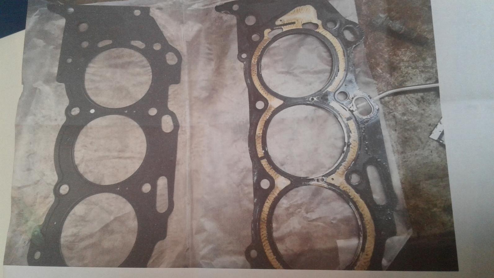

Look at the drivers side door jamb, there is a tag that has the build date on it.
If your build date is 11/05 or later you have the newer style gasket and have nothing to worry about unless the truck is showing symptoms.
I attached a picture of the old vs new style gasket, you can see its a different design.
Personally from reading all these threads over the years I get the impression early HG failure is mostly due to owners not using Toyota approved SLLC or disregarding the service interval for coolant flushes.
Thanks for the info. It says 1/06, so I guess it’s right past the cutoff. Besides a minor oil leak (thinking timing cover,) it’s a great running truck. No signs of bubbles from the radiator or brown snot under the oil cap. I’m praying to get another 100k out of it at least. Do you know a way to check if the coolant is good? It’s red and clear.
Don’t stress too much about it. Drive and enjoy your truck. I don’t believe there is a test to determine how old coolant is. At least I don’t know of one. If you’re worried about it, just go ahead and change it. The job is easy and it’s very inexpensive to do so.
