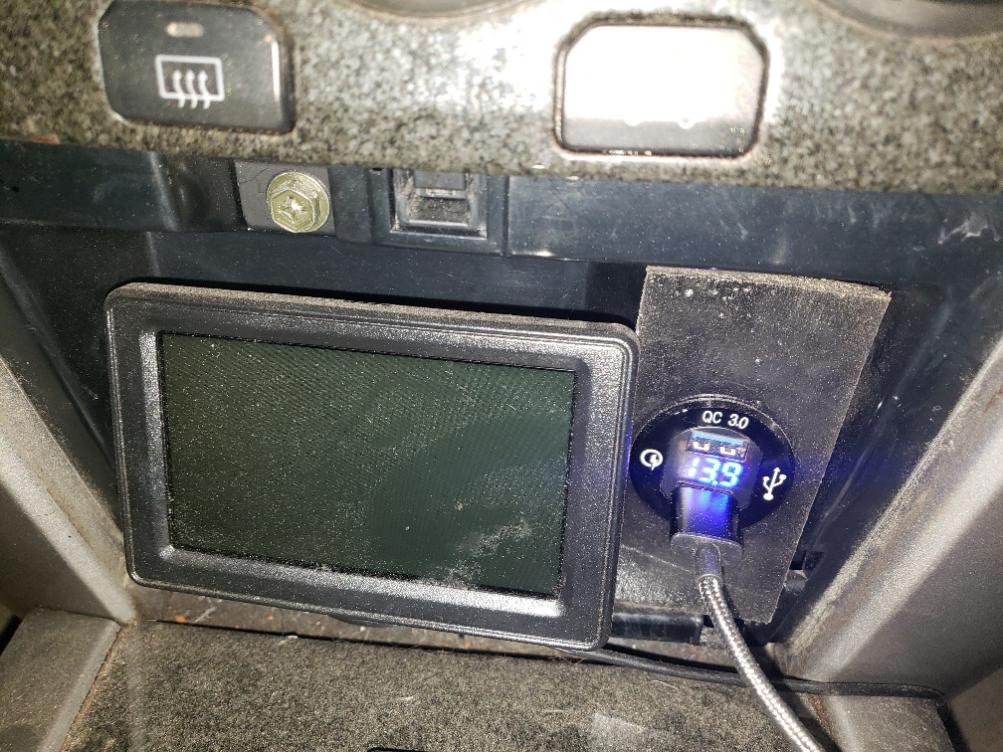

I added a dual USB port connector that also happens to have a voltage gauge. Very nice to see what's going on with the charging system.
Got pics of that?
Sure. I removed the lower useless door on the center dash to ft my backup camera. I had extra space so glued a piece of plastic in place for one of these to fit in. Not great looking but super useful. Please ignore the dust. :D
