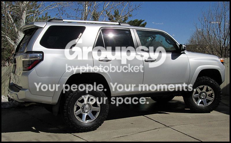

Finally got around to upgrading the shoes. The factory ones just did not cut it, especially here in the Colorado snows. Since I didn't have a lift yet, and the fact that I don't want to deal with rubbing even post-lift, especially if stuffed and turning the wheel on trail, I went with the 275 KO2s, E-Rated so I don't have to worry on the rocky trails here.
They really make the 4Runner look better. Seriously, this must be done with any 4Runner to make it better.
Pro Tip: Get them road-force balanced rather than the typical spin balancing. Discount Tire did it for free, it just takes a little bit longer. No vibrations at high speed.
Spare fits too!

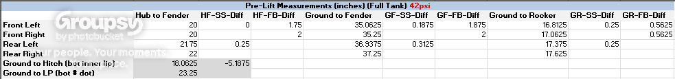

Before and After Measurements:
HF: Hub-to-Fender
GF: Ground-to-Fender
GR: Ground-to-Rocker
SS: Side-to-Side
FB: Front-to-Back
Also took some arbitrary hitch and front license plate measurements for changes only.
Pretty standard before measurements. You can see the standard 2" rake and the 1/4" lean on a full tank from HF. The GF measurements are off more, probably due to measuring and tire variables.
